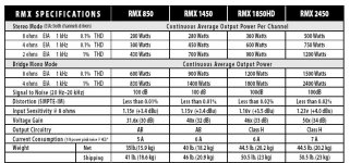

I've attached some RMX specs.The RMX2450 uses 4 pairs per channel,as you asked.
Regards friend.:)

Hi.
These are factory specs.I didn't made them up.We all know that these values are for marketing reasons!
Of course it's not recommended working on 4 0hms in bridge mode!Probably they measured this in a short term.But...as you see,amp can deliver 2600W at 8Ohms bridged.I think this is quite enough:nod:
After all,I'm finishing the PCB soon and I will perform some hardcore testings.
Regards.:)
