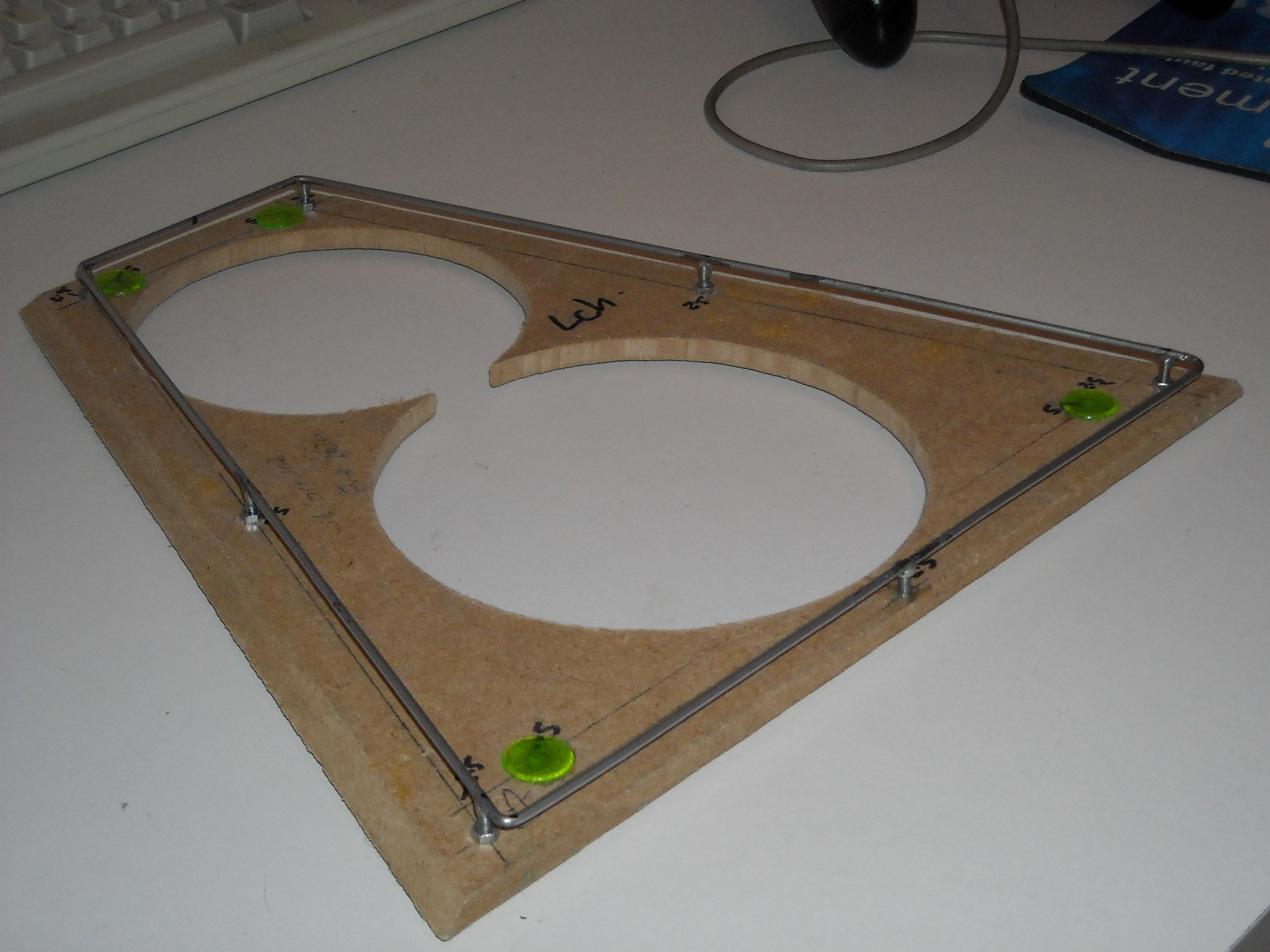

Looking for ideas for a frame for grill cloth that is not too terrible in refraction. Old school frames were terrible, which led us to the generations of exposed drivers. My next build I need to protect them. At least the woofer as it will be next to a passage and right at elbow level. Being the woofer. A bit of welded wire hardware cloth may be OK. Ideas?
why not a frame made of a 4 thin solid rods with just 4 very little angles made from cork or solid foam in which the rods are glued or screwed. When the frame is ready just put acoustic grill cloth around the rods then sewn around the metal rod. If the rod is a little thicker then you can use wood... easier for the grill cloth with staples on the rear side of the rod.

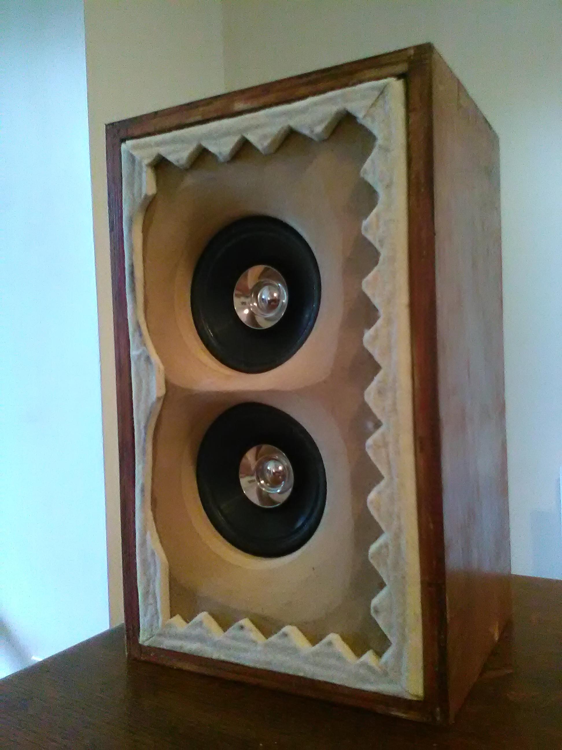

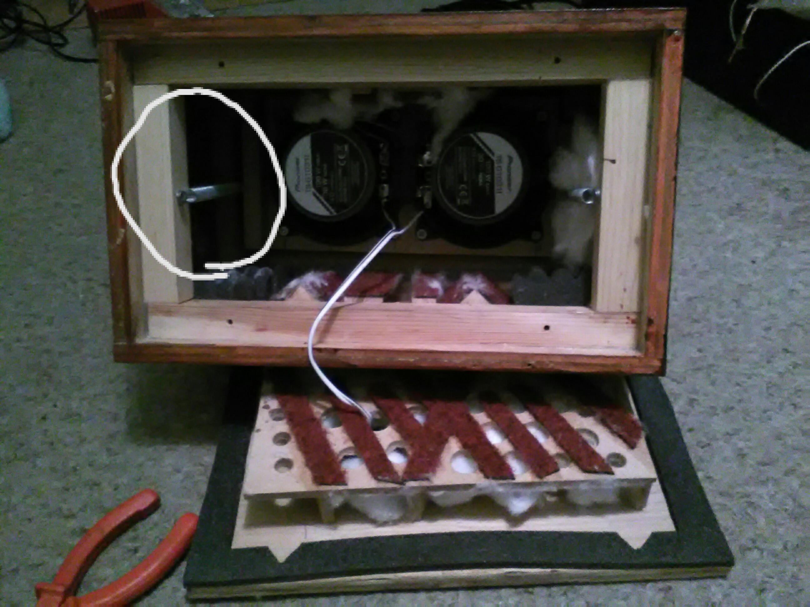

Here's a mad idea, stick 1/4 inch thick felt to the baffle as a stand off, then wrap in grill cloth, glue around the back of the front baffle, and attach the front baffle to the rest of the cabinet with tension springs ( against a soft vibration absorbing gasket ).

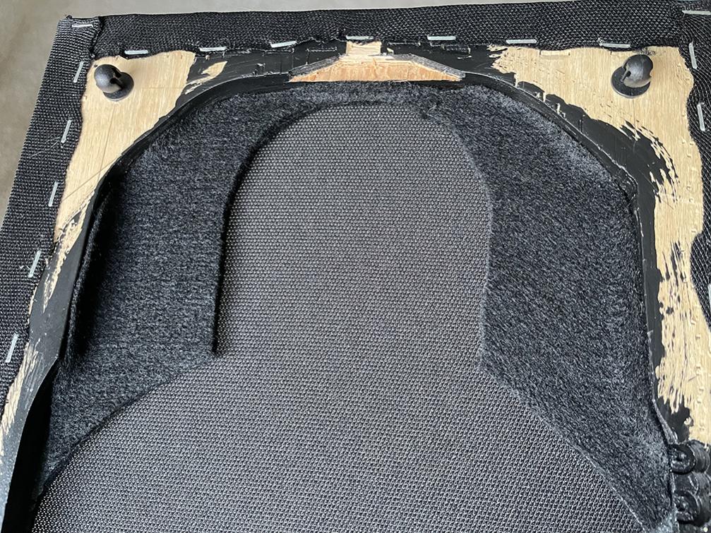

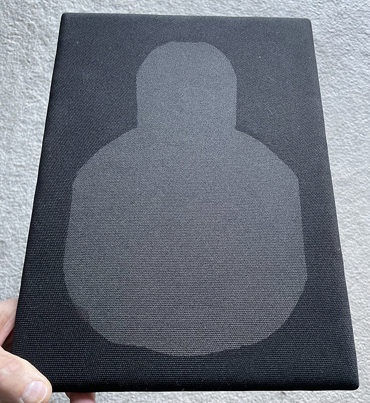

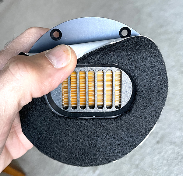

I have done exactly as you show, except instead of using 1/4" felt I used 1/8" adhesive-backed material to cover the outside of the frame. Mine is black and when covered with grille fabric it is invisible. I have also used it two-sided (adhesive-to-adhesive) to extend over the baffle to the edges of the drivers as a way to minimize baffle step. It definitely helps manage those annoying higher-frequency diffraction effects, especially around the tweeter. I wish I had made before/after measurements, but everybody's "mileage will vary" anyway...
This is the material I have used: Dampers: FELT 1/8" thick x 32" wide, by running foot
This stuff is my secret weapon for bad baffle design! 🙂 The adhesive is strong, so for testing I suggest just exposing small areas of adhesive to help with removal and adjustment.
BTW, I love that scalloped inside edge of your grille frame!
Frank

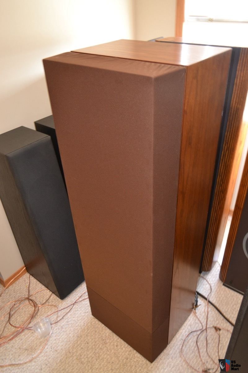

About 30 years ago I had a pair of Acoustic Research bookshelfs that had recessed drivers. There was a small groove 15mm back from the baffle on the top, bottom and sides. The grill had a bit of elastic sewn into it that fitted into the groove to hold on.
I've kept that idea for when I make my next speakers that need grills. Rather than recessing the drivers I would use thick felt and try and get a decent radius on the edges. Maybe use a 1/4 round moulding with the felt pushed up flush to it.
I can't find a pic of the speakers I had, but this pic is visually close.
Rob.

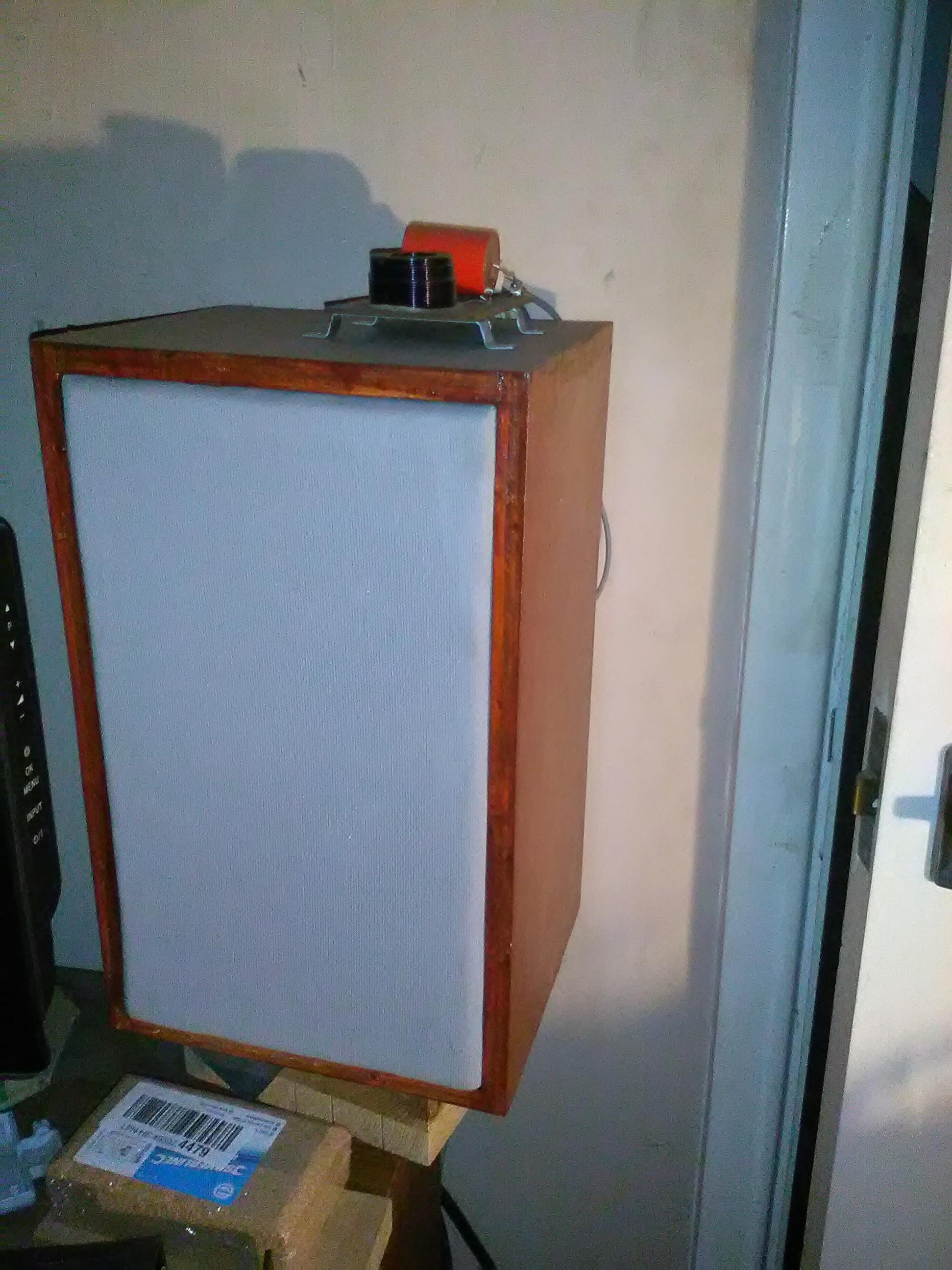

Here is a picture of the speaker with the ( grey ) grill cloth on, the white felt is invisible, I'm not sure this would be true for all grill clothes. The contour network is on the top, I haven't got round to sticking them inside yet. The felt was cut with a bevel.
This is the speaker with the back removed, I have put a circle around one of ( the two ) tension springs that hold the front baffle on.
