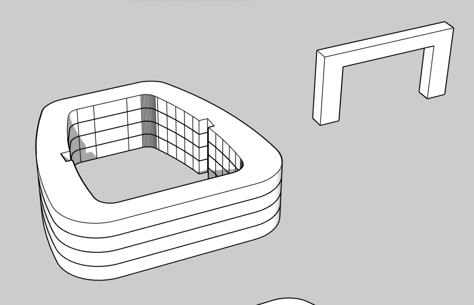

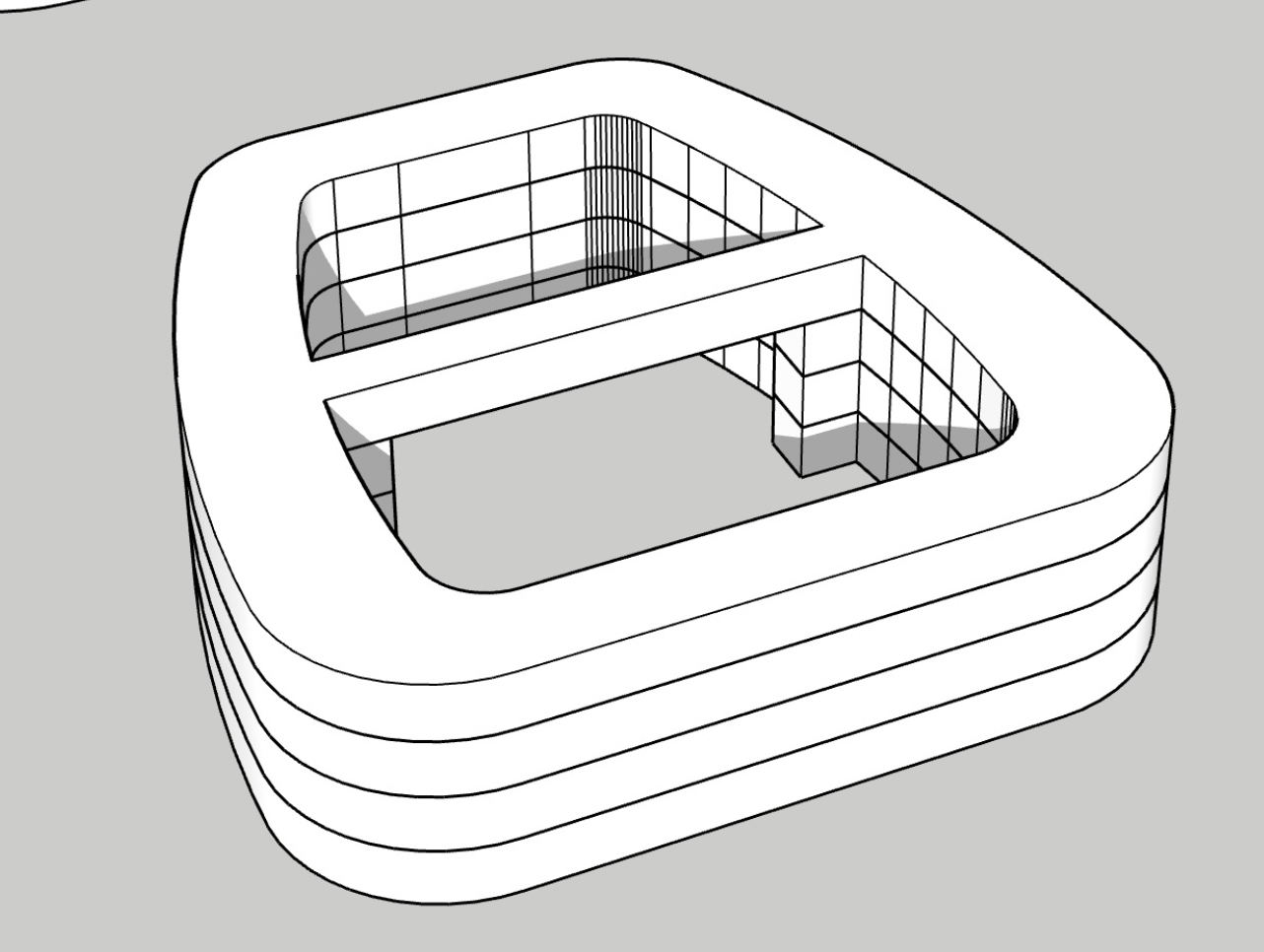

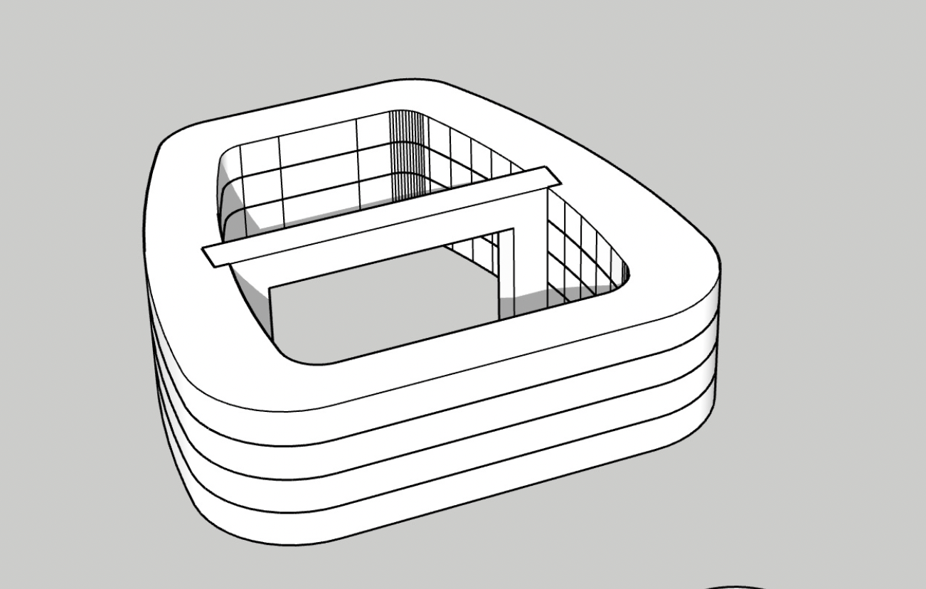

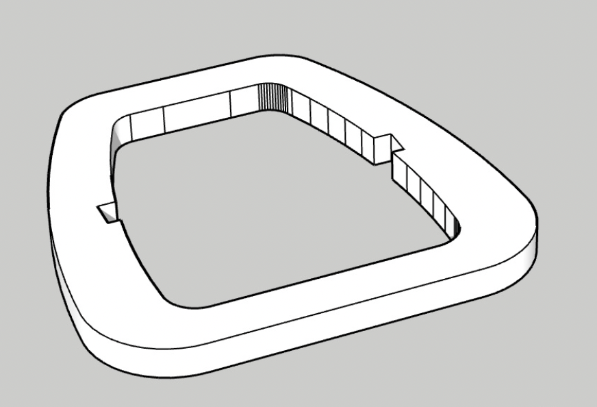

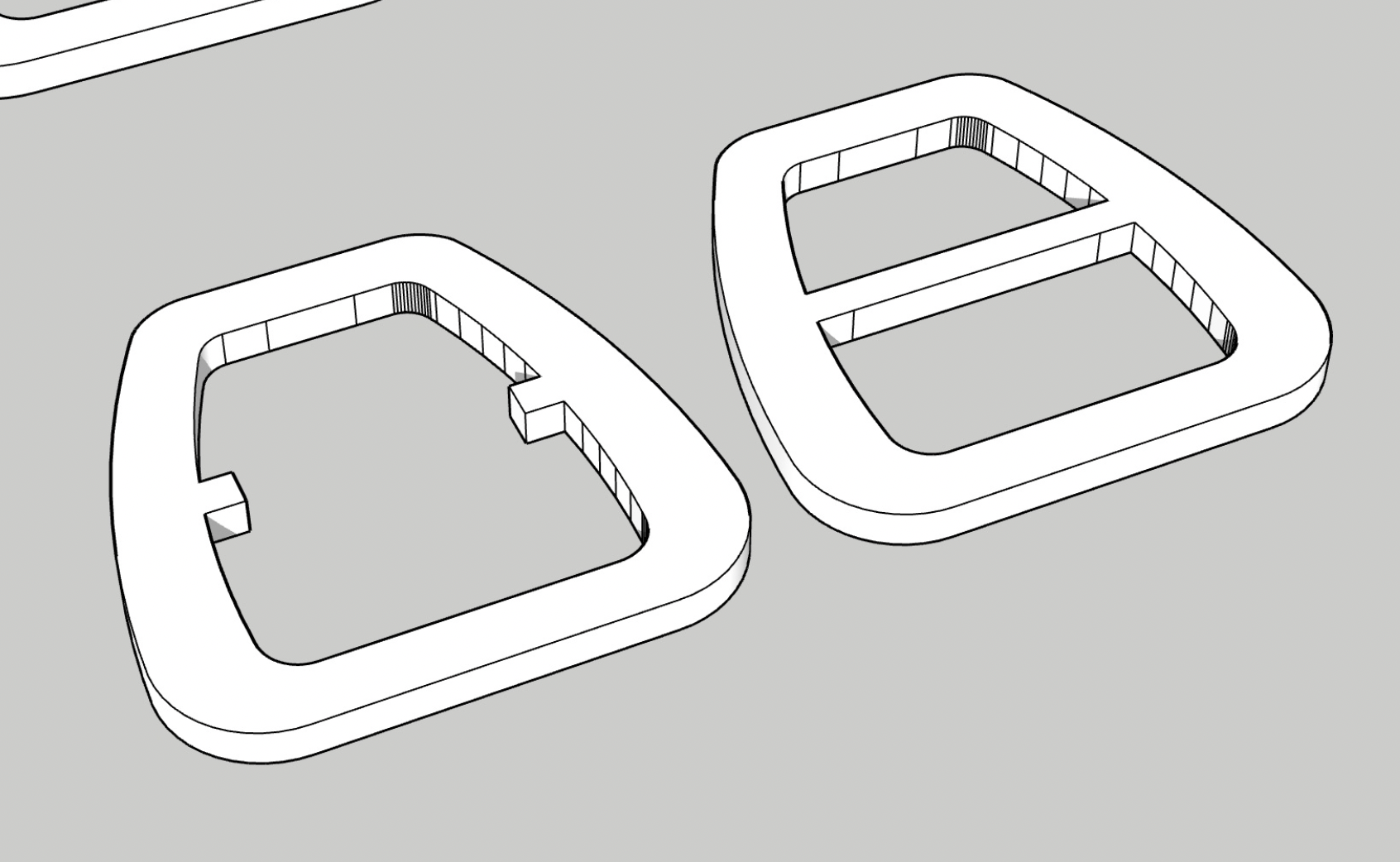

Conceptualise it as a solid, then separate into layers.
I was under the impression that, in this simplified example, doing this...
...is worse than this.
...thats at least what I got from this.
Because it is translam the only part you are bracing is that piece. All the pieces need to feel the brace. So it/they need to be vertical
Did I misunderstand you @planet10 or don't you agree @shaan.
The first methodonlyreally braces tha one piece, the secondacts totie them alltogether. Second should work better.
