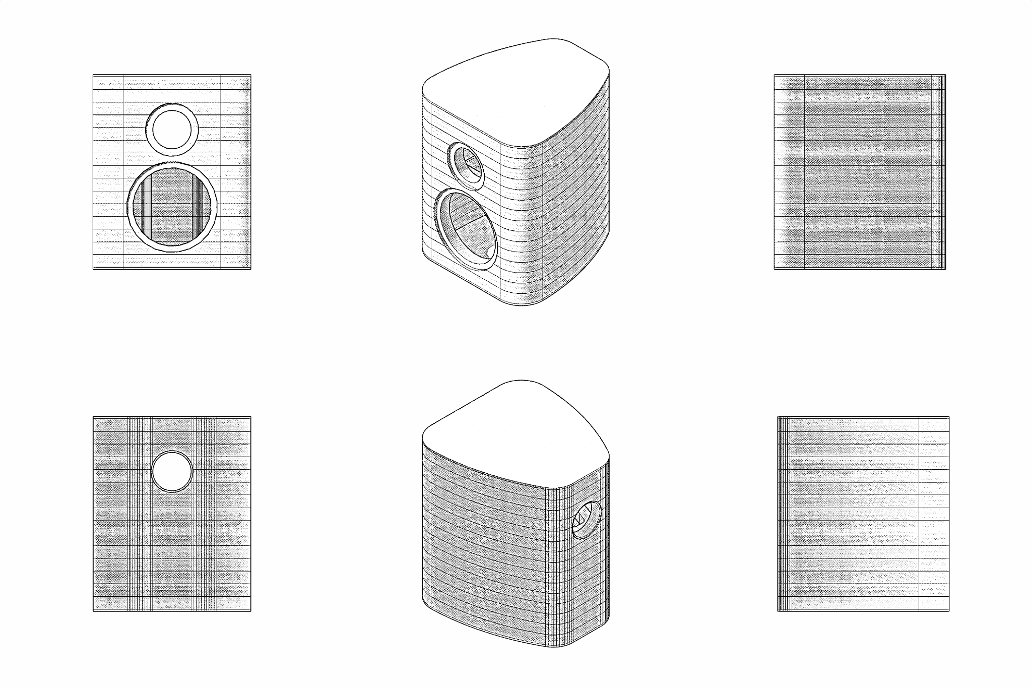

I've built a couple of kits before, but I've just started designing and building a speaker from scratch. I’m cheating a bit though. Ganesha, my speaker, will use the same drivers and have roughly the same volume as the open-source SB Acoustics Bromo kit. So, it wouldn’t surprise me if I end up with similar port dimensions and a comparable crossover.
I've just glued up the cabinet and started to learn how to measure drivers... and I'm a bit lost so thats why I'm here. 🙂

If that is what you want.
Note that when you use BB in this direction it is not nearly as stiff/strong (ie you are using it inthe wrong dimension) so instead of 18mm walls you will probably need 35mm. Factor that in. It will also need bracing which should be 90° to the plies.
The shape/roundover at the front should be much larger if you want it to really be useful and not just pretty.
dave
Both drivers are not physically phase flat in this arrangement, so the cabinet has to be tilted backwards a bit, overshooting the audience.
A slightly recessed top driver will suffice, if the smart crafted design allows.
These things mingle into the overall phase response, which will become even more troublesome with second order (and plus) crossover filters.
A frequency fissure ("Thou shall not pass!") might occur.

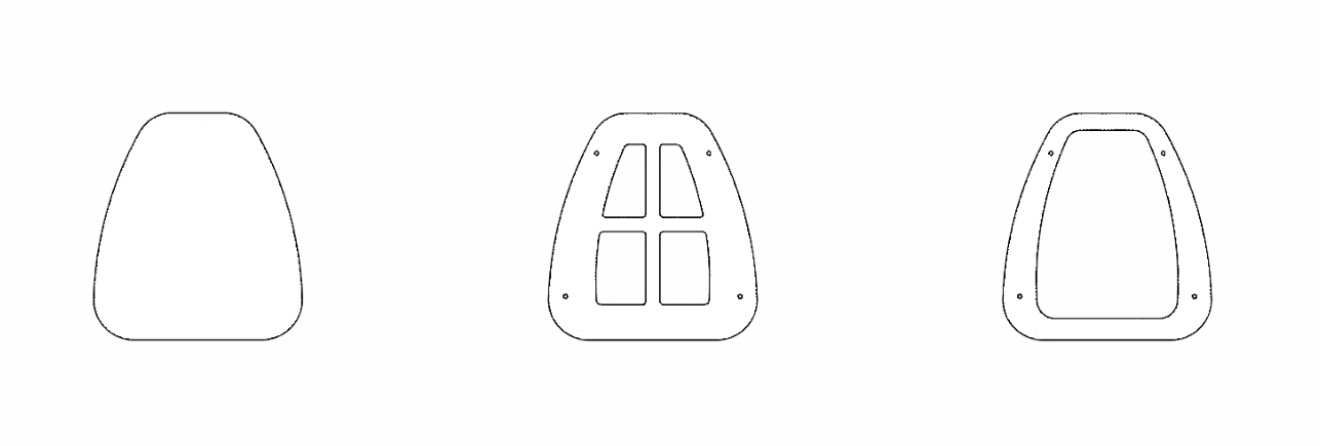

I don’t have 35. The baffle is 30 and the smallest portion is 24. Probably not enough? I’ve got a bracing layer between the drivers. What do you think about that?
What would you say an appropriate radius would be? The current radius is 55mm.
How much recess are we talking about approximately? Either way tilting it is likely easier to get right.
What is it with this configuration that doesn’t make it phase flat? Most cabinets do not have recessed tweeters or are tilted -right? Most cabinets are bad?
A plywood brace should be larger than a regular brace because plywood loses the strength of every second layer when cut in intricate ways. It is substantial as a larger board.
This is apart from what Dave is saying about where to brace.
Reactions: u840903

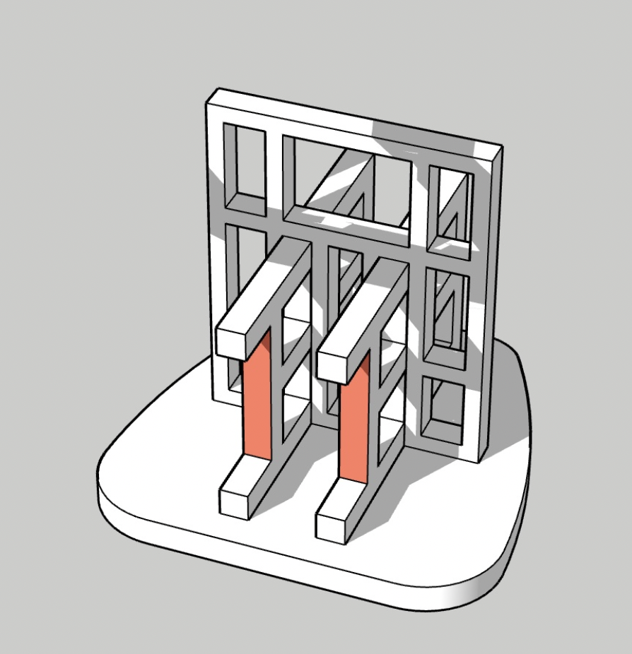

While cross-bracing is a proven way to ameliorate wall vibration, with your translam design you also have the freedom to select wall thickness, which is another way to do it. With thicker walls you will need less cross-bracing to achieve the same result. You can use a combination of the two.
Also note that you can incorporate your bracing into the layers without making them separate parts as you show in your last pic. Kind of like a macro version of 3D printing. Conceptualise it as a solid, then separate into layers.
