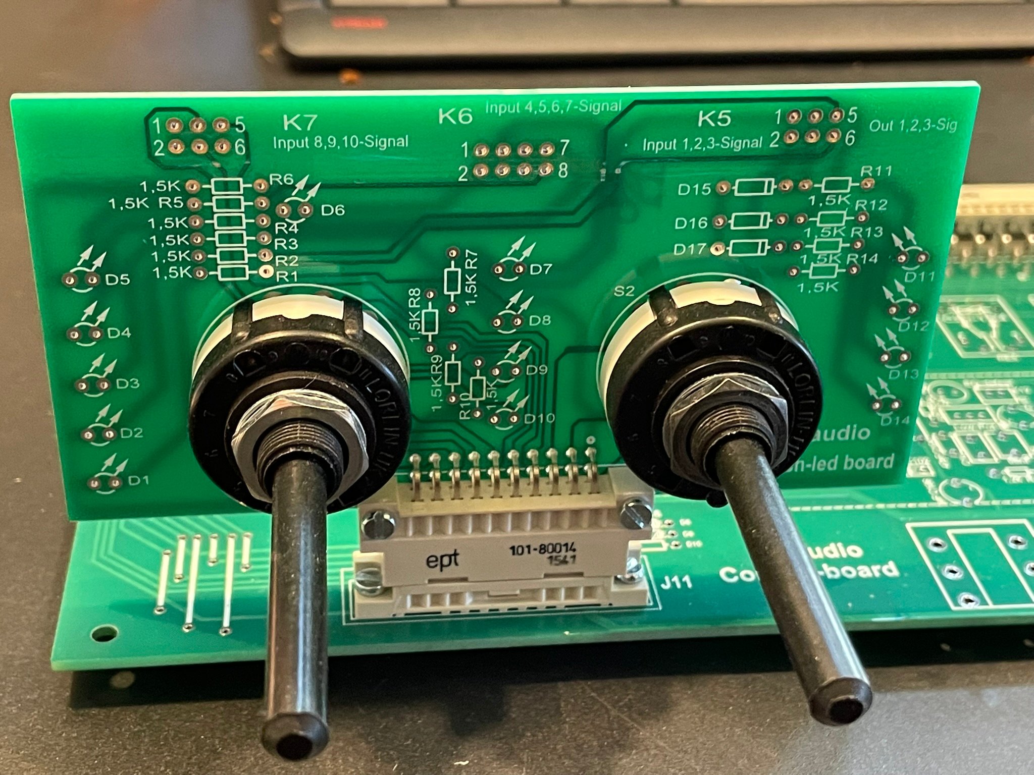

yes, you are right......in the pcb layout I took some attention on the commons layout that there are no circles. In general I see separate supply and commons for audio supply (+-18V) and control logic circuits (+24V).
Generally the audio signals from the in/out stages were switched with a relay crossbar with relays from old studio-equipment (Ampenol C2H-24).
The front panel will have an input selector rotary switch with leds for the switch positions, cause the inputs can change depending of the different boards in the 10 slots. The green leds show that there is a board in the slot no. x and this dual red/green led shows channel overload with red. The same for the output rotary switch.

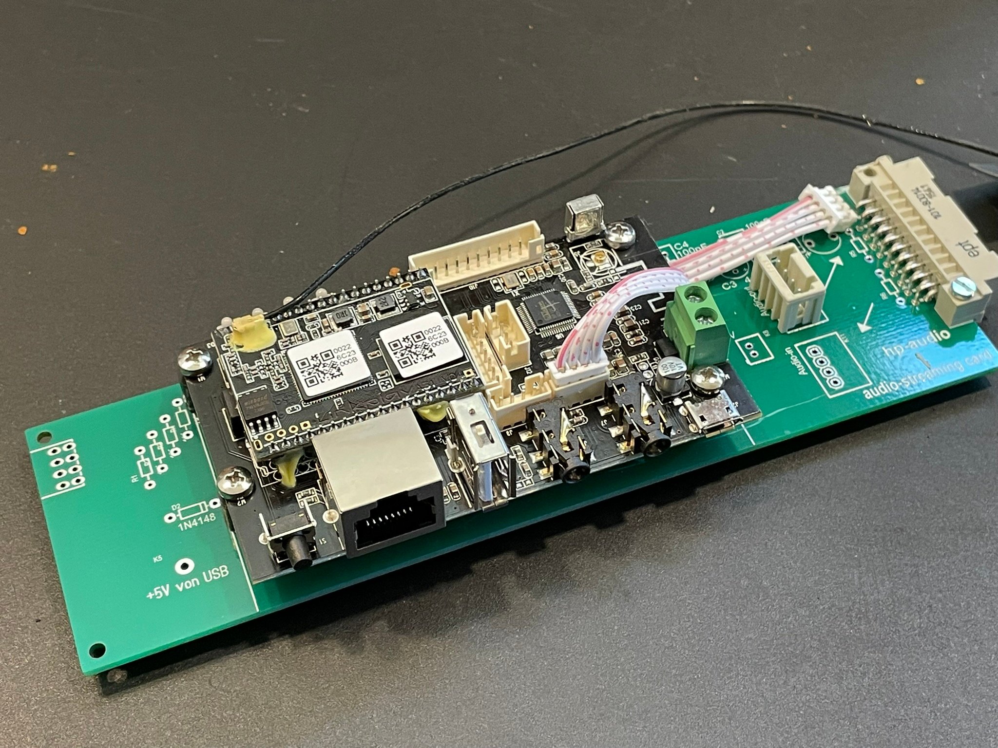

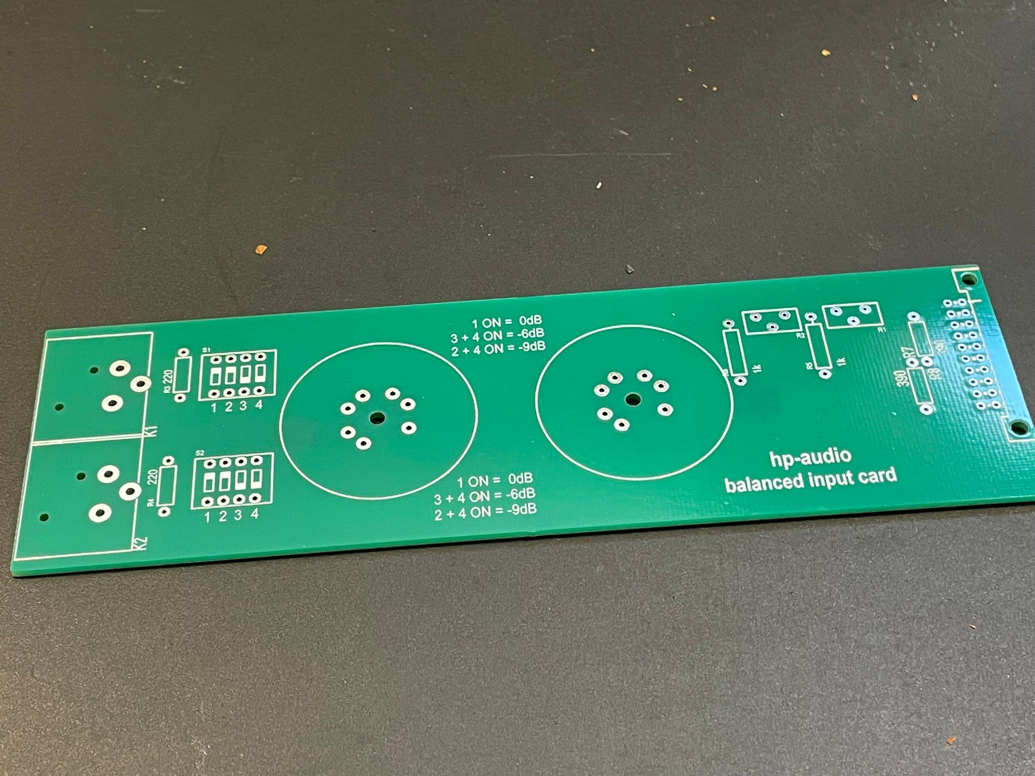

  • line in sym with transformers (XLR)
  • streaming board with Wifi and network

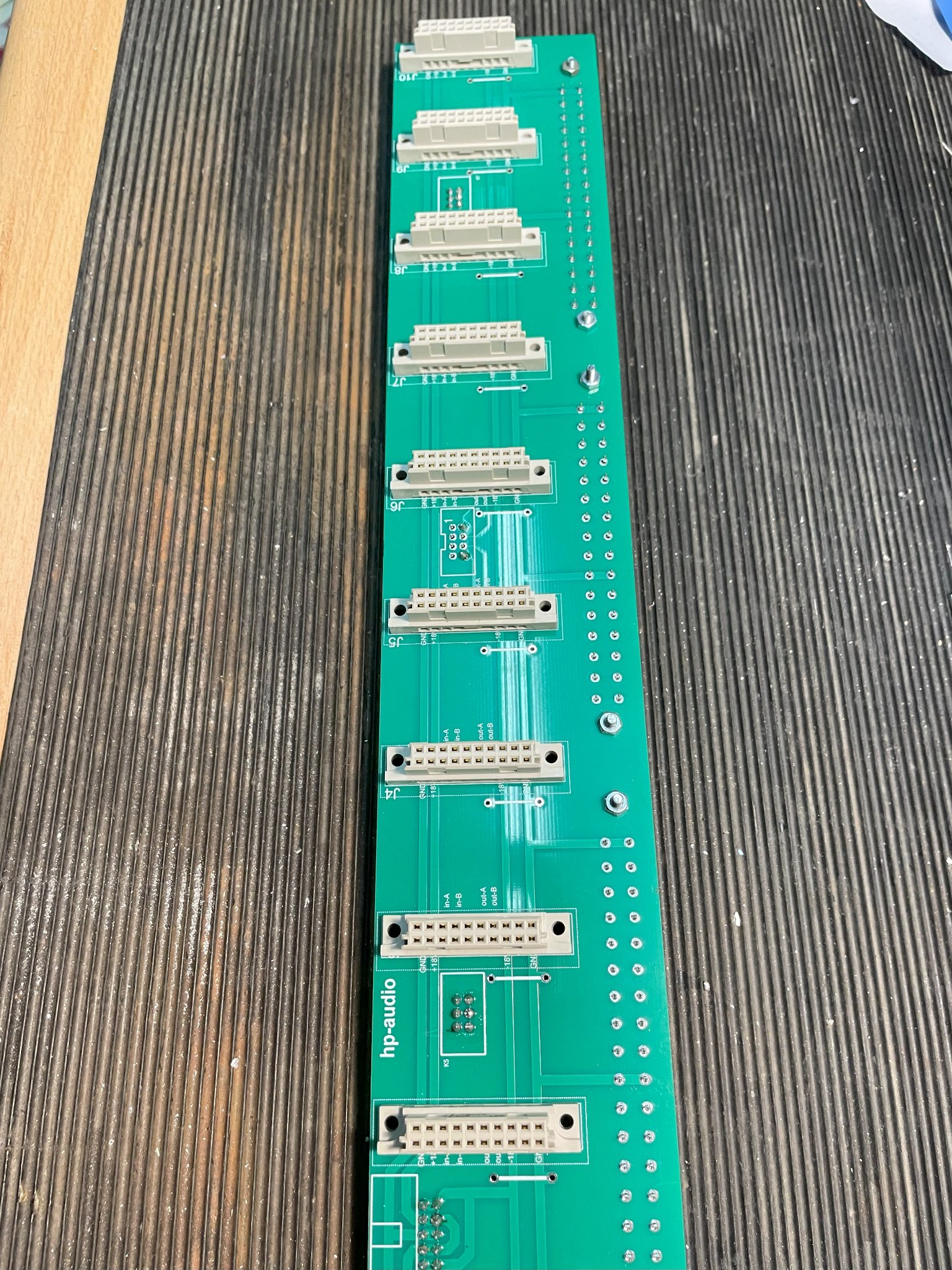

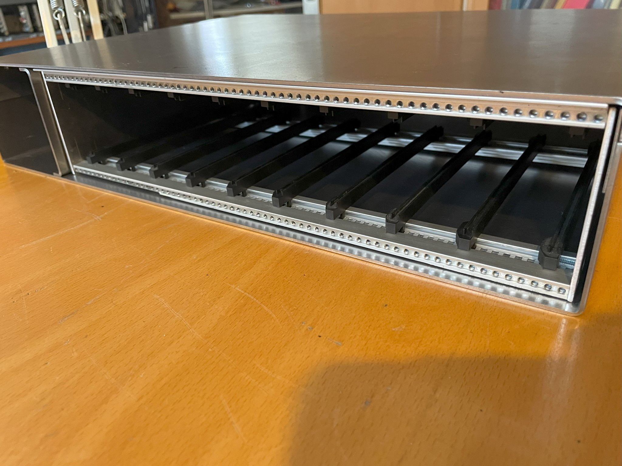

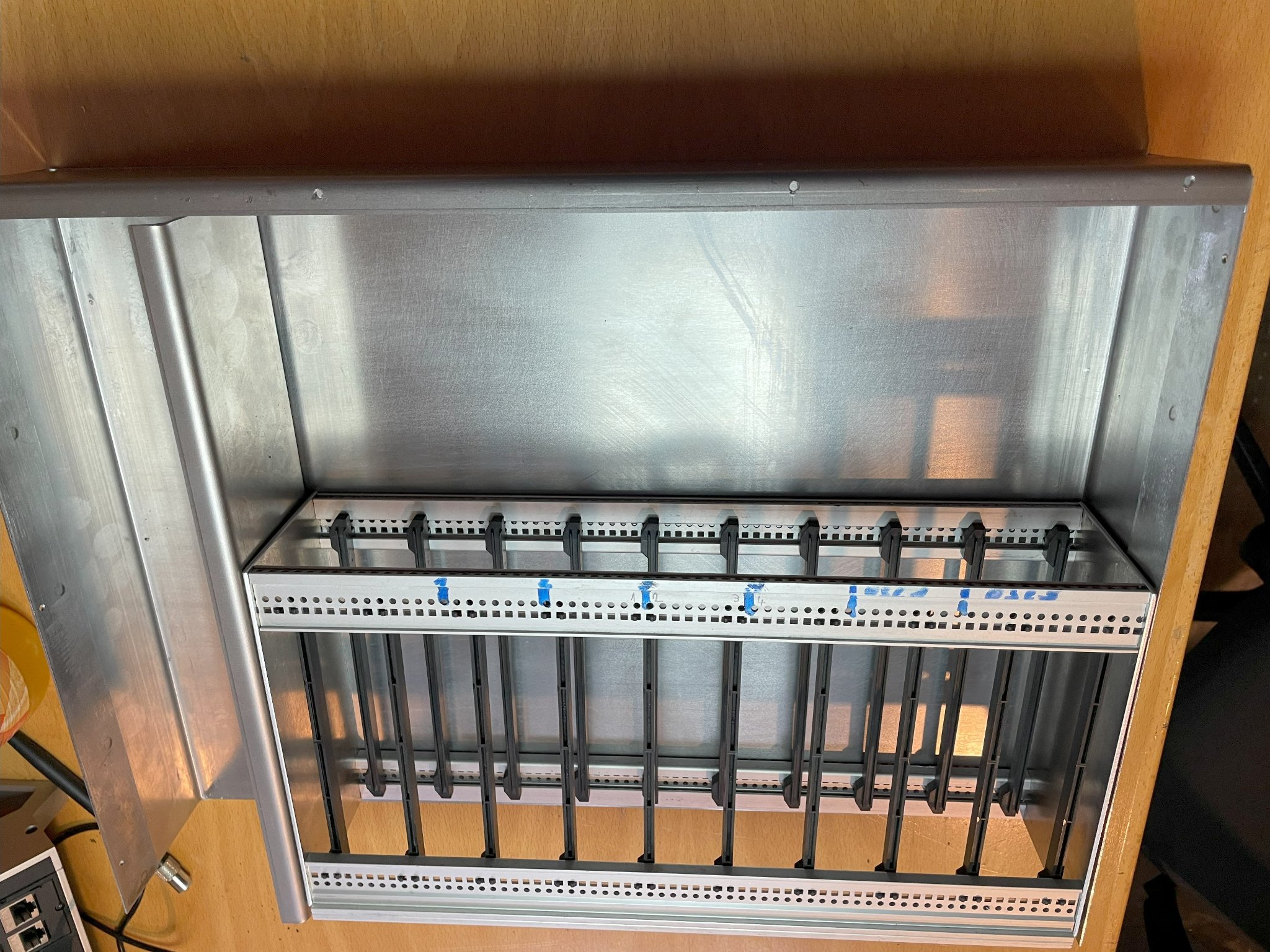

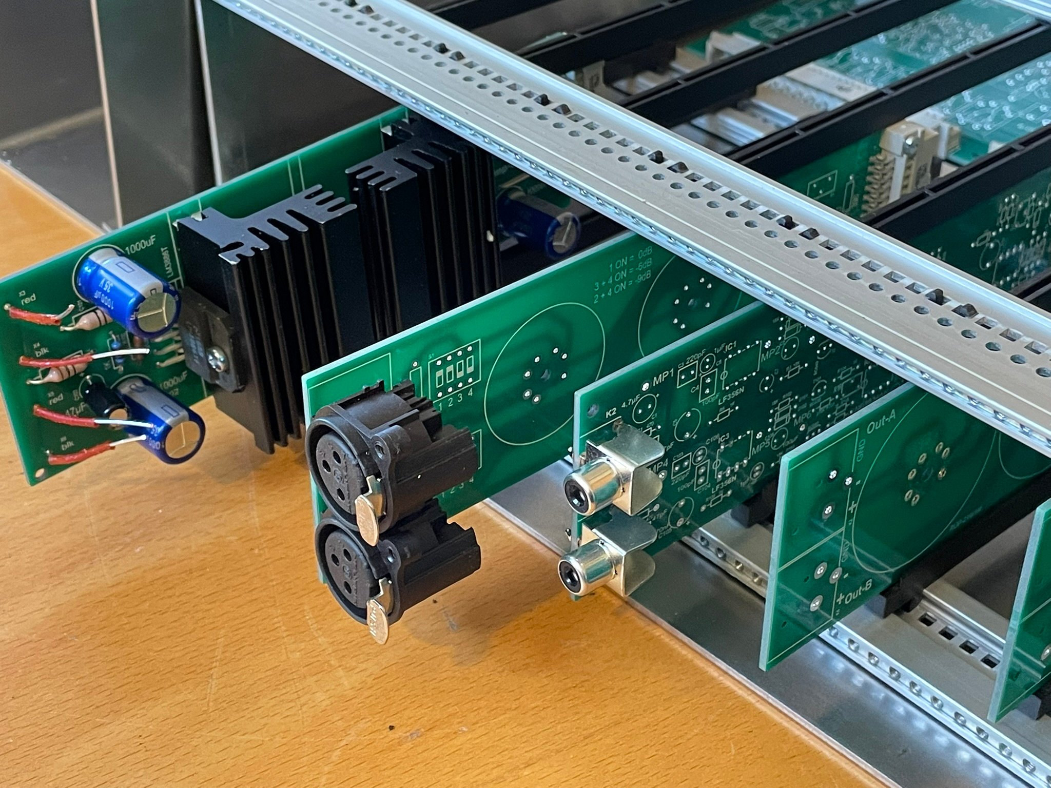

Hi All,
the project is on a good way.
now some work with the enclosure (the 1st pic show the backside with the pcb slots)
and the other pic the connection bus pcb from both sides.
regards
HP

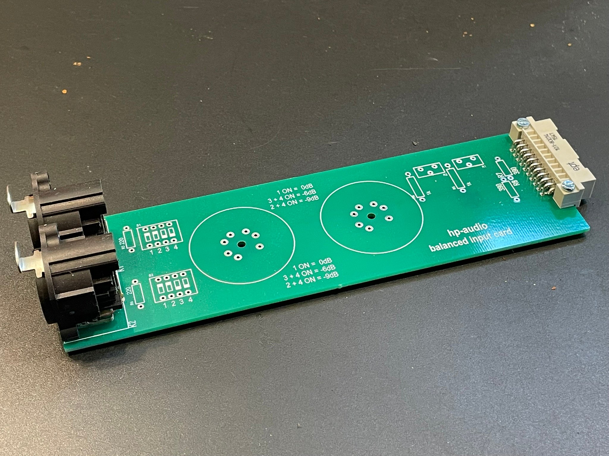

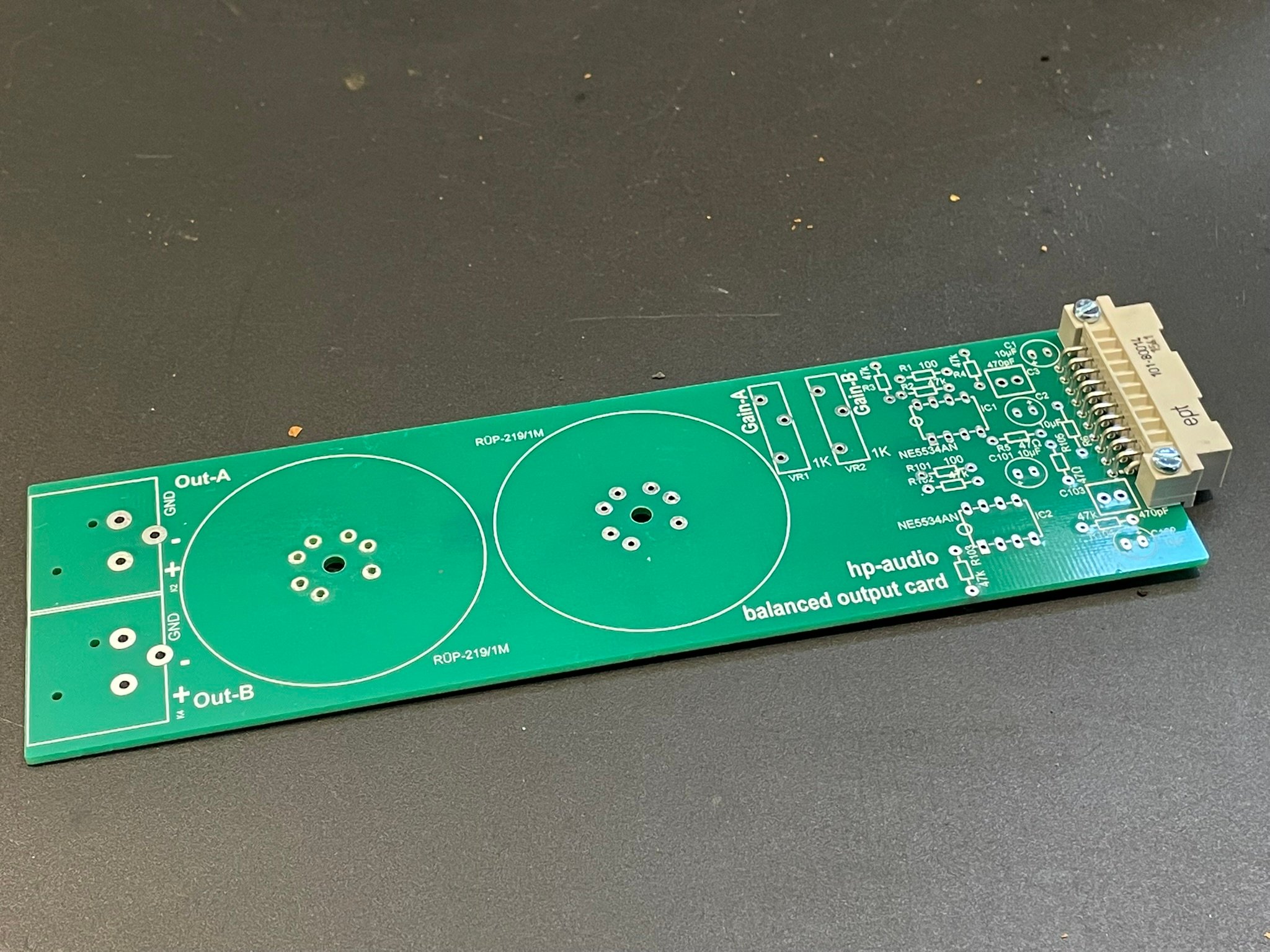

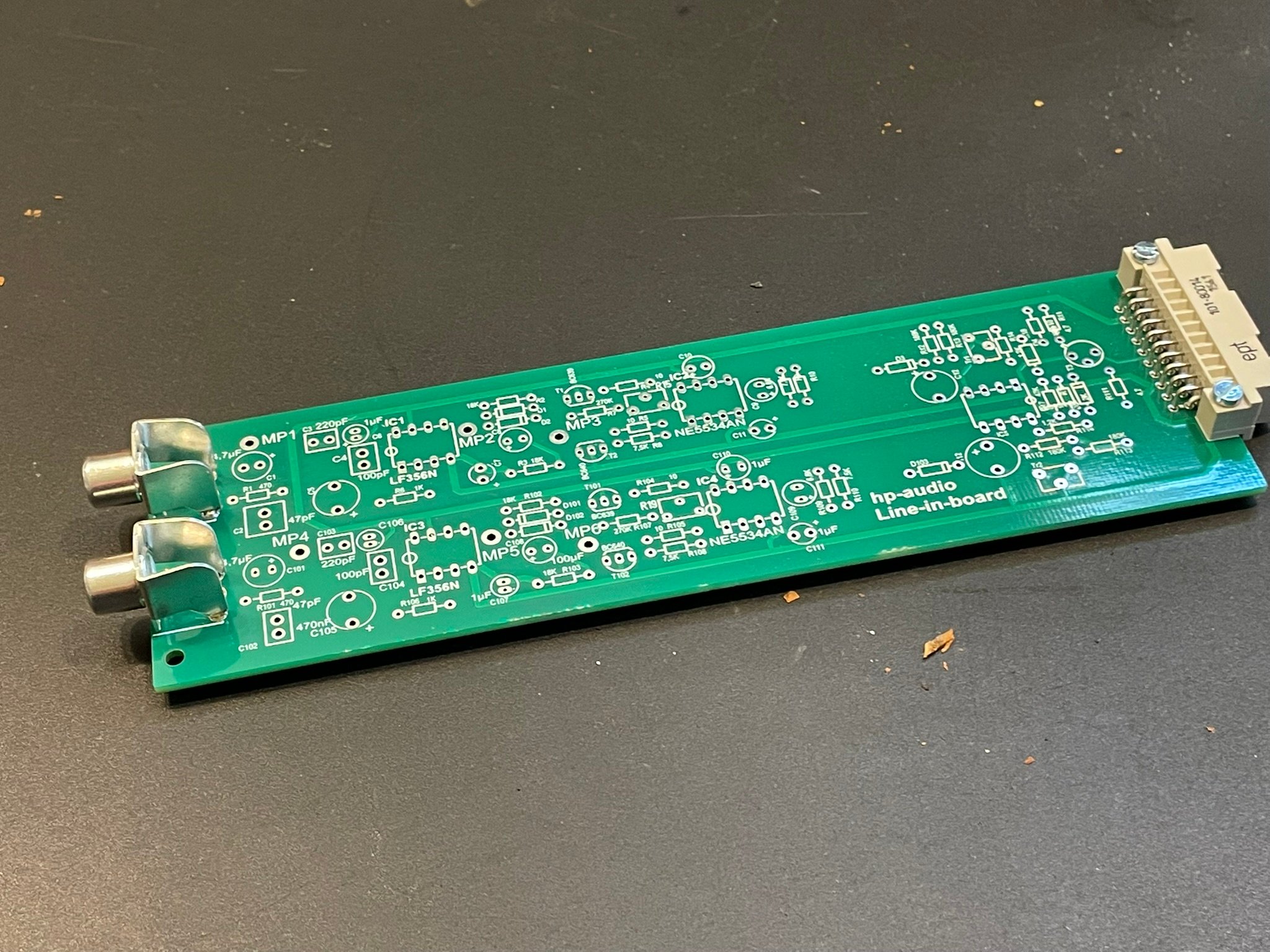

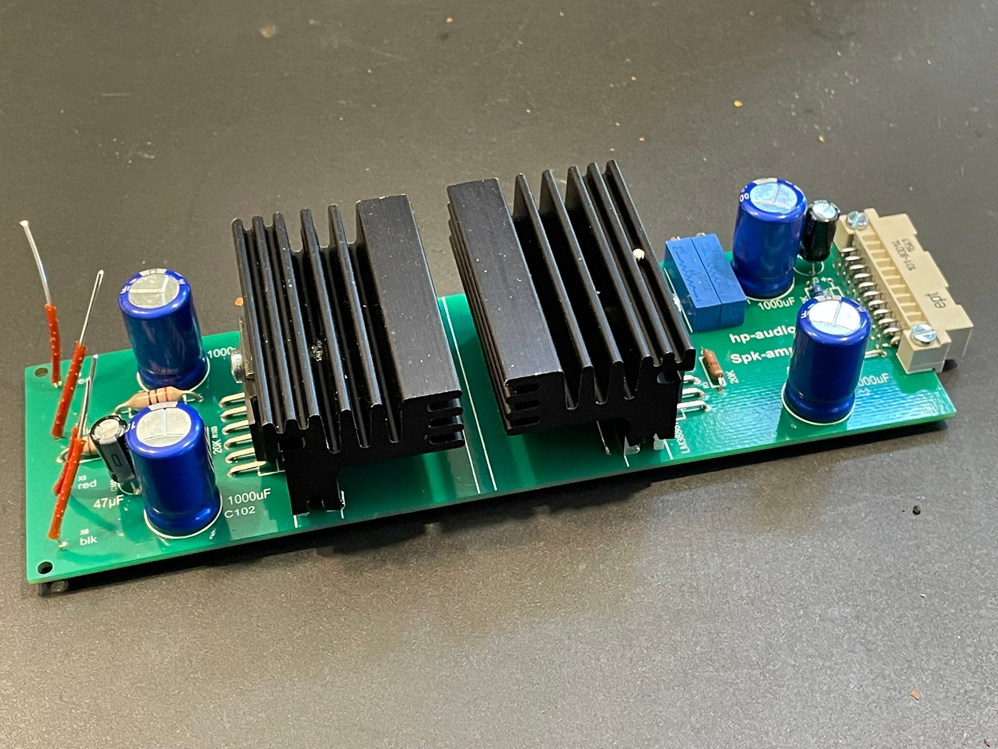

Hi folks,
yesterday the pcbs arrived.......
HP

Hi Speedskater,
this is right....but all cards are input cards OR output cards......never both functions on one card.
This preamp also uses separate relais crossbars for input and output signals. You can see this on pic 0762.
The small card with the heatsinks (pic 0769) is a small power amp card with 2 x 18W........made it just for fun and cause it also fits in the rack as a prelisten amp.
Lets see what ideas for additional cards come up.......
Depending on the cards I put in, there can be 10 different input cards, or 9 input cards and one output card, or 7 input cards and the maximum of 3 different output cards.
