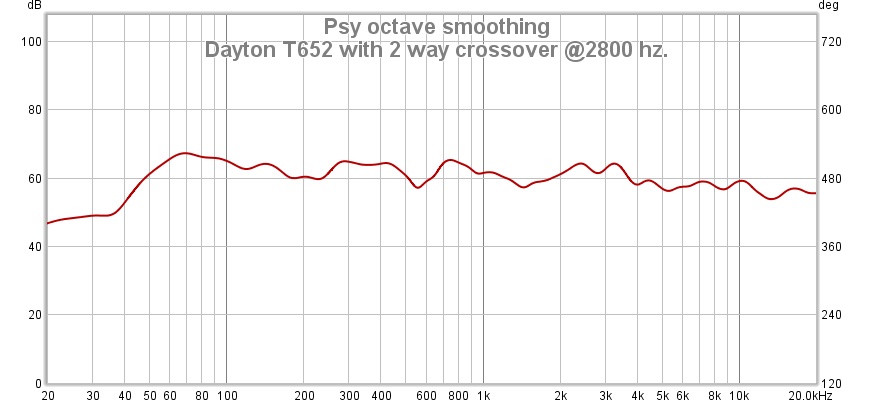

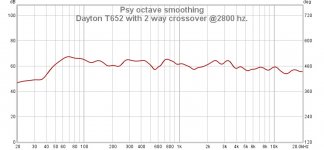

Well, if you have a hard limit on your budget you could try modifying a pair of inexpensive pre-builts to get better sound from them.
Of late I've been messing about with a pair of the Dayton Audio T652 towers with a nice metal tweeter and a pair of 6.5" woofers in them.
What I did was to put a pair of These Crossovers in them, add some polyfill, rewire them with 18ga wire and replace the spring clips with banana plugs.
The thumbnail shows the result in my listening area.

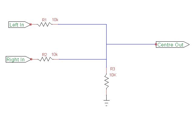

3.0 is appealing but can a center channel be synthesized from 2.0 or do I need a surround source ?
Yes you can get a centre channel from stereo and it's remarkably easy to do. Three resistors... But you will need a 3 channel amplifier and, of course, another speaker.

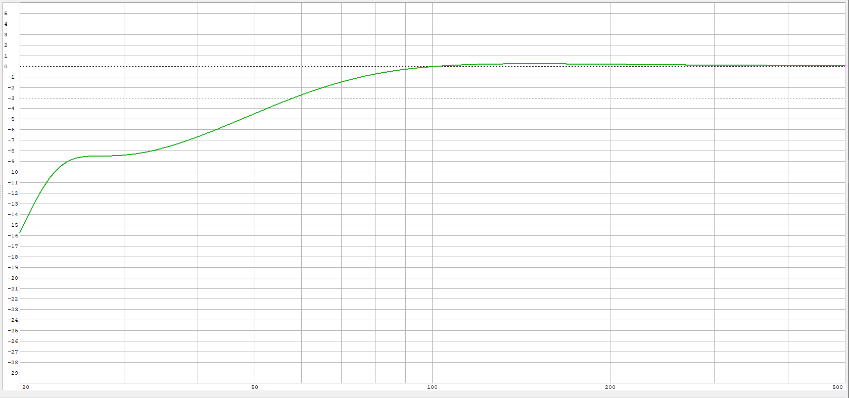

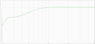

Here is more exactly what I had in mind.
Thin column, 1.3m high, 18cm wide, 24cm deep, for an internal volume of about 33l. Bottom firing port tuned around 30hz (50mm diam, 19cm length). This gives me the attached response.
The tweeter would be at 1m height, the woofers above and below. Center to center, tweeter to woofer would be 12cm (due to the truncated frame). Active LR4 crossover at 1.8khz.
They will go quite close to the wall, not sure much BSC will be needed ?

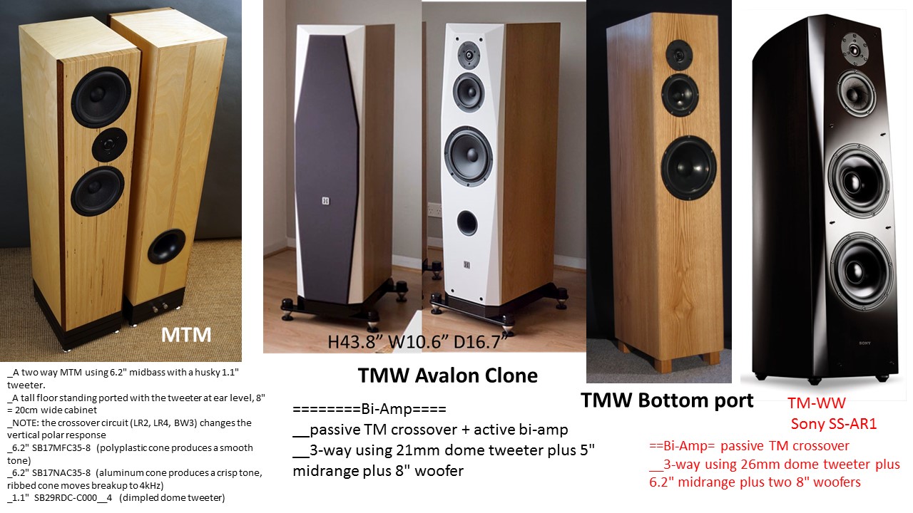

From what I understand from your:
1) stated goals
2) room layout
3) tons of amps, and a small dsp based (4x 50W@4r)
Three driver configurations seem worth further review.
1 ==== cabinet like Troels Galvansen SBA 16 MTM
_BiAmp two way MTM using 6.2" midbass with a husky 1.1" tweeter.
_A tall floor standing ported cabinet with the tweeter at ear level, 8.4" = 215mm wide cabinet
_NOTE: the crossover circuit (LR2, LR4, BW3) changes the vertical polar response
_6.2" SB17MFC35-8 (polyplastic cone produces a smooth tone)
_6.2" SB17NAC35-8 (aluminum cone produces a crisp tone, ribbed cone moves breakup to 4kHz)
_1.1" SB29RDC-C000__4 (dimpled dome tweeter)
2 ===Bi-Amp===passive TM crossover + active bi-amp
__3-way using 21mm dome tweeter plus 5" midrange plus 8" woofer
3 ==Bi-Amp====passive TM crossover + active bi-amp
__3-way using 26mm dome tweeter plus 6.2" midrange plus two 8" woofers

Thanks for the proposals. I'm afraid proper 3 ways will quickly get out of control, price wise.
The first option is however very close to what I had in mind. You're right that 6.5" drivers will be more efficient than 5" ones with a weaker amp. To keep price in check (and keep in line with the "good enough" vibe of this project), I'll probably sub the SB drivers by peerless dx25tg/sds-p830657.
With your budget, the greatest listening enjoyment will come from a very good TM 2-way using only your 2x4 DSP amp, BUT you should include a plan to easily add deeper bass with new money or a new home. Building a great cabinet is the greatest challenge.
MY PITCH: Build one cabinet now which is designed for future bass expansion. Use the 11" = 28cm wide cabinets as furniture tables, since your room is wide enough.
1) Build a TM 2-way T(SB26STCN-4 1" dome with small faceplate ) + M(SB17NAC35-4 6.2" aluminum cone midbass) in a ported -F3 = 35Hz which your 2x4 DSP_amp can drive. Center of tweeter = 36" - 39" height. An MTM design is more expensive and could produce lobing to deal with.
2) Design and construct this 11" = 28cm wide, 3.5cuft volume cabinet to easily add two ported W(SB23NAC45-8 8" aluminum cone woofers with new money or a new home.

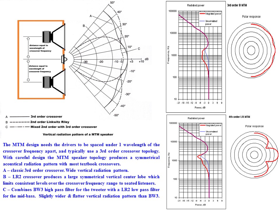

MTM crossovers:
1) Early publications on the "D'Appolito" configuration recommended building a third order BW3/BW3 crossover circuit. Wide, but wavey, vertical polar pattern and a modest power drop around the crossover frequency.
2) Later HT "couch optimized seating" recommend the second order LR2/LR2 crossover circuit because it produced a narrower focused center lobe ideal for the family couch, and a modest power drop around the crossover frequency. Troels MTM uses LR2/LR2 crossover circuits === HT "couch optimized seating"
3) Today D'Appolito uses a fourth order LR4/LR4 circit because with HT "couch optimized seating" it produces a smaller center lobe and maintains a flat SPL around the crossover frequency to the couch listeners.
