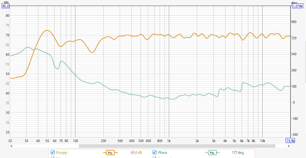

Show the level of harmonic distortion, it is quite possible that sibilants are a consequence of the increased level of distortion in the mid-high frequency range.
Here it is, from the first, non-DSP, measurement:

It all makes sense. Judging by the level of nonlinear distortion, you should hear the problem in the midrange and high frequency range.There's also something that my ears pick up as a "hissing" sound in some mid to high friquencies that I can't put my finger on.
You have THD of 1% at 900Hz and 0.5% at 2kHz and 3.3kHz, and this cannot be fixed, so you will just have to put up with a certain level of lisping from the speaker.
Go to three bands, and then there will be no problems with sibilants.
The THD at 900 hz is driven almost exclusively by the 2:nd harminic. My intuition thinks that changing the dampening/stuffing may help, but mayby that's not how it works?

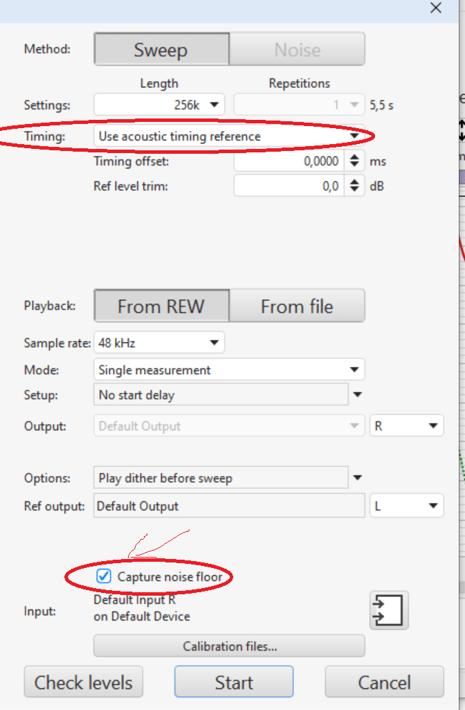

I used acoustic synchronization "from start".
But I did not capture the noise floor. That's on the list for the next measurement then.

I changed the stuffing and found a config where the 2:nd order harmonic was tamed a bit, but the THD stayed at ~1% at 900 hz and with the same spikes at 2k and 3.5k. I perceived it as an improvement.
Then I used DSP to smooth the overall response curve from 100hz and upwards (like in this post: https://www.diyaudio.com/community/...quency-response-in-a-tqwp.417289/post-7783462). Again I perceived that as an improvement specifically in the "hissing" distortion-like sound I was hearing.
