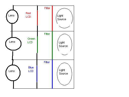

What I want to Build: The best projector one can make for the lowest price
Res: 1024x768 or higher
Colors: 16bit or higher
Light: 50000 lumens or higher
Price: $2500 or lower
Screen: 80" or bigger
This is a crude drawing of what I think would be a start. I don't know anything about optics thats why you don't see them in the drawing.
My questions are;
1) Is it possible?
2) Has anyone done it?
3) Is there a better way to what I want?
4) What problems would I run into?
5) How can we do it?
I know I have alot to learn and alot of work to do. So please don't just look me over. Size is not a problem. Right now I have a hole in the wall going into a closet for my current tv. Thanks

tsnyder41,
for $2,500 you can buy a very good condition CRT projector on ebay. You will not be able to build anything better one than that.
as a matter of fact, thats what you drew in your drawing. crt projectors use red, blue, green lamps to project the image.
if you were to build your idea it would cost you much more than the 2500 dollars you would spend on a crt projector. you would need special "red green blue lcds, very expensive, expecially xga resolution", rgb splitters, convergence programs plus hardware and encoders. plus trying to align those lcds perfectly. you just dont know.....

For a top grade 3 panel system you need monochrome polysilicon LCD's which are not available to us guys. Not that I have seen, and to build a 3 gun CRT projector is beyond the scope of regular DIY.
But if tsnyder41 would give me his $2500 I will try very hard to spend it for him.
First thing I would do is research XGA panels.
You can get XGA panels. You can get good lighting systems courtesy of these DIY guys. You can control your panel via a computer. The big stumbling block is contrast. With a regular projection panel you are looking at 100:1 or 150:1 tops. If thats not good enough you have to consider another option.
If you strip a monitor and assuming you can move the electronics out of the way you could be in the 300:1 to 400:1 contrast range. Pretty nearly good enough for excellent home use but a risky undertaking. We have good info on materials for projection screens
Now you say 50,000 lumens. That is a lot of light. Any reason for so much light with just an 80 inch picture.
You could just buy an XGA panel and a high lumen output OHP. Some of these are rated at 9000 lumens. Certainly give you a good 80 inch picture.
So your dream projector is not too far away. And probably well down on the $2500 budget.

Hi Guys,
While the suggestions presented seem outlandish to our experience, they might not be wrong...
A couple of points, though:
1) The reason to use separate red, green and blue LCDs is because a conventional RGB one blocks 67% of the light due to the red, green and blue filters: the red cell blocks the blue and green components, the green cell blocks the red and blue - etc.
Single colour LCDS need to be combined with beam splitters to make all the red light go through the red LCD, all the blue light go through the blue LCD etc.
This is the main reason they are brighter...
2) I would suggest that in many cases, the contrast ratios of LCDs used for the projection panels are not much worse than the ones used in monitors - if you hit the monitor LCDs with the brightness of a projector, you would be operating it outside of its design parameters, and would probably be lucky to get the contrast levels we see on the projection panels.
3) If contrast was a real issue, it would be possible to stack LCD panels together and drastically increase overall contrast - Xblocker found a German projector in the "DIY Video Projector Part II" thread that uses this principle.
4) 50,000 ANSI lumens output would probably project an image the size of a house - on a house, outside in broad daylight. For home use, with home-size screens, 500 ANSI Lumens is bright, 1000 ANSI Lumens would be INTENSE...

Woneill
The reason they are brighter is better light sources, materials and optics.
There are losses in the beam splitters and combiners and to make up those losses they use very small point source lights which allow much better reflector efficiency and they use much higher light transmission polysilicon material for the panels. And they recycle the 50 percent polarisd light that we loose.
All three points, better light efficiency, higher transmissivity of polysilicon panels and recycling the normally wasted polarised light make the large difference between a DIY effort and a proffesionally designed and built projector. And of course, it shows in the price.
They also use Micro Lens Arrays to give parallel beams throught the panels to give contrast ratios much higher than we can achieve with currently available projection panels.
However what we do achieve is remarkable and even more so considering the low cost price of DIY projectors.

Greetings Woneill
Cannot agree with your thinking there Bill.
If I am reading you correctly you are saying that changing to a 3 panel setup is the main reason for increased light throughput.
You will probably be aware that early 3 panel projectors were of poor performance offering low contrast and low screen brightness.
Furthermore if changing to a 3 panel setup was the whole story one would think they would simply use the cheaper Amorphous Silicon lcd's and get this gain you mention, however manufacturers have not done so.
They have elected to go for the more costly and technicallly difficult Polysilicon material for the panels.
Polysilicon panels are tougher and thinner than Amorphous panels thus offering more light throughput while also offering more saturated colours and better contrast.
I am saying that 3 panel projectors are better projectors today because of a number of important factors not just that it is a three panel unit.
More light throughput of polysilicon panels is obviously a big advance. Better reflector accuracy using a short arc lamp. Recycling the unused light is also a major improvement factor.
Modern projectors are very good and we could do well to study them in greater detail to see if there are aspects that can improve the standard DIY projectors. Not as a 3 panel system which could be too complex for DIY but points which improve a single panel performance.

Whats your best suggestion.
For example
Can we get full colour polysilicon panels.. .
Can we get panels that transmit more light. Perhaps LCOS with a colour wheel.
Can we recycle unused light economically thus perhaps dropping from a 400 watt MH to a 250 MH.
If so can we utilise the shorter arc in lower power lamps to our advantage in better reflectors.
One of these days our supply of 10 year old projection panels will dry up. Already we are seeing good panels like sharp QA 2500 going from $250 to $500 on Ebay. Invsol-inc has completely run out of Nview Spectra C panels and has only Spectra C's without video ex stock.
Before stocks of large panels dissapear we should be looking for suitable alternatives as the small projector panel guys are doing.
We need to promote these discussions Bill otherwise we are not making forward progress. I dont care if you are right and I am wrong or the other way round. We will just have to agree to disagree. What I do care about is investigating and trying to find something that is better, cheaper, technically good and something we can use to improve projectors.
The man said he wanted the best projector he could get for the lowest price but he has a budget of $2500.
