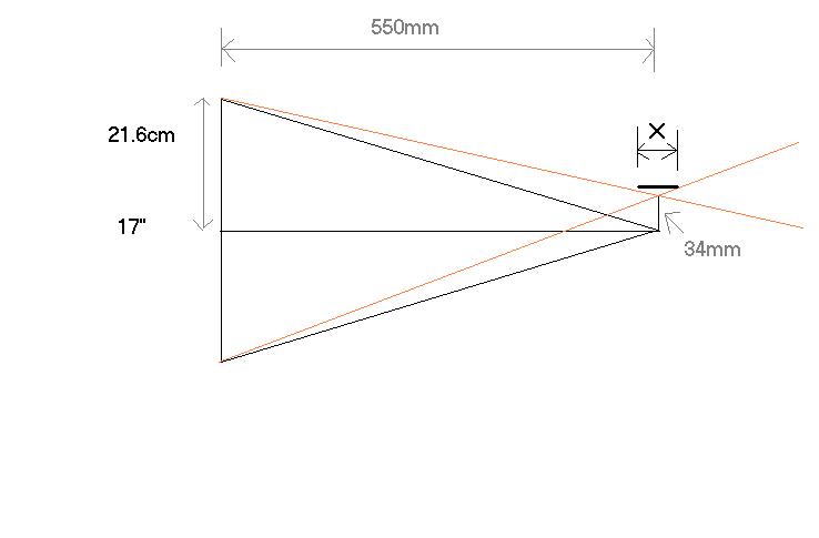

I was doing some thinking last night. What if you had this setup:
25mm - 27mm arc Bulb -> 330mm Back Fresnel -> 550mm Field Fresnel -> LCD -> 450mm - 480mm f9 Process lens
The arc size (arc * field / back) would be between 41mm and 45mm and the diameter of the lenses (focal length / f#) would be around 50mm - 53mm. Would it be possible to get all of the light into the lens with this setup? Using a 330mm back lens reduces light output, but is it really that much???

You can figure out how much light you would lose changing from a 220 to a 330 condensor fresnel. If you are good with 3-D math, then have at it. Or you can do it graphically: Just draw a full-scale drawing of a 17" fresnel with light coming from 220 or 330 mm away. Measure the ratio of the angles and then square that to get the difference between the two designs.
I forget the answer, but it is quite a lot. 😀 (Determining the correct answer is left as an exercise for the student.
That is why people try to use a pre-condensor lens with 330 mm fl fresnels, to capture more of that light. Unfortunately, that magnifies the image of the lamp arc, so it is just as large as it would be using a 220!

Yeah, now that you give the exponential relation to for distance and brightness.... Longer distance is worse (don't feel like getting the triple integrals out, but squared stuff grows and shrinks QUICK). So, I will keep to the 220mm lens. 550mm fresnel is in my future. Just have to get the parts. sigh
