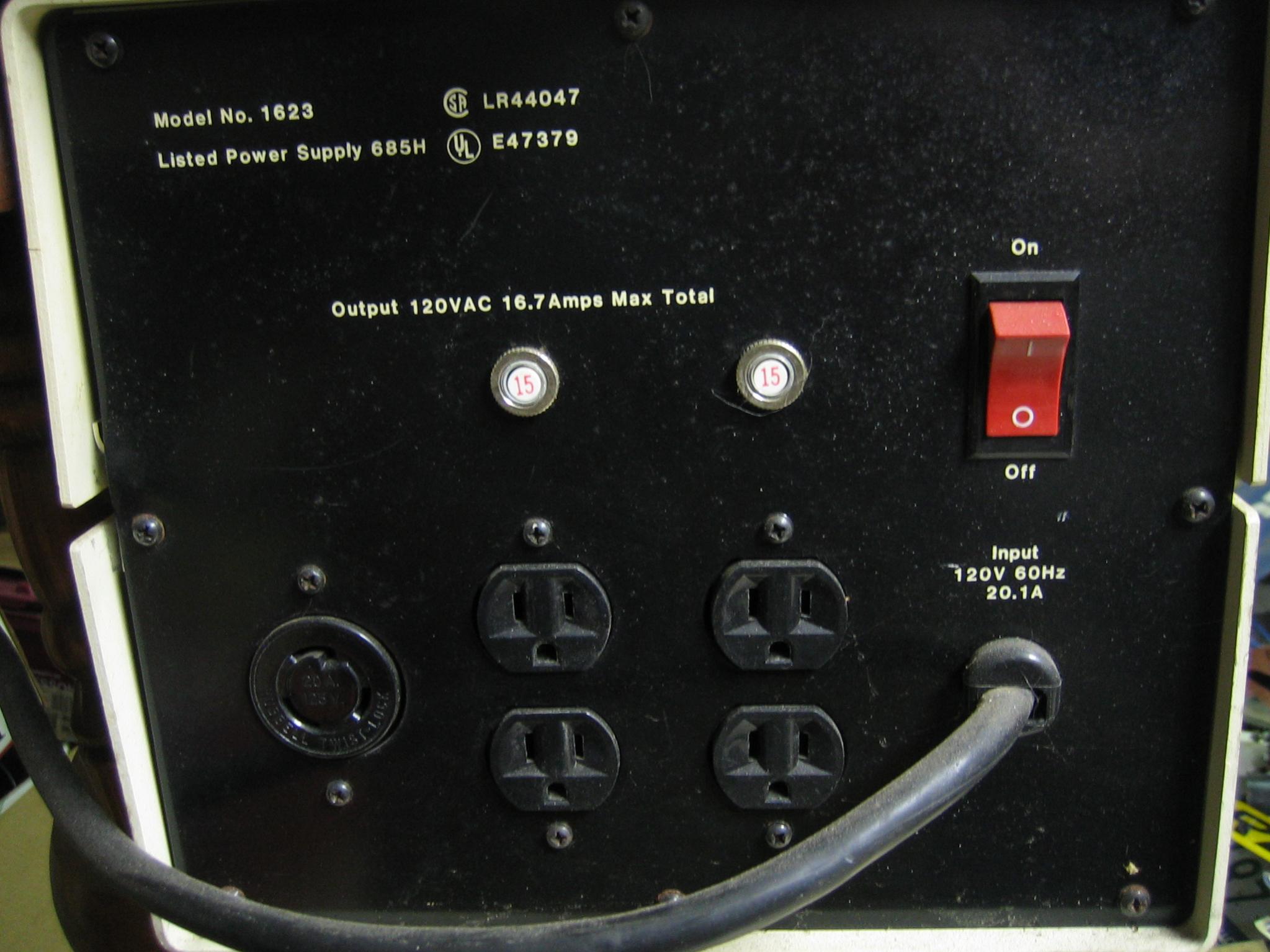

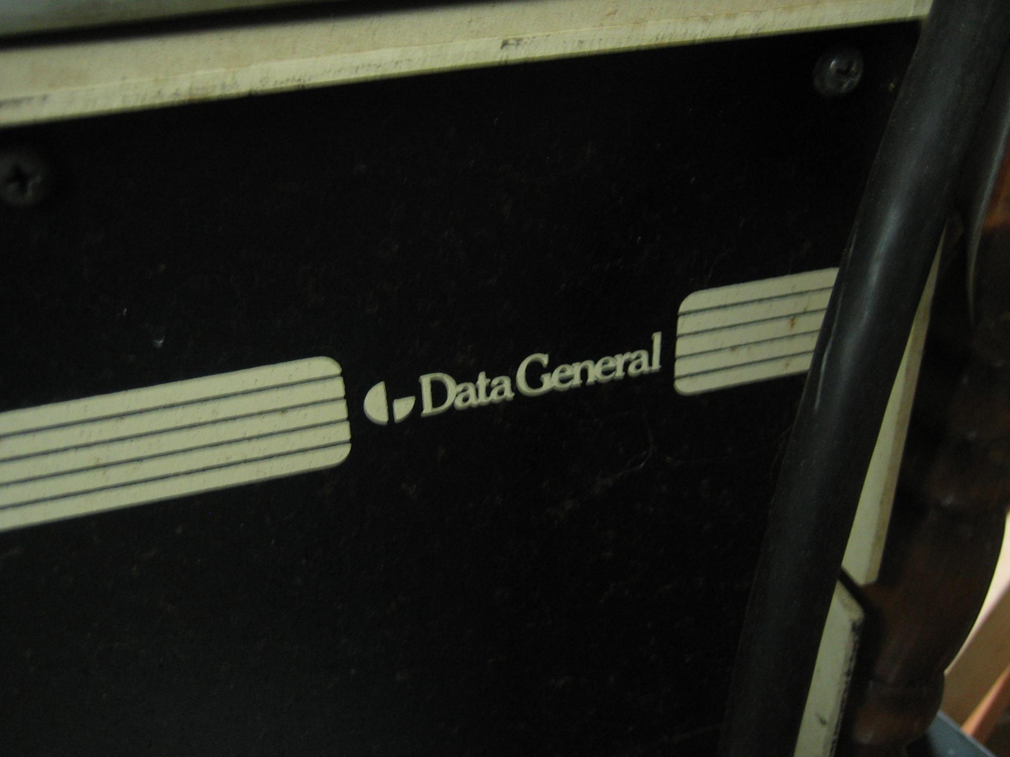

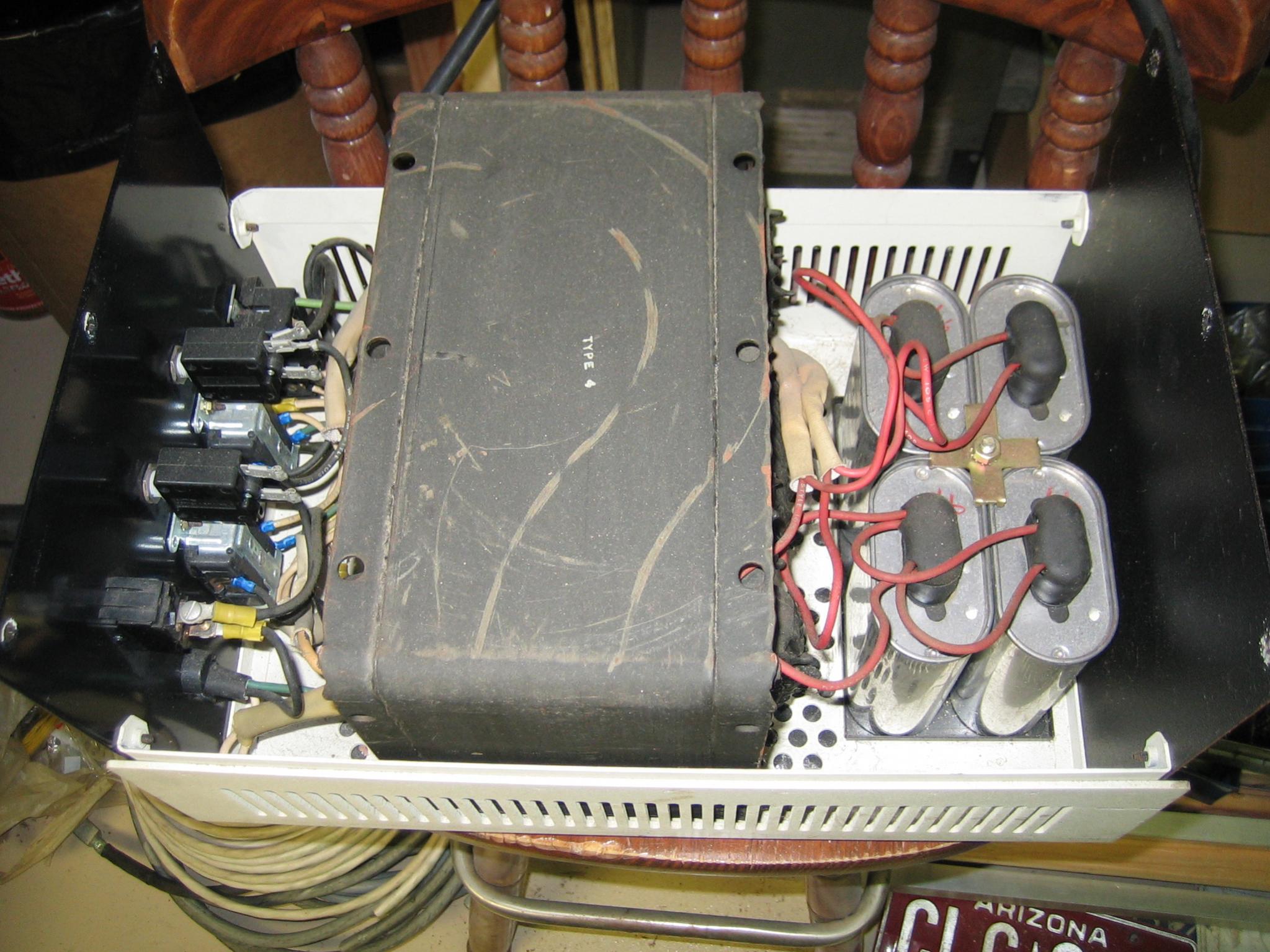

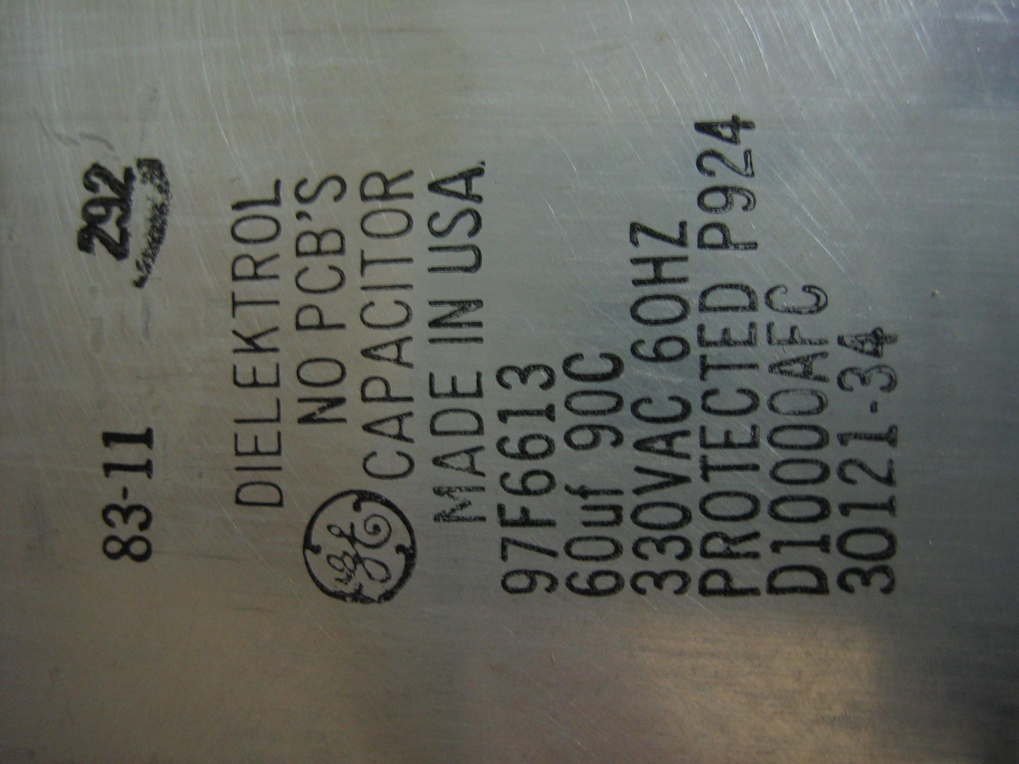

Attached are pics of the 'beast'. Seems to have a large transformer and 4 good sized caps... Star ground inside too! I'll gut the outlets out of it and probably just make a new end panel with two penetrations: in and out...

The presence of the big capacitors suggests that it is a ferroresonant transformer. It should work well for regulating voltage. Just install a switch so you can turn it off when not in use as the standby losses are probably significant.

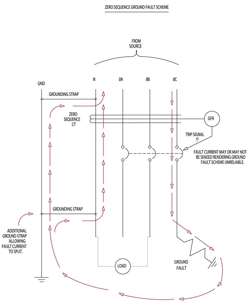

Ground fault interrupters (GFI's) do not monitor ground currents and could care less where your grounds are. They look at differential hot-neutral current, assuming any difference is due to a ground fault. Think about getting a jolt while mowing your lawn- the ground fault occurs on your front lawn, far away from your service ground. GFI circuitry has no connection to ground at all:
LM1851 - Ground Fault Interrupter
I understand that, but the building code requires/allows only one ground point, and it is supposed to be as close to the service entrance as possible to abate a lightning strike on the pole from frying your house as it seeks a good ground through the structure (and usually ignites it in the process). So, if your 'new' ground point happened to have a more favorable path to ground than the required one at the service entrance, the strike would come through the house and find that better ground. I see both sides, and I have decided to stick with one ground.
There are certain circumstances where more are allowed.
