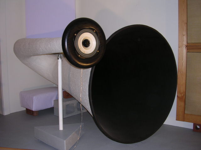

Hi Fosta,
Welcome to the forum.
I understand you are planning to build BLH (organic forms etc) the way I did a few years ago, so here are my thoughts on the subject of solid data and horn shape.
What people do, is calculate optimal horn dimensions for a driver with advertised parameters, using mathematical formulas and than drastically change the calculated dimensions so the horn can fit into a box. And that is what people are repeating after each others until it becomes a "proven" design.
I decided that horn dimensions taken from the top of my head were as good as "solid" data. My ears and my drivers are different from yours (modified Lowther EX3) so the dimensions will not work for you, but this is what I got: L=3.5m; S2=0.8m^2; S1=75cm^2; CC=3l; Contour: Hipex M=0.8; Material: metal powder, fiberglass, polyester composite and solid oak baffle rings.
The length depends on how low do you want the horn to play and placement in the room. Because room boundaries change (extend) the effective length of a horn, calculation of exact and perfect length of the horn is questionable. Similar rules apply to mouth size. Too small a mouth reflects part of sound energy back to the source causing distortions (resonances, cancellations delays…) similar to the ones in badly folded horns. Therefore I made my horns big, round, not folded, with only one bend. For clarification: in a bend, inner wall forms considerable arc (Hedlund horn is an example), a fold has inner walls folded onto each other (like Big Carfrae). In fact, both of these horns are rounded but still square. If you think shape does not matter, just imagine a sound of Canadian Brass playing on instruments made with folded square tubes and boxy bells. If you can't do a horn round all the way, try to make the compression chamber, throat and first section of the horn round and symmetrical on axis of the driver, so the back pressure on the cone is even. Also, the shape of the back chamber determines how the sound waves are reflected back to and through the cone. You can find the influence of the back chamber volume and throat size by computer simulation. Try 2, 3, 4 and 5 liter chambers and different throats and compare the changes in horn output and cone movement. The back chamber can be reduced after horn is tested and horn can be tuned with stuffing to suit your ears.
You can find information, theory and calculator at James' site:
http://fullrangedriver.com/singledriver/hornshape.html
Or maybe some resident expert here or on James' site will supply you with perfectly compromised dimensions.
Good luck,
Marek

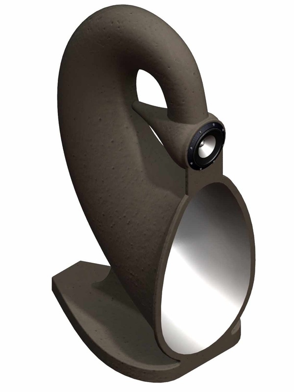

nice one marek!
Thanks loads for your informative response.
I wasn't expecting what you said to match so closely to my concepts (reasons to avoid square horns, large curves etc...)
To give you an idea of what I already had in mind, I built the model you will see below in CAD to precise dimensions (using some of the free software available to calculate the correct rate of expansion). They are currently too big so I'm going to have to find a way of shrinking them down a bit before spending an aeon in the garage building them.
Form followed function in every respect in this design, yet the final look actually gave me a great deal of satisfaction to how they could look.
Ben

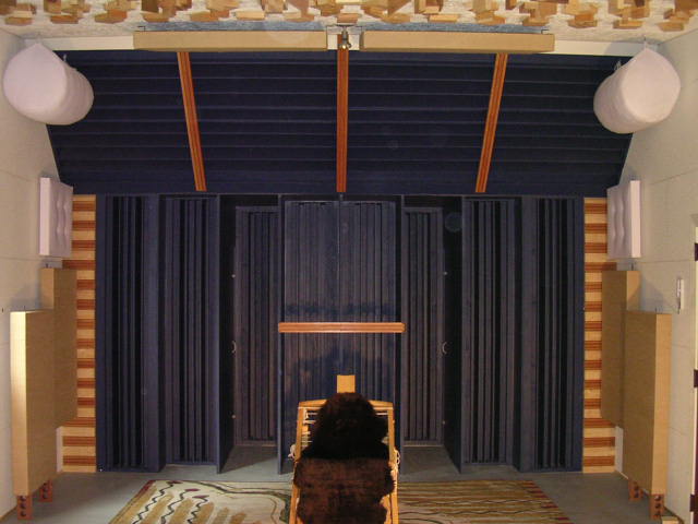

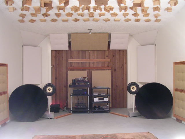

Marek, wow, incredible. And your room is more tweaked than most recording studios I've seen. Amazing.
Fosta, your image is not attached (due to the preview message function, I would guess).
Hi marek, that is really amazing. So you are going for diffusion more than absorption? Is that a concrete floor?

Fosta,
It looks fantastic, but it will be difficult to make a casting form.
Consider a possibility of exchangeable baffle - I found out that trying different baffle sizes helps to get the sound just right.
rjbond3rd,
I started with 200 square feet "quadratic" diffusor (the back wall) and kept adding broad band and bass absorbing panels and devices. I did not like the sound till I got about 200 square feet of these panels. The floor is concrete but part of it is covered with heavily padded carpet and the walls are partially finished with acoustic tiles. The ceiling diffusor adds only a bit of diffusion. To get good sound integration of horn and driver you have to be far from the speakers therefore reverberant room would bring too much of "room sound" to you.

Fosta,
Hi again,
Do not feel offended if you are a casting expert, but folks who are not, may want to know a bit about the technology. To make a casting form for resin based composite, the form has to be non porous, not sticky and it has to be chemically resistant to the resin used. Unless you cast the left and the right side of your horn separately, you will need to remove the inner part of the form from finished product either piece by piece or melt it.
In DIY world it is much easer to lay fiberglass composite on collapsible (easy to remove) male form than to cast it into double walled form. I explained on this forum before how I made an inexpensive mold for my horns. Horns of almost any shape can be made by a handyman in a shed for not much more than the cost of polyester resin and fiberglass. As I said before, celebrated designs are work of amateurs like as, the horns are compromised, designed primarily for manageable size, acceptable looks, easy build, maximum profit etc not for best possible sound. They are not worthy duplicating as round horns.
Marek
Hi again,
Marek
It's all good, no worries,
I'd actually come across this issue a long time ago (and since then i've had to put the project on hold)
When I get back round to it i'll be looking into using glass fibre reinforced concrete which you can even trowel on. This stuff at 15mm thick will give similar properties to reinforced concrete 40mm thick, you can hire out the equipment from most local tool suppliers and it's not as messy as using many other resins.
as for the inner mold... I was thinking of creating a permanent 2 part mold that could cast this feature out of something like roof insulation foam. You could burn it, use acetones or cut it out after with relative ease.
Ben
