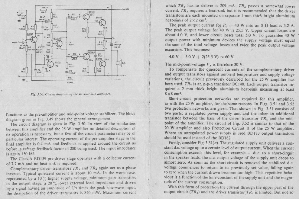

What should be the ideal biasing current for a 2n3055 transistor. I live in a part of the world where temp goes up to 45 degree Celsius during summers. So for me power dissipation is a big concern....
In want the transistors to perform optimally yet not overheat.

The amp in question is this http://www.diyaudio.com/forums/attachments/solid-state/241639d1316944231-philips-40-25-15-watts-amplifier-universal-preamplifier-circuit-scanimage002.jpg
What bias current would you recomend for this amp. Right now I have bias set close to 21mv
That is a quasi complementary output stage.
21 mv across 0.6 ohm is giving around 35 milliamps which sounds quite high actually. Something nearer 8 milliamps would be nearer the mark I would have thought.

this is wrong. It is not current that you need to set."Ideal Biasing Current................What should be the ideal biasing current for a 2n3055 transistor...............
This is more correct. But that 21mV is the value usually adopted for an EF output stage...............Right now I have bias set close to 21mv
The CFP is roughly a bit less than half the voltage normally.
D.Self gave some numbers for the bias voltage for EF (2.86 to 2.93Vbias) and CFP (1.297 to 1.298Vbias) output stages. For a quasi complementary output stage which is half EF and half CFP, it turns out that a Vbias similar to a CFP gives lowest crossover distortion. On that basis I would look at using 1.297Vbias, until I could measure for lowest crossover distortion (this corresponds to the 8 to 10mVre that Mooly talks about).

D.Self's Vbias is across the Vbe multiplier, after the Radjust resistor. You need to read his articles/book.
