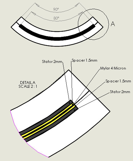

Hi all,
I've built some conventional speakers in the past, but I'm just now getting into the ESL thing. I have done some reading on the internet and I'm attracted by the superior sound quality this system should provide. As far as I understand, there are only two disadvantages to an ESL:
1: The response of the lower frequencies, say below 100Hz, which can be easily solved by using a hybrid system with a 'normal' dynamic woofer.
2: An ESL is extremely directional, which can be dealt with by making several sections, but making these sections hase several disadvantages for the sound quality.
Also, a tall ESL (of say 20 to 30cm wide and 120cm high) is said to have better dispersion and better placement than a wide ESL.
Now here comes the idea that popped into my mind this evening:
Why not make a tall, partial round ESL to enhance dispersion and optimize sound quality?
I have attached an image to clearify the idea.
Of course somebody else already thought of this, but I cannot find any info on this forum or the internet.
Of course it's a little harder to build than a flat ESL, but no too hard I think.
Also the Mylar film would be in a bent position which would stiffen it, but because it's only 4 micron thick I expect this to be unsignificant for it's movement (and thus the sound quality).
Maybe somebody here could come up with some more pro's and con's for this idea!

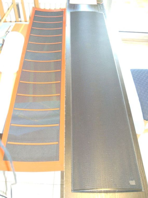

to bend or not to bend....
I actually don´t know the true reason why ML bends their panels.
My experience showed that both claimed reasons do work. The dispersion characteristic is widened against a flat panel, but not very much (I understand the claimed 30° as+-15°) and the panel is much stiffer than a flat panel (the mylar-diaphragm is not stiffened as You thougt correctly Emiel). Still You have a very distinct sweet spot. But imo its better for all-the-day-by-the-way-listening.
Of course there are several methods to stiffen a flat panel, but You rarely find one that is so optical pleasing, easy to build and therefore cheap! Has no one realized that by construction the MLs are not superduperhighend but cost-optimized products using off-the-shelf-parts and simple cheap manufacturing? (don´t get me wrong ere: it´s no disregard, but respect for cleverness)
Building a curved panel is not that difficult. The main difference is to build a curved tensioning gauge. You just have to know that You have to tension the diaphragm only parallel to the straight dimension and not -or at least as little as possible- in the curved dimension. Then the diaphragm keeps a cylindrical shape. The major drawback of curved panels is, that for installing the membrane into the tensioning gauge and later onto the stator You´ll most probabely need a helping hand, whereas you can build a flat panel alone! 😉
The horizontal spacers within MLs design (as well as in all other good designs) serve two purposes. The first is to really assure that the diaphragm stays in a cylindrical manner. The second, general and much more important reason is dynamic stability. You´ll find in the literature that a diaphragm should be supported in a way that the shortest free vibrating distances are 70.....100 times the diaphragm-stator-distance (d/s), e.g for a d/s-spacing of 1mm the diaphragm should be supported every 70...100mm. Using greater distances may lead to the membrane touching the stator whilst playing high levels of music, whereas smaller distances reduce efficiency. Especially with hybrid designs the membrane tends to be blown into the stators by the woofer´s pressure waves. ML uses varying distances in their panels (but all within this 1/70...1/100 range), which leads to a broadened and less strong resonance (Fs) A point Roger Sanders negates in his book, but my experience is that it actually is so)
Bent panels are restricted in their ability of linear diaphragm travel. But as long as the d/s can be kept small (and this is the case for all frequencies well above 100Hz) distortion isn´t higher as in flat panels. As a very positive sideeffect the efficiency is high. Every tenth millimeter more in d/s-spacing costs efficiency, so use a as small as possible d/s.
A nice trick to ´overcome´ the differences in membrane behaviour between positive and negative excursions (front-back) is to make the back d/s-spacing app. 10% greater than the front d/s.
There are some major/minor flaws in Your construction pic.
Keep the angle of curvature low. You´ll get enormous difficulties with angles above 40°. 20° to 30° is enough.
Use thin metal sheets. When punched or routed each hole in the sheet does not only look like a BR-canal but it behaves the same way -a bandpass filter! Thick sheets tend to restrict the possible bandwith of the speaker to frequencies within the audio range.
One solution would be to increase the hole diameter, but that leads to a less homogenous and lower field strength. The second solution is to use thinner sheets. When possible with regard to stiffness the second option should be drawn! Here comes the curvature into the game again 😀 Here 1.5mm steel for panels over 2.000cm², 1mm for panels over 1.000cm² and 0.5...1mm for smaller ones is thick enough.
A d/s-spacing of 1.5mm is more than enough. I´d opt for even lower d/s of 1.1mm(back) and 1mm (front) for panels up to 400mm width.
You use such panels from 150Hz on (earliest!! but better is 200Hz...250Hz).
Use very high diaphragm tension (the material should be elongated roughly 1.5% to 2%). With 4µm PET You can reach up to 180Hz (d/s: 1mm, horizontal spacers 70mm apart). This high tension gives You high efficiency and very high dynamic stability. You don´t need high transformer ratios and polarising voltages which leads to a safer panel and less aging stress (corona effects always lead to quicker aging especially of the diaphragm coating, as well as the insulation materials).
ML uses 12µm foil that can withstand higher tensions, so that even 250Hz is possible. They use such high tension because they use the resonance for frequency response purposes. Electrically the panel is crossed over well above the resonance (app. 400Hz, 12dB), but acoustically the crossover point is at 250Hz very steep (>>24dB). This works really good in terms of efficiency (95dB and more is possible), crossover elements count (just a dampened high-Q-12dB-HP, consisting of 3 elements) and measurement, but imo the acoustic footprint of the resonance is audible.
When planning a crossover-freq of lets say 250Hz, use a Fs one octave below and adjust the diaphragm tension accordingly. You have to get rid of the resonance in the freq-response with an additional Notch-filter (higher number of elements) and You loose efficiency, but imo it sounds better.
That´s it for a beginning 😎

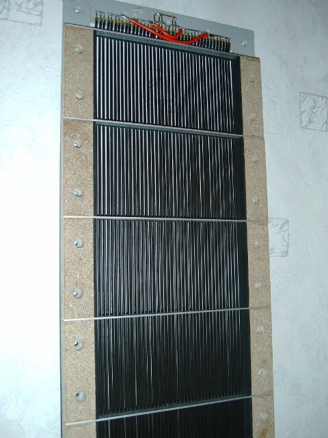

famous last words!!
"...easy-to-build wired stator"
"...I think I've got it all figured out, there's only one thing need to know:" 🙂 😀 😉 🙂 😎
Just kiddin......don´t be upset. 🙂
Follow the link http://www.diyaudio.com/forums/showthread.php?s=&threadid=64620
and have a closer look to the frequency response of the raw panel (Multidioc 1. Panel is 125x25cm). You´ll see that above the strong resonance at 180Hz (Fs) the response curve shows a clear dip (250-700Hz). This is due to acoustic phase cancellation and can only be countered electronically (filter) and/or mechanically (much greater width of the speaker by using wider panels or an open baffle)
This is a typical response curve for an open planar speaker and shows the problem of very low crossover points.
Your specs will be hard to achieve. I actually believe You can´t reach them with Your concept at all without throwing a helllot of work into the panels!
Solutions for this panel size:
- higher crossover freq of min. 250Hz
- reduce d/s from 2 to 1.5mm (with >250Hz 1.0mm)
- take a higher transformer ratio 1:100 or more
- use thin wire (best should be Kynar-isolated wire-wrap-wire of AWG24, AWG26 or AWG30)
- even better, though very hard to get in small quantities is corona resistant magnet wire (not the standard types!!) that are intended for inverter use etc. (wires leave You with the not so trivial prob to get between 300 and 800 of them straight and I mean really really very very straight
Solution II same crossover:
- bigger panel with min 400mm width
- 2mm d/s
- higher transformer ratio
- use even more thin wires (600 to 1.600) or
- spare the work and use metal sheets 😉
- use massive electrical equalizing
Solution tip:
- work with metal sheets on Your first project (there are enough probs left that can ruin Your nerves)
- restrict freq-range to >200Hz

oh my gosh...and I was thinking I were crazy designing a hybrid with a panel of 70x200cm and a dipolar bass tower with 12 drivers per side 😉
But doing this in wire!!! Well....if You´ve really done that successfully, I promise I´ll only call You Mr. Ironman ESL from that day on 😀 😀
To give You an idea of a successfull(?) implementation of that:
have a look at MLs archives for the original old Statement. They claim it to be crossed over at 120Hz and I´m not sure if they used a filter-Q more or less than 1 (probabely >1).
"..(total diameter 1.1mm) at a distance of 2.5mm hart-to-hart" Does this mean +-0,7mm maximum excursion of the diaphragm or +-1,25mm or +-2,5mm??
If You´d use a frame made of 3mm thick spacers, stiffened by lets say horizontal aluminium bars to which the wire would be glued in a vertical manner, You´d end up with 1,9mm excursion. (Think of the Audiostatics! and have a look at the pic).
Using 2.5mm thick spacers and a double sided sticky tape (TESA for carpets, ~0,1mm) You end up at ~1.5mm. This is the easiest way to build and gives a higher efficiency and should just be sufficient for the needed excursion levels.
You could have a stiffening bar every 150mm in height, so You can place diaphragm dampers in form of a small foam strip or a silicon dot right under those bars. But You might need more stiffening for such thin wires, so double the number of bars count (but not the damper count!) In this case You won´t even need to tension the diaphragm mechanically. You can tension it thermally which has some advantages, eg. less material stress, consistancy in parameters and ease of production and will give You a resonance of app. 60-80Hz.
I´d place one wire per 2mm, i.e 1,1mm wire and 0,9mm spacing. That gives You an covered/open-relationship of 55/45 (acoustically, electrically it´s just 25/75). The prob with this wires is, that the electrical coverage-ratio and therefore efficiency is quite bad, because of the thick PVC insulation. This is countered a bit by the dielectric constant of the insulator (which should be high for efficiency reasons, but unfortunately isn´t with most plastics. Luckily PVC as well as polyamides like Kynar range quite high amongst plastics)
Kynar-isolated wire-wrap-wires have thinner insulations which allows for more wires in a more dense fashion (better ratio) and closer proximity of the copper to the diaphragm (remember EVERY 1/10mm counts). Even better are the magnet-wires, because they have the thinnest insulation. Additionally You can get rectangular magnet-wire which allows for even higher field density/strength.
My own old panels were 24x140cm with 30mm spacer-width, 4mm thick. I ended up with app 18x120cm free membrane area. I used H07-VU wire which is PVC-coated with an dia. of 2.8mm. This leaves 2.3mm of excursion after glueing with tape. Thermal tensioning of the membrane gave a Fs of app. 60Hz. Efficiency with a 1:100 trannie was at 80dB/2.83V/1m. Dynamics were still impressive because the maximum SPL was way above 100dB (but the fuses of my Rotel which is capabel of some 300W blew quite often
Only slight equalizing was needed within the filter to linearize freq-response. It gave some people on a DIY-fair something to think about how a speaker could reproduce if not built with dynamic drivers in the midhighs 😉
But compared to my new metalsheet panels they loose in each and every way.

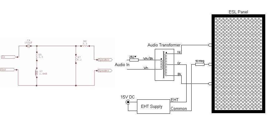

Thanks Calvin I will remeber the mks in the future. What about the attached circuit, is it correct.
circuital correctness
Hi D,
the circuit is corrct so far. Just leave out one of the series resistances (3.3 or 2R2). But keep in mind that just the topologie can be correct for many ESLs (it surely is not Mr. Right for each and every panel) but the component values depend on the ESL´s impedance and surely they must be redesigned for Your panel

On the 18-10-2005 you added a pix of a curved panel ESL at the bottom of your reply - is this a commercial panel and if so can you provide me with a URL etc?
If you don't want topost this directly in the forum, can you email me privately?
aw (at) vacuum state (dot) see oh m. Of course, close up the spaces and convert the phonetics
Thanks, Allen
Thanks, Allen
