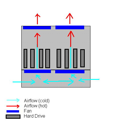

I presume you'll be adding some generous cooling for these drives; I'd use two or three salvaged power supply fans blowing incoming air directly over the drives, maybe running on reduced voltage (7 to 9 volts) to quiet them down. Passive just doesn't cut it, unless maybe you're taking advantage of special power-saving features. Just leaving a 3.5" drive plugged into a USB adapter on the desk, the case temp hits 50 C or so after running for an hour. Not good for longevity.

The case I'm making is going to use a PWM control. I have a pair of thermistors going to analog inputs on a PIC, with digital outputs driving the fan PWM pins. It's a simple linear relationship between input level and output frequency. The drives sit on their sides to allow better convection cooling, and there's a pair of fans at the top and bottom of the unit for when convection isn't enough. I've attached a basic idea of my design for airflow. The view is from the side; left = back of the unit, right = front.
