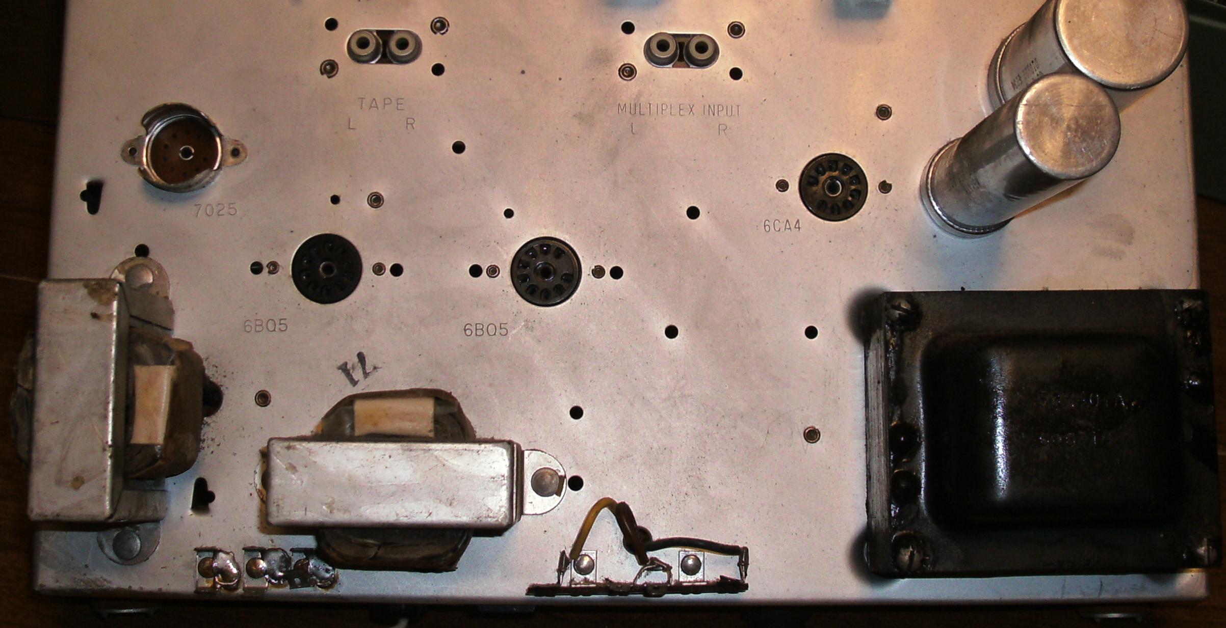

and if so, does it appear complete?
7025 is the tube incorporated with pic 1, the circuit in question.
i dug up an old radio, like 14 tube or so, tore the amp out and what appears to be a pre to me.

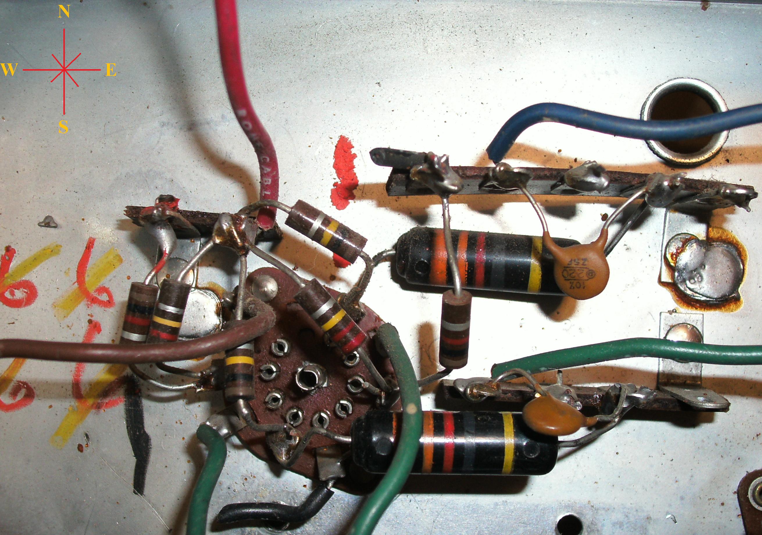

what i assume the wiring is;
south b+, north input, west 12vdc, east output
i figure i will check here before i let the sparks fly.

The 7025 is a 12AX7 with a hum bucking, spiral wound, heater. Preamplification duties of 1 kind or another are the uses for 'X7s.

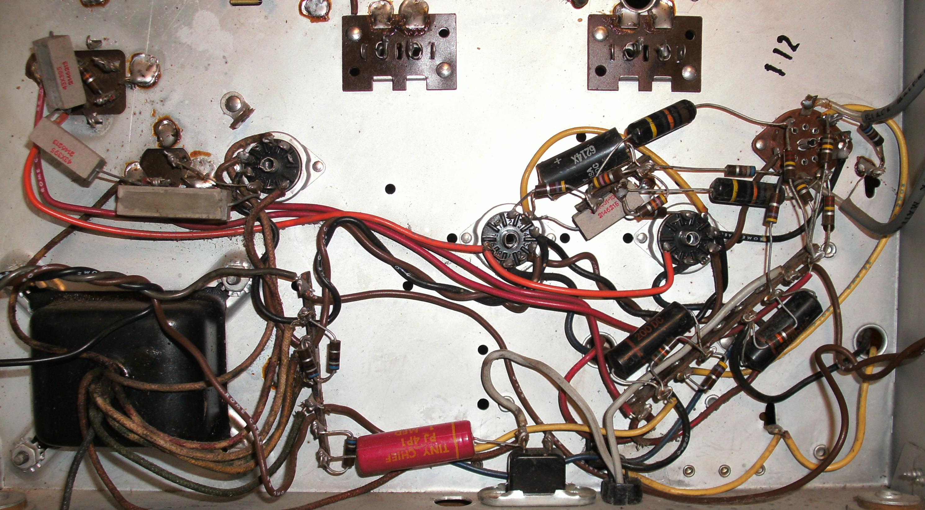

Looks like a complete power amp to me, power & output trans are there, all sockets including the 6BQ5 power sockets still have components and wiring intact.
i am a bit confusing sorry,
in question is this small circuit, i am wondering if it appears to be complete, i carefully removed it from the radio portion of the unit, it appears to be a pre of sorts,
b+(red south)
12v (brown black)
output (blue green)
input (north)
if i wire this this way, prehaps it will work? i will do so with extreme caution, just looking for a second opinion..

It is a pre but your red (which IS B+) heads north in the pic which is even more confusing.
The black, on the terminal strip with the blue output, will need to be grounded to the terminal next to the red B+ or that channel won't work.
The brown-left and the black bottom are the heater connections.
I also don't understand the outputs being taken through small disk ceramic capacitors. I would take the outputs directly from the plates (trace the outputs back to the tube to find the plates, blue traces back to pin 1 of the 7025, green o/p to pin 6) via a 0.1uF 400v film cap. There's not much bass going to go out via the existing caps, unless the following stage is VERY high impedance.
I suggest downloading the 7025 datasheet to become familiar with this circuit and the pins of the tube, before using it for anything outside the original box. You will see how it is similar to the section in the main amp box, but with some crucial differences as well.

You didn't say whether you still had the tubes for the amp chassis, but that has the potential to be a nice little SE stereo amp of about 5wpc. I just built one like it with a 6N3 instead of the 7025 and it sounds far better than it should given the tiny 50 year old transformers that are similar to yours.

the stereo amp is awaiting a 6ca4 tube, i currently have none, the amp looks simple and clean, a bit better than the other in my prior posts, its just one of many projects i want to rap up before spring, i just found a cool widow-maker ac/dc amp, just two 50c5 and one 12ax7..
ok very cool advice on the pre circuit! it is what i was hoping one of the many tubesperts here would provide. i was comparing with other 12x7 one tube designs and taking in what you stated and it makes a bit more sence now, having the pre designed along side with amp is perfect for my tubed boombox project. i only need now to figure out how and if i can get it all sounding sweet. then wire it to a cassette head and squeeze it into a boombox, non-cordless of course, i am tring to locate a tube 8 tract for the pick up..
any ways sorry about the confusion north south, left right i am a bit dislexic, perhaps i ate to many resistors when i was a child, hey they looked tasty, and i manage.
I'm no tubespert, far from it, I'm quite new at this too, just noticed it looked similar to some stuff I had just been playing with and thought I could help a little.
Now, whether it has the gain (and the right equalization) needed to run from a tape head directly is another thing entirely. I was assuming you wanted a flat-response line stage. However, if you can find a tube stage that does the tape-head equalizing, that just needs a little gain, then the 7025 one will certainly work.

today i found the 6ca4 i needed for this project, the power amp uses two 6bq5, 7025, 6ca4....
can i use a standard ge 12ax7 on this amp, in place of the 7025?
edit; i found the answer and it is yes, my bad
i know there interchangeable though i want to check here first.
