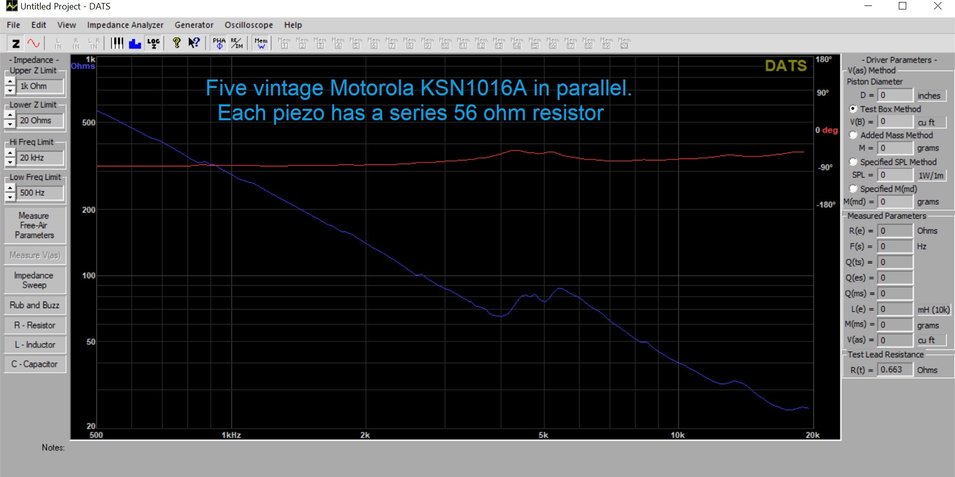

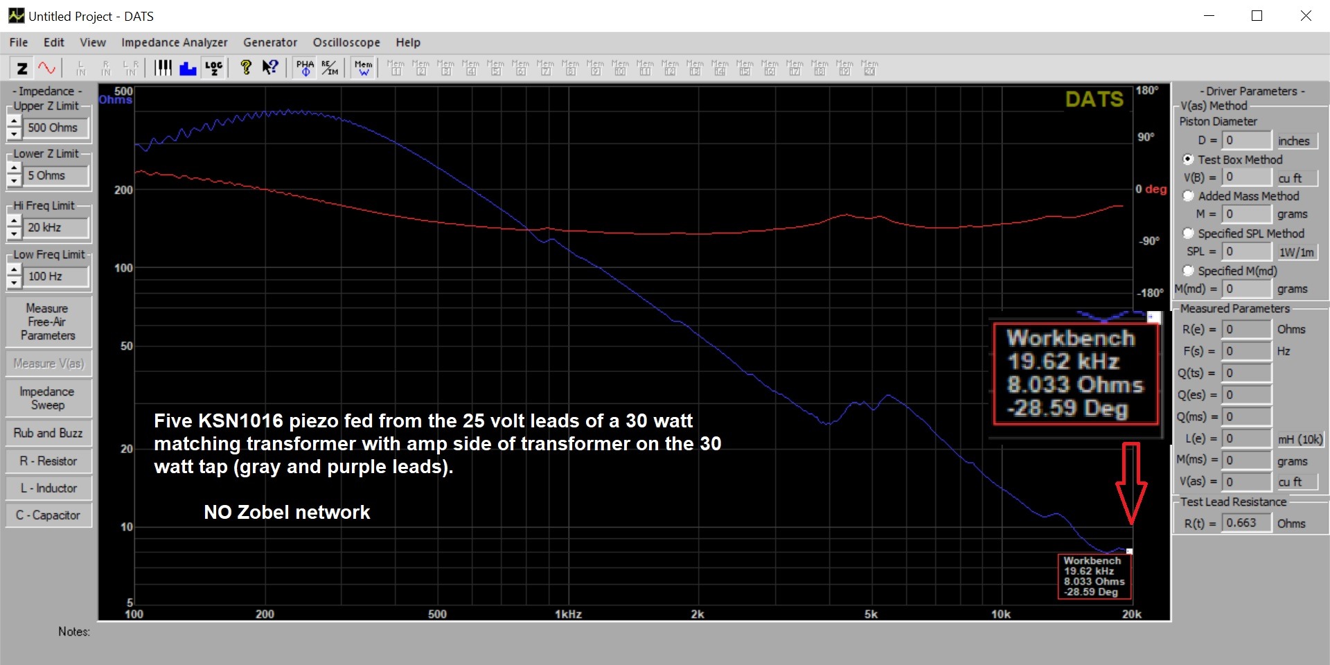

as each piezo approximates a 0.13uF capacitor and that five in parallel are not loud enough to keep up with a 99dB rated fullrange 12" much less my horn systems,the transformer needs to be wired to step up voltage.
Each piezo has 56 ohms in series to limit how low the total impedance may dip.
Here's the impedance of the five
KSN1016 in parallel with no transformer and no Zobel network.

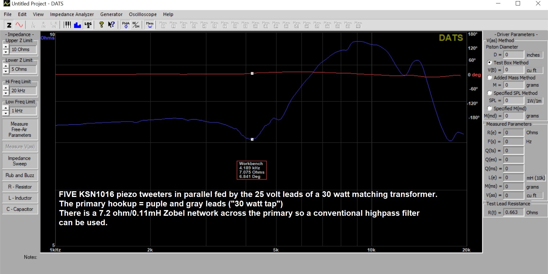

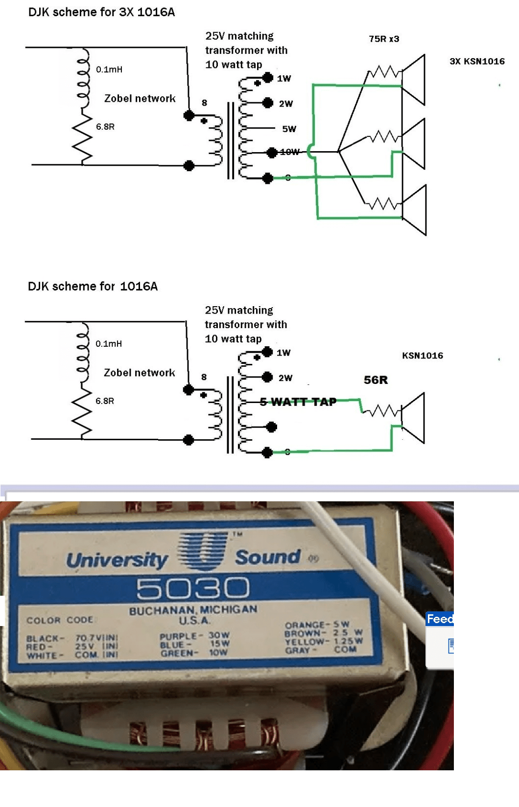

When I wired the transformer with the 25 volt winding (red and white leads) as the primary - I got a step down transformer action. I guess I could try the feed to the piezo array.15 watt tap as primary and 25 volt leads to the piezo tweeter stack.
In the impedance sweep - you can see deviation from ideal capacitor behavior - I assume that's due to mechanical resonance and represents problem area issues - peaks - then a dip up higher.

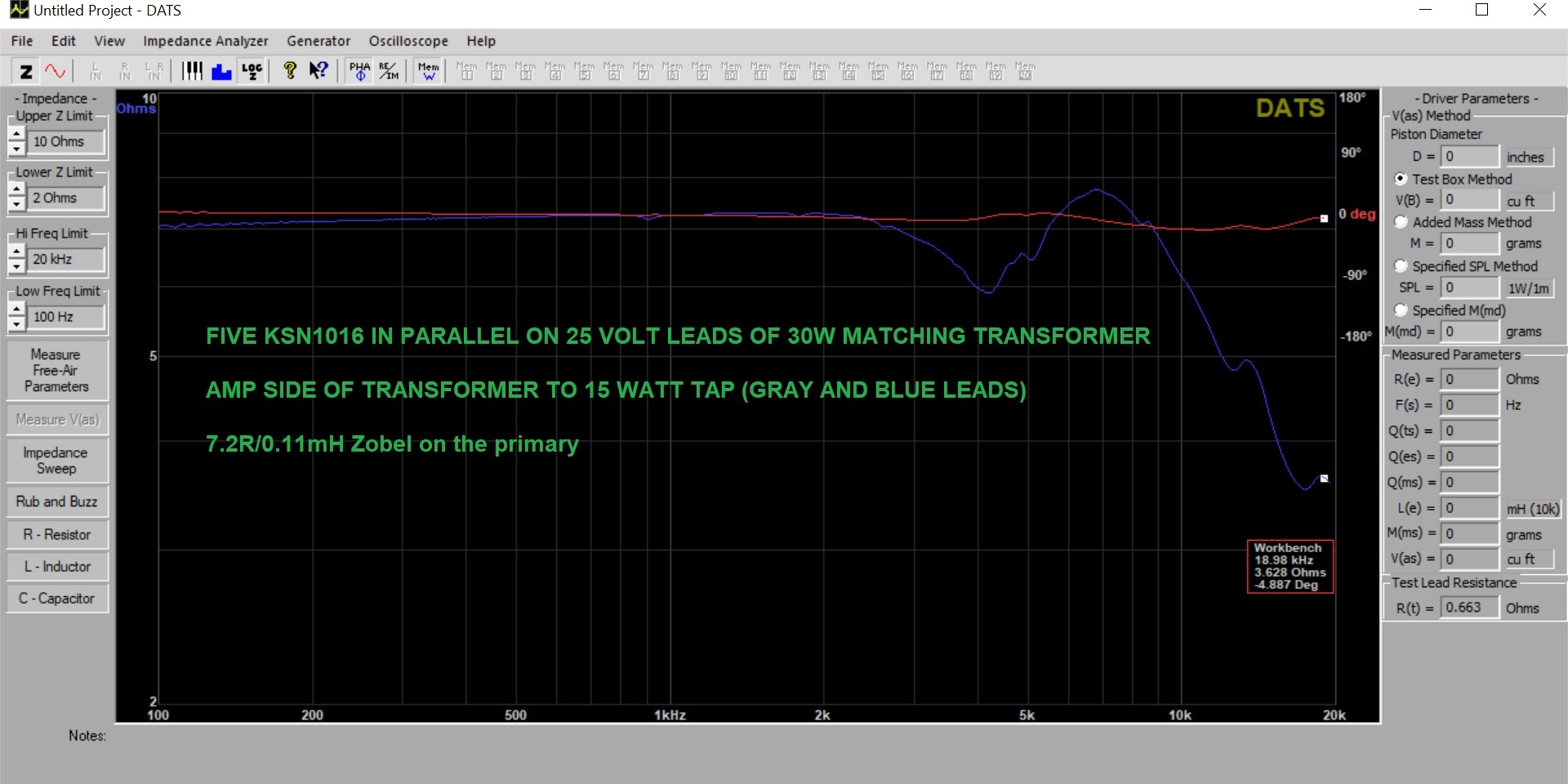

Stepping down voltage is what this kind of transformer is designed to do when connected normally.
If you connect it backwards, it will step up voltage, but with a capacitve load you may wind up with high frequency limitations (worse with higher step-up ratios). I'm not familiar enough with them to say whether it's an issue. Most of my transformer experience is with electrostatics.
Try red/white (25V) on the piezos and purple/gray (30 W) to the amp. If I'm thinking correctly, that should give you the least step up.
Ran a few more numbers:
30 W and 25 V connections should give 1.62 turns ratio, so about 4 dB of voltage gain
15 W and 25 V, 2.29 turns ratio, about 7 dB voltage gain
Impedance transformation is turns ratio squared, so you can calculate that as well.
If you want to do everything as cleanly as possible, you may want to put your measured loaded transformer impedance data into a simulator. Transformers and passive crossovers can sometimes interact in strange ways. It's highly transformer and load specific though.
@mattstat - -many thanks - empirical (see what happens) is about all I can do. Here's some results (i can post the 15 watt tap results but figure the 30 would be used in practice)
I have successfully used 2:1 (6dB) and 3:1 (10dB) step up transformers for very loud Piezo arrays but wound my own air core transformers.

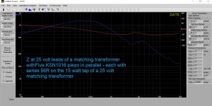

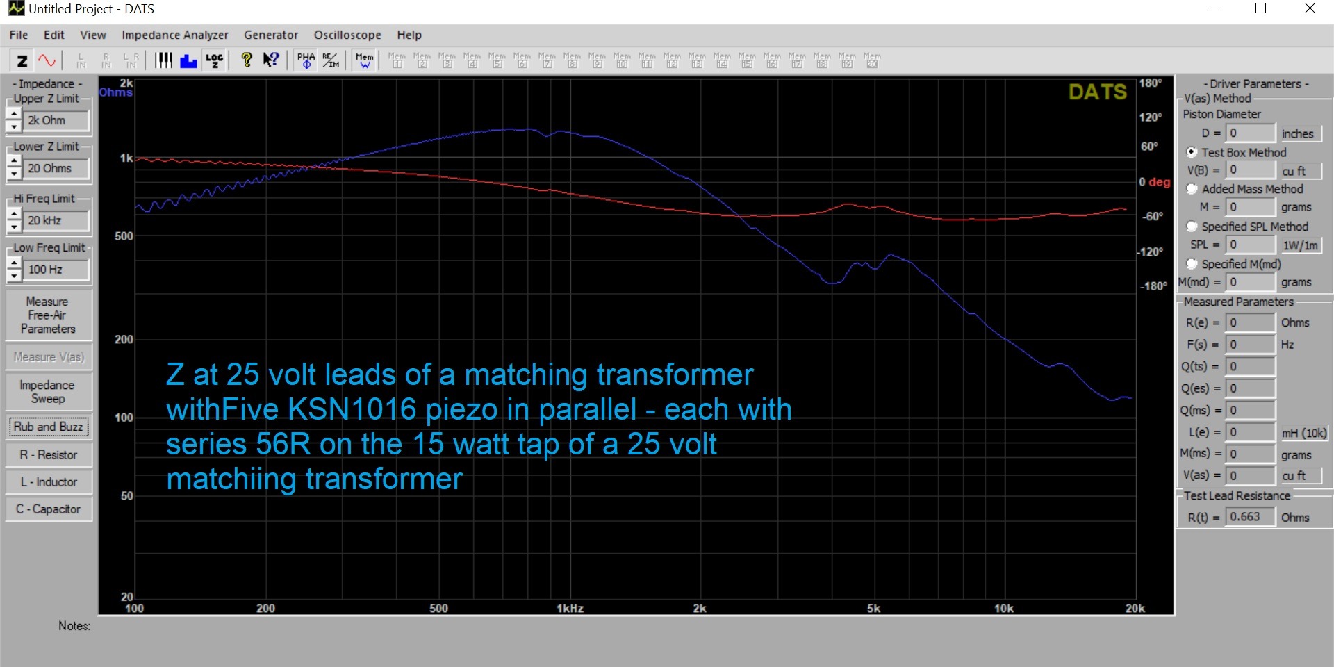

I ended up running the tweeters with the 15 watt tap as the primary - sounds clean" but not "airy". The wideband is a Celestion K12H-200TC.
Z at 20KHz has dipped to 3.6 ohm using the 15 watt tap as the primary.
I'm running the piezo stack with 1.3uF to the primary (blue-gray)

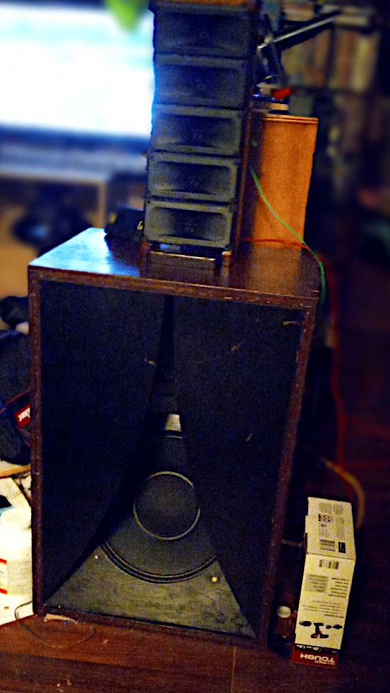

I like the sound of this array - no spit - good complexity- finger cymbals, hand cymbals, gongs - its great on solo acoustic guitars with various mics. I'm only about 4.5 feet away from the speaker. My other toys of interest are little horn rigs - Lordsansui's smallhorn3 and an 0.83 scale klipsch Belle. CD -are 1.4" Beyman and 1" DE250.
Here's the rest of the turns ratio info from my calculations, in case you want to play around some more:
Impedance data from here:
https://products.electrovoice.com/binary/5005, 5015, 5030, 5060 EDS.pdf
Calculations assume an 8 ohm speaker load in transformer's normal configuration.
70.7 V | watts | impedance | turns ratio |
30 | 167 | 4.57 | |
15 | 335 | 6.47 | |
10 | 500 | 7.91 | |
5 | 1000 | 11.18 | |
2.5 | 2000 | 15.81 | |
1.25 | 4000 | 22.36 | |
25V | 30 | 21 | 1.62 |
15 | 42 | 2.29 | |
10 | 63 | 2.81 | |
5 | 125 | 3.95 | |
2.5 | 250 | 5.59 | |
1.25 | 500 | 7.91 |

Assuming the array is around 96 dB
with all 5
Seems like a ratio around 1.5 to 1.8 would
be needed to get up to 99 / 100 dB
Looking at the great calculations done by mattstat
the 30watt or 15 watt ratios on the 25 watt tap
are gonna be the closest.

- I'd like to use this transformer as piezo stepup - which leads to use for the "8 ohm" primary?
