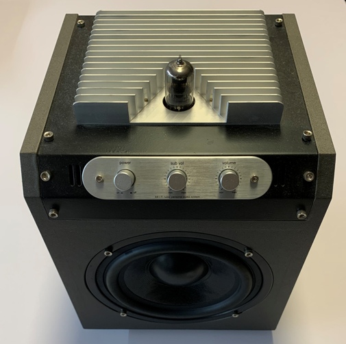

Abstract, according to your post #22 you are planning an active speaker with solid state power stage and high voltage vacuum tube gain stage. I've built exactly this type of speaker 15 years ago. The power transformers are inside the speaker at the bottom, the tube is a plain 6N3 triode gain stage (both sections are connected in parallel and powered by a high voltage power supply), the power stage is a chip amp bolted to the underside of the machined aluminium heatsink, the speaker port is on the back of the cabinet. The cabinet itself was a China sourced kit (Edfier maybe). I regretted this choice almost immediately, for several reasons. The main one: I quickly realised that strapping a triode to a solid state amplifier did not meet my goal. I like the sound of a full vacuum tube amplifier more. Then the cabinet was not the right shape for the driver I had, and due to the extra complexity of the built-in amplifier, the modification would not have been cheap or easy. Finally, the toroidal transformer had a little bit of hum but the placement inside the speaker made it much more noticeable. If you want to try a hybrid amplifier because you feel that a full vacuum tube amplifier is more difficult to build, according to my experience this is not true. On a hybrid amplifier, if you use the correct tube high voltages, you need two power supplies and you must use extra care to avoid damage to the semiconductor part. You also need a PCB for the solid state power stage. Compare that to the part count of many classic tube amplifiers: it is so low that you may even avoid the PCB completely. As example, there is a low power ECL86 / PCL86 single ended amplifier design with the same complexity level as many chip amps, that has been built countless times since the '60 when Mullard designed it, and still gives a good taste of the sound of a full tube amplifier.

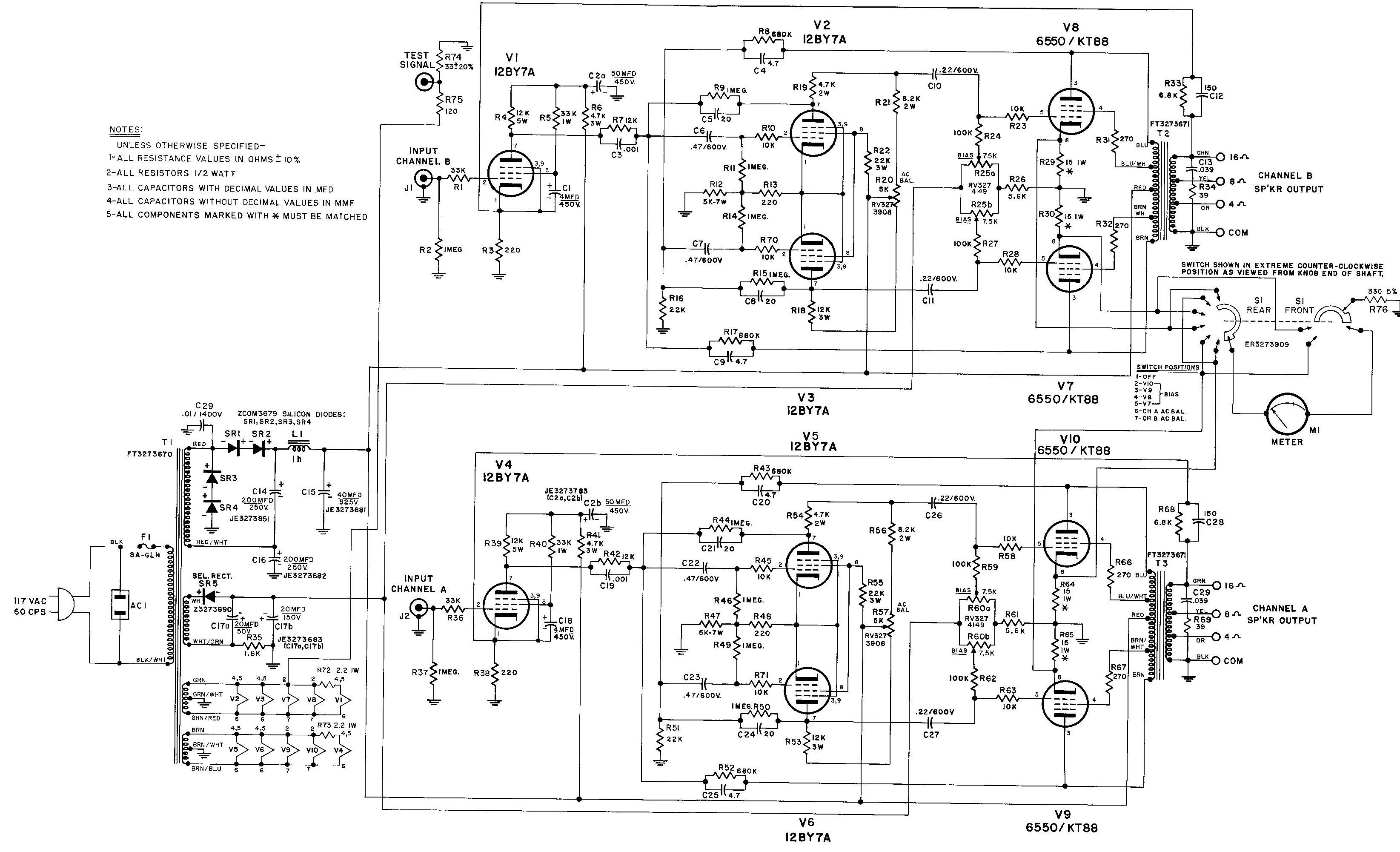

I'm trying to figure out what the "tube sound" really means. My pet theory at the moment is that a high damping factor is the main culprit. Once real-world delayed energy from the speaker and box (or horn, or dipole baffle, etc) are factored in, 'negative' feedback must become positive feedback at some resonant modes where the reflections are 180 deg out of phase.
An awful lot of any (tube or SS) amp's sound is design dependent. The H/K Cit. 2 has a pretty high damping factor and neutral voicing. The "Deuce" beats many a SS amp at their own game of bass performance.
JMO, well executed tube circuitry introduces a tiny amount of 2nd order harmonic distortion that the human ear finds euphonic, while avoiding odd order products that ear "detests".
The vacuum triode is the most linear voltage amplifying device developed, to date. The specific triode found in 6SN7s and other types meets HIFI distortion criteria, without benefit of any sort of NFB.
