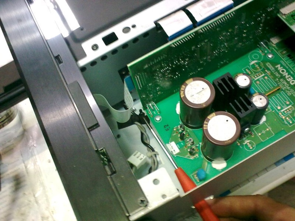

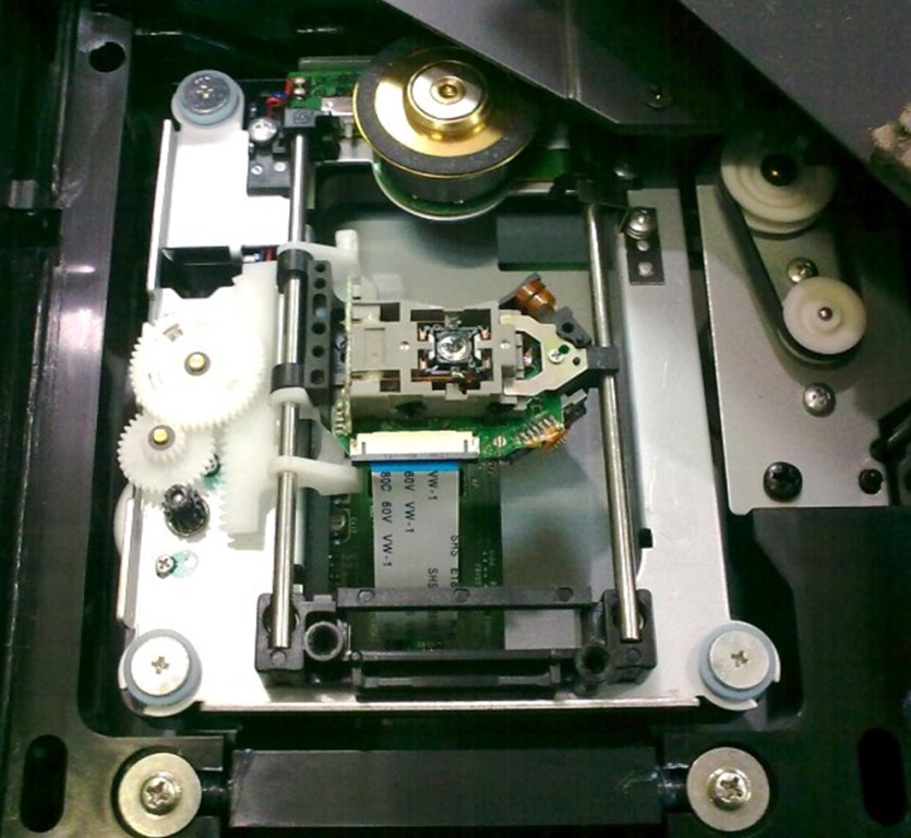

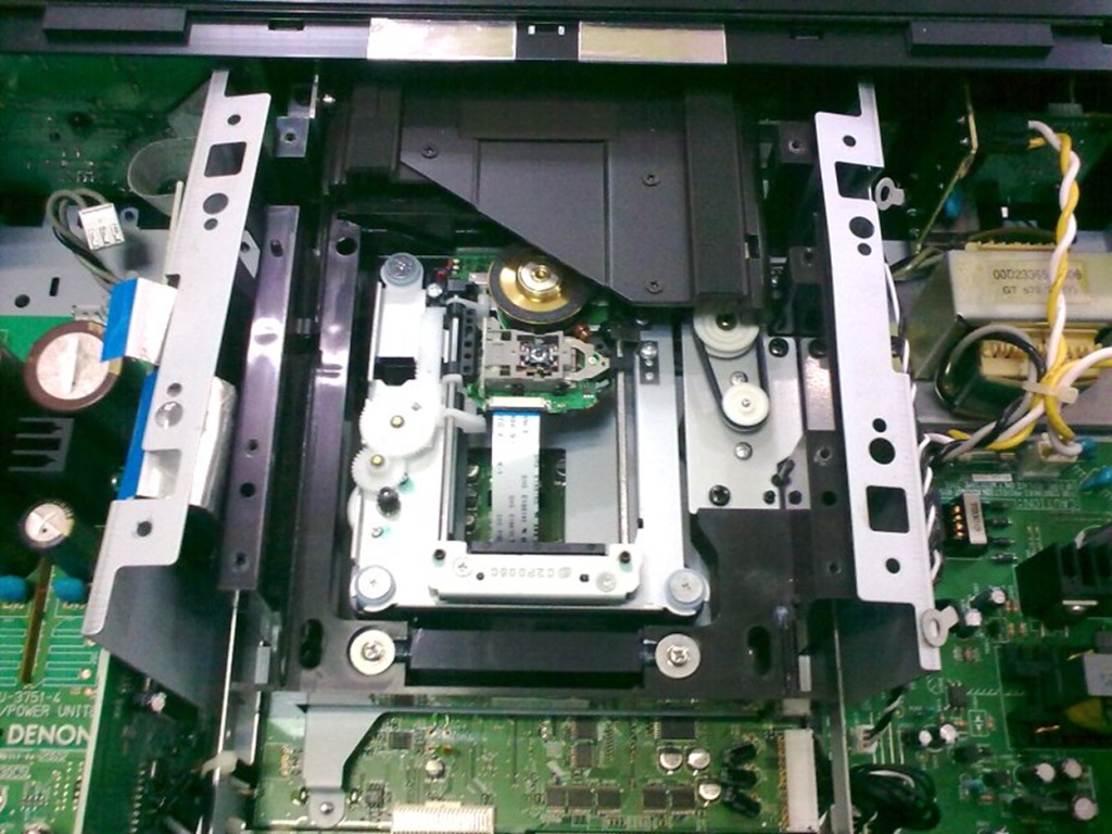

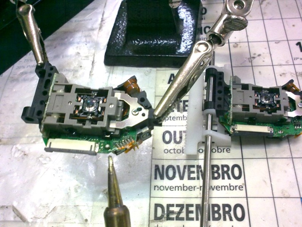

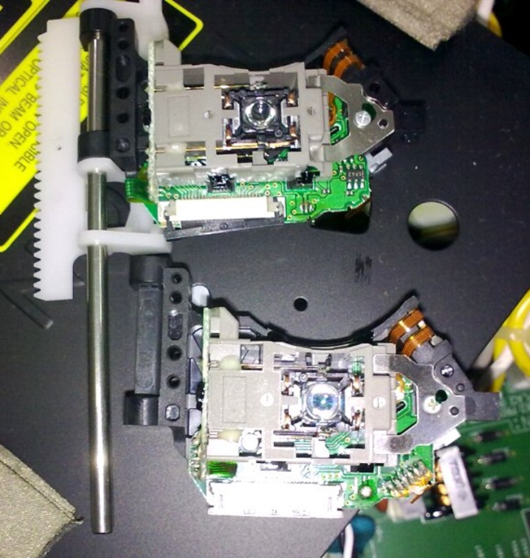

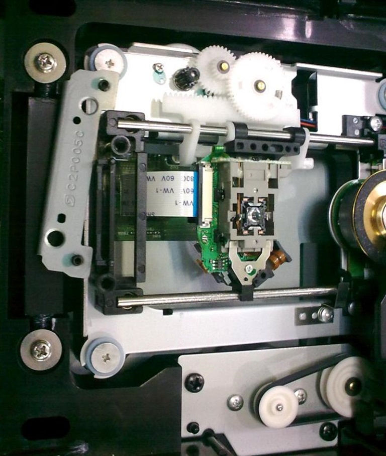

Hello Zozoe
First post on this forum(digital).

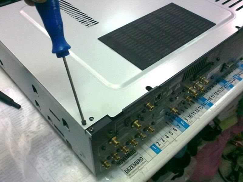

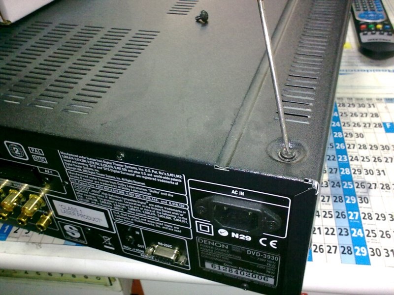

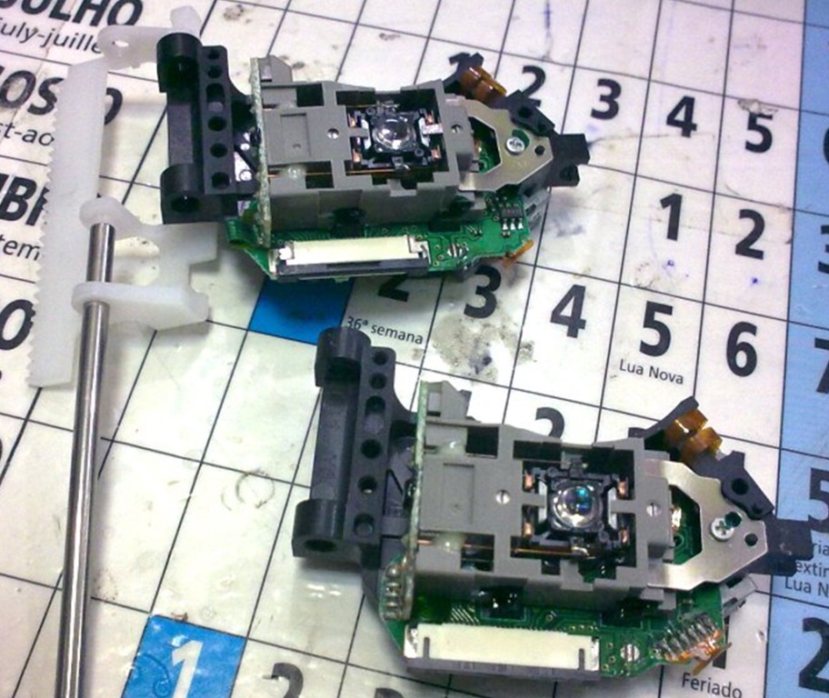

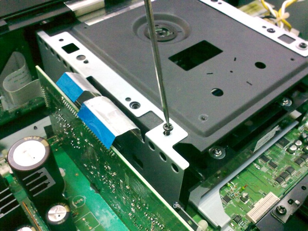

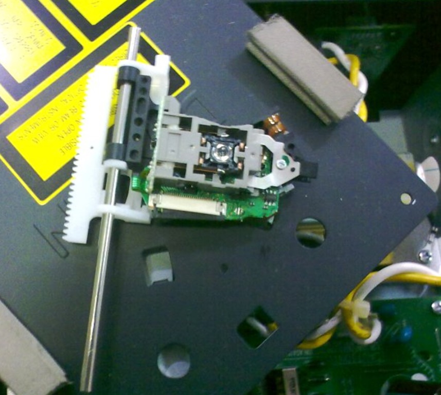

I have the EU version of the 3930, and already have changed the laser.
The laser is a Sanyo SF-HD65 (ebay is your friend).
In atach you will find the text and fotos of a post from a portuguese hi-fi forum where it is explained how to do the laser replacement.
It's much easier than it looks.
Good luck, best regards.
Carlos
