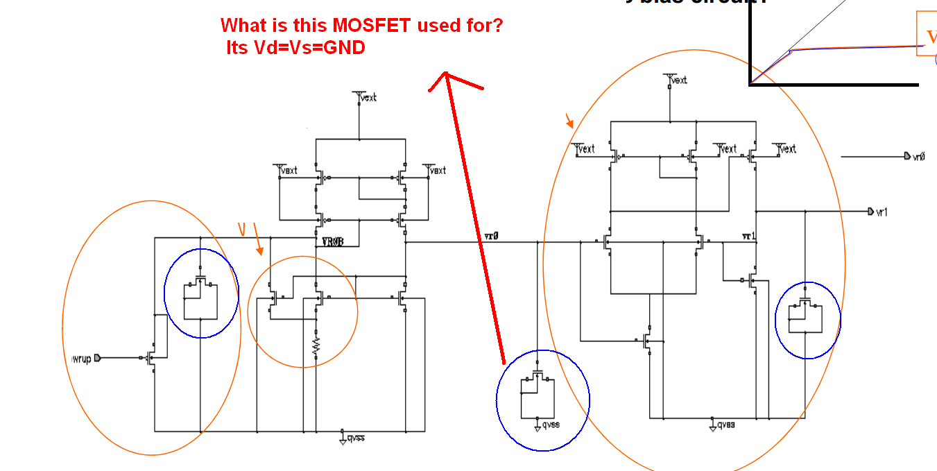

See the parts circled in blue below. Is that what you mean by "reverse biased mosfets"?many are reverse biased mosfets
P.S. Nevermind the extraneous question in the pic - I swiped the pic from an unrelated thread in another forum.
Even so, it seems an interesting question. My first thought is that they are using the gate capacitance of the MOSFET as a high frequency stabilizing element, instead of using a simple capacitor. Perhaps, the non-linear behavior of the gate capacitance compliments the non-linear behavior of some other circuit element. However, I'm merely guessing.

FIRST... "reverse biased MOSFETs" ... what? There are no MOSFETs in 99.9% of all OpAmp designs. Even the very, very newest - no MOSFETs. Sure, in class D systems, MOSFETs dominate the output-driver section. Wisely. But not internals of OpAmps.
So, whatever cockamamie objection you have viz a vis MOSFET gate capacitance linearity ... just isn't valid in the context of what we're talking about re: OpAmps.
SECOND... I think there is "design envy" in the majority of people who endlessly diss modern well designed OpAmps. Someone here blithered "80 transistors when 10-15 would be better", which is just bullsnot. Every last transistor - and I mean every one of them - has a defined role, an action it performs. That reading an OpAmp circuit schematic is all-but-impossible (because of the remarkable number and type of exotic chip-scale circuit features that only IC designers need, or want), does not constitute a validation of dissing the design(s).
THIRD: I too designed analog ICs for a bit ... back when they cost many hundreds of thousands of dollars to make prototypes. The things being done today that make "modern" ICs so darn compelling relate to the process itself, and not so much the design. Design of course is critical - but getting repeatability in a whole manufacturing line has been the revolution. My original point was, (with the example 2 MHz minimum versus 5 MHz typical gain-bandwidth-product) ... those wide ranges are both historical, and to allow for fairly wide variation in substrate silicon characteristics. In practice, the actual GBP is much tighter. Just don't DESIGN close to the 5 MHz window! Assume 2 MHz, and every chip you insert in the circuit will work. As designed.

Do you think that a mosfet capacitor is formed via different technology, process or way in VLSI as opposed to a analog one ??.
Most probably yes. Ken Newton is right on the money. It however is not my area of expertise as stated before. In the references in post 68 youll also be surprised to find how high hfe pnp transistors are formed as well as many other passives and actives.

Actually if I remember correctly mosfet caps "can" be made even more linear than thin film, the trade off is voltage-coefficient.

Since you won't get specific, I will, using a very common chip for audio. There are two capacitors here (Figure 32). Are you maintaining that they're MOSFETs? If so, what are the "hiccups"? How would you predict that they affect the circuit performance? In all of the performance graphs here and on Groner's site, what are the experimentally determined consequences of these "hiccups"?

Well, there you are. Snarky answer containing no value. Also, no schematics to demonstrate. I found exactly ONE schematic after some looking about that references an on-chip capacitor to act as a frequency compensation component - above 1 MHz, as per the ancient 741. And it isn't a MOSFET capacitor, reverse biased or otherwise. Indeed ... the majority of older OpAmps had separate pins specifically for external compensation capacitors - because there was a particular spot in the circuit where they would best be connected.
Point is ... your MOSFET capacitor theory of badness ... appears to be without support or basis.
