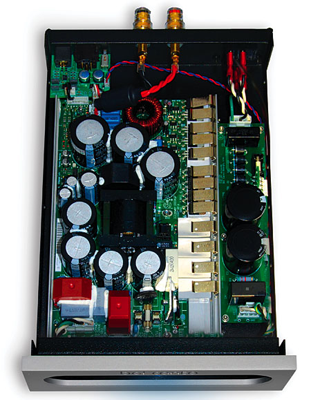

Does Anyone have the schematics of this power supply module that Bel Canto have fitted on their revision of the Ref-1000 (MKII)
Looks like a small bank of capacitor a a few diodes....
Should this be some thing like the PFC (Power Factor Correction) PC1 from Jeff Rowland??
To me the PFC (And I'm not an Expert) sould bean AC-DC converter feeding the ASP1000 SMPS with DC (384VDC) if that correct?
Anybody can comment?

From the picture, it sure looks like that PSU on the right side is exclusively powering the low level input board in the top left corner.
The input board i most likely some kind of buffer and/or single enden to ballanced converter that takes care of the low impedance problem you mention.
Maybe you shold try to understand the connections between the two boards (look at the conector description in the ASP1000 manuals)

The input PCB is powered with +/-12V taken from P1 connector on the amplifier module (the power connector near the signal connector, red and white wires).
The PCB on the right side is either adding more storage capacitance on the mains side of the SMPS or is a PFC.

Thank You Eva but, that I was already aware of, but my question really is what is the ideia behind that input PCB (What is it consisted of) and for what?
And what's the ideia with the other input board before the SMPS? Is it a so called PFC board (Isn't really a PCF only an AC-DC circuit with a bank of capacitor on the AC side? Does any one have an example of schematics of a PFC circuit, or this board on BC's MKII or JRDG's PC1?
JRDG has a comercial product called the PC1 that is suposed to be a power factor correction circuit. It seems that on the MKII version of Bel Canto's Ref 1000, they use a similiar circuit.

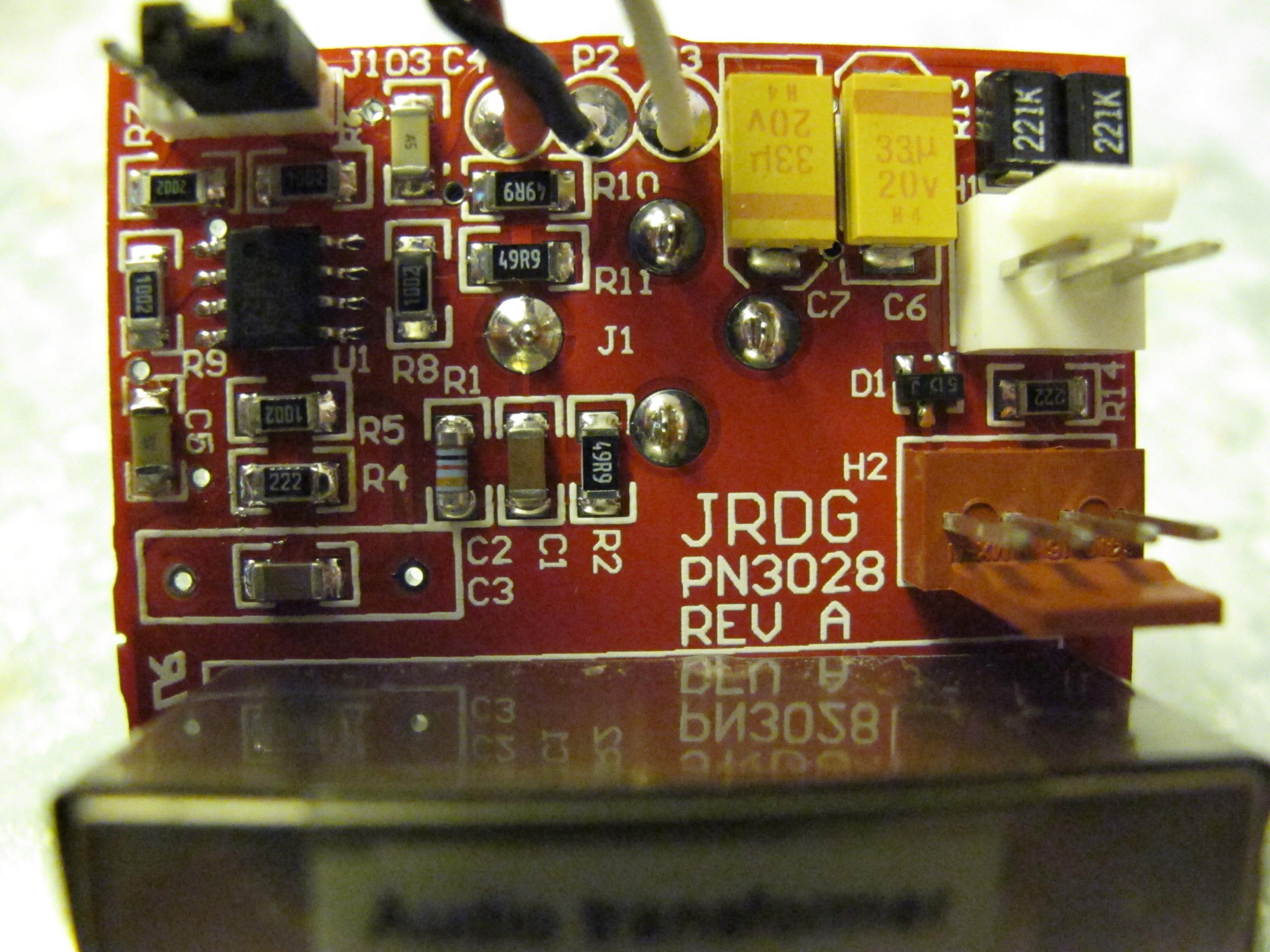

Every body says that for example Jeff Rowlands's Model 501 uses a Lundahl transformer, some claim that is a Lundahl LL 7902, but isn't that only uses if I want to convert for example e non balanced signal into a balanced one? Since model 501 has only available a XLR connector, if my assumption is correct then why would Jeff use a Input transformer that will only alter the signal?
Would it only be for galvanic Isolation? Or should it be to raise the input impedance of the ASP 1000? But in that case IMHO it could not be this model of lundahl since to acheive a higher input impedance witha line transformer it should be necessary to use a step down trafo and then use some kind of gain stage with amp op's, correct?
Look at this pic fo example:
Could it also be possible that JRDG uses a input trafo, to provide the possibility to convert an unbalanced signal to a balanced signal should a customer use a RCA - XLR converter in the case that the person as only available a pre-amplifier stage with RCA connections?
Of the shematics examples that are available at Jensen's site, in case you found that the use of a Line trafo would improve the ASP 1000 sound, wich of the examples would you recommend?

So it's a confirmation that JRDG uses a Lundahl 7902 input transformer and it seems that there is some kind of gain stage also.
http://review.u-audio.com.tw/reviewdetail.asp?reviewid=120
What is that metalic box that is near the IEC connector?
Does anyone have schematics for such a circuit using the LL 7902?

for cloning the jrdg input stage use L4 R2 config in 7902 datasheet , from R2o/p apply the "Optimum termination for best squarewave
response' the bal signal then feed into an instrumentation amp, consist of an opa2134 and 3 resistors .the opamp is supplied with +-15v ,by pass 100n ceramic smd cap.............................😎
