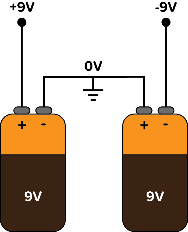

I bought 2 Meanwell LRS 200-36. Is there a simple way to get a +36V rail? and a -36V rail?
Also, considering the amps are 160W, is it OK If I use 2x 100W psu?
