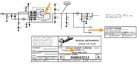

You do know this isn't just a PSU but a complete power amp, right? Fender has just .....
No, that's a different ICE part. This is an ICE power supply with a Fender design TDA2050 power IC for the audio path.
Don't TDA2050s sometimes fail in stage-amp duty? How do we know if it is the audio amp or the power supply?

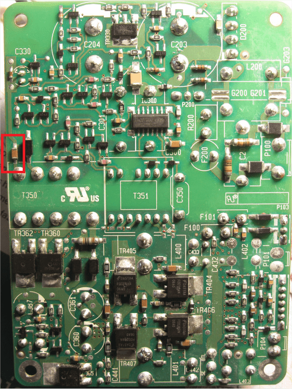

In case it may be of any help to others. I have received for servicing one of those IcePower PCBs. Not to mention that there are no schematics available, so some investigations are required if you have the will to go ahead. I first did some visual inspections and no aparent damages were on sight. Then I began to read some voltages and found that though the DC voltage on the main capacitor was OK, the supply voltage on the 3525 was 0 volts. It is hard to follow tracks on such a compact thing so I did some random measures and component tests to discover that the capacitor marked within a red mark was shorthed. This is, to my knowledge, an anti-spike filter. I did not have its value so as a typical value I used a 10nF cap which, to this moment, has been working fine. It is clear that bypassing the diode, when sorted, there was some kind of protection acting.

I'm know that this is a old topic, but I encountered a similar issue with my 125ASX. I noticed that the VCC supply was only 1.3 volts. Upon further investigation, I discovered that the small capacitor in the VCC supply had a reduced capacity. After replacing the capacitor, my board back to life. In the case of the 50ASX, it appears that C330 might faulty.

Pay special attention to this issue. Today, it is the second unit I repair with, exactly, the same problem. From a different customer and installed on a different brand equipment. Maybe a defective quality control of the component or another problem regarding design. I am not going to go any further but I think it is interesting to let you all know.In case it may be of any help to others. I have received for servicing one of those IcePower PCBs. Not to mention that there are no schematics available, so some investigations are required if you have the will to go ahead. I first did some visual inspections and no aparent damages were on sight. Then I began to read some voltages and found that though the DC voltage on the main capacitor was OK, the supply voltage on the 3525 was 0 volts. It is hard to follow tracks on such a compact thing so I did some random measures and component tests to discover that the capacitor marked within a red mark was shorthed. This is, to my knowledge, an anti-spike filter. I did not have its value so as a typical value I used a 10nF cap which, to this moment, has been working fine. It is clear that bypassing the diode, when sorted, there was some kind of protection acting.
