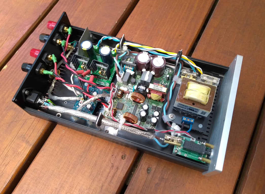

Well after a false start - buying a fake/faulty ICEpower module from eBay - I now have a genuine 50ASX2 module up and running.
Initially I connected it directly to my DAC, and it sounded quite good, perhaps a notch better than the TPA325x amps that I had been playing with previously. But I had a suspicion that a buffer would yield even better results, so I pulled out a Joachim Gerhard jfet buffer board that I had sitting amongst my collection of unfinished projects, soldered all those damn tiny SMD resistors, and gave it a good +/-15V power supply in the form of an LT3045/LT3094 regulator from ldovr.
Wow, the sound now has more authority and attack, and the soundstage is better defined. This combination is sounding great.
Here is my build, which includes the jfet buffer and associated regulator and transformer, all in the same chassis. I thought I was being clever to buy a Ghent Audio chassis one size larger than what they usually supply for a 50ASX2, but it ended up still being a tight fit, and I always seem to forget that wiring takes up space as well! For neatness and safety I made up some brackets which raised all power cables above the height of the main boards, while still keeping them sufficiently clear of the sides of the chassis.
In hindsight I should probably have given the buffer a separate chassis.

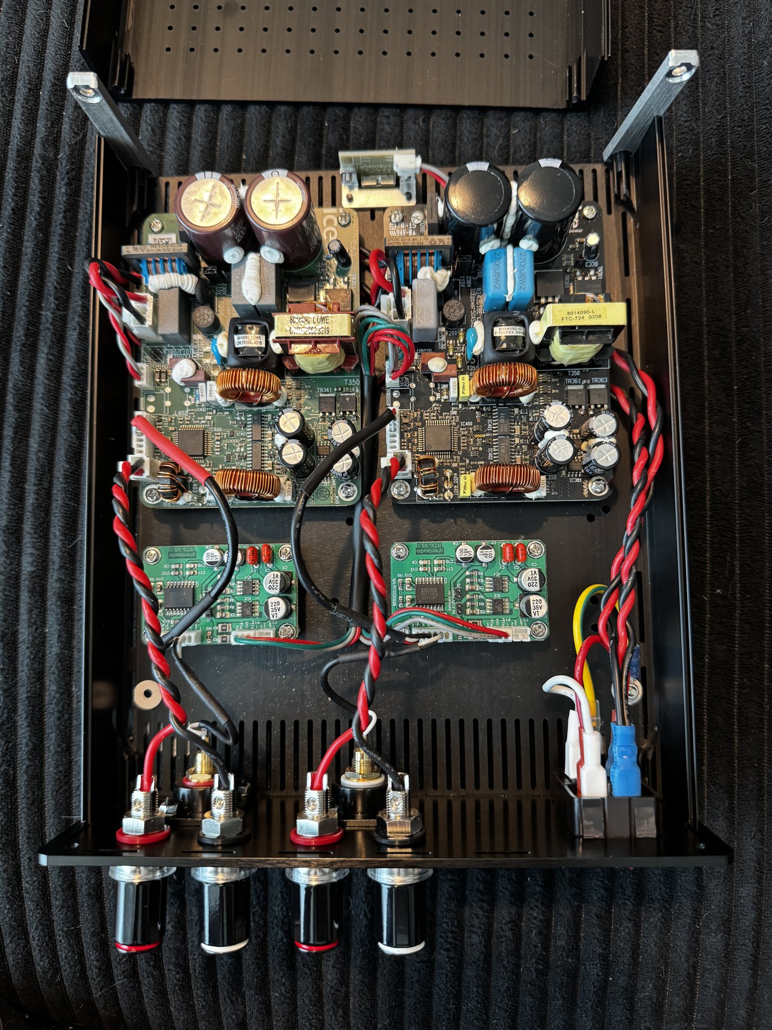

I realize this is an old post and I’m a bit late to the game, but I have toslink from my TV, feeding a Schiit Syn, (DAC is excellent) from there I have a Ghent case running two 50ASX2BTL modules being fed by the Ghent RTX buffers for Left and Right channels, that then feed to a pair of Pensil enclosures I built for Mark Audio Pluvia 7.2HDs. I have a single 50ASX2BTL with RTX module in a Ghent mono case for the center, feeding another Pluvia 7.2HD in a custom box, and finally a 50ASX2se in a stereo Ghent enclosure, feeding a pair of cabinets loaded with Mark Audio CHR50s. I am a career audio engineer, who has been in this hobby for more than 35 years, and this is the best sounding system I’ve ever owned. It’s shockingly good. Equally adept at TV, movies, and music reproduction. It’s even functioning as the home for my turntable at the moment, which has always resided in strictly two channel systems. I’m obsessed.
