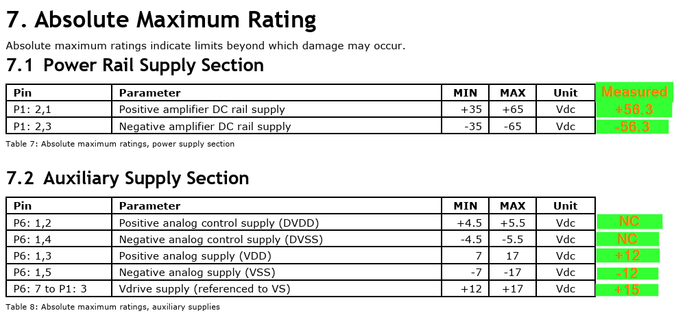

BEFORE I hooked up the SMPS to the amp module, I verified all voltages:

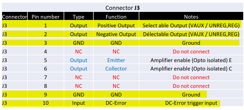

J3 (HIGHLIGHTED pins in use):
Perhaps I need to hookup J3:5 and J3:6 above? 'Amplifier enable (Opto isolated) E' and 'C'??? I could not find anything on the amp module that made sense to hook them up to.

Other troubleshooting steps tried:
-Removed ground from wall
-Removed all signal wires (plugs)
-Single module on rubber mat, only aux/power wires

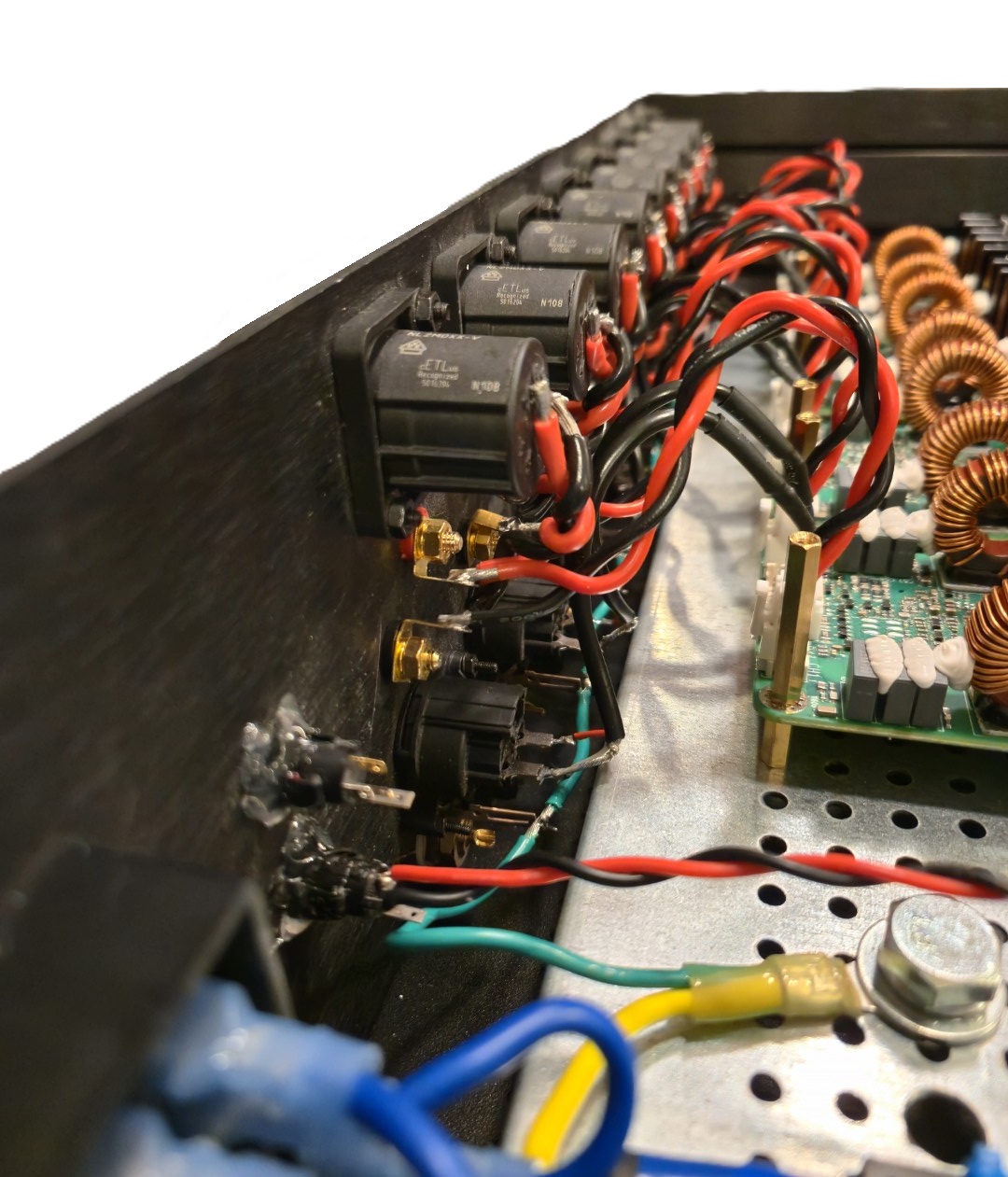

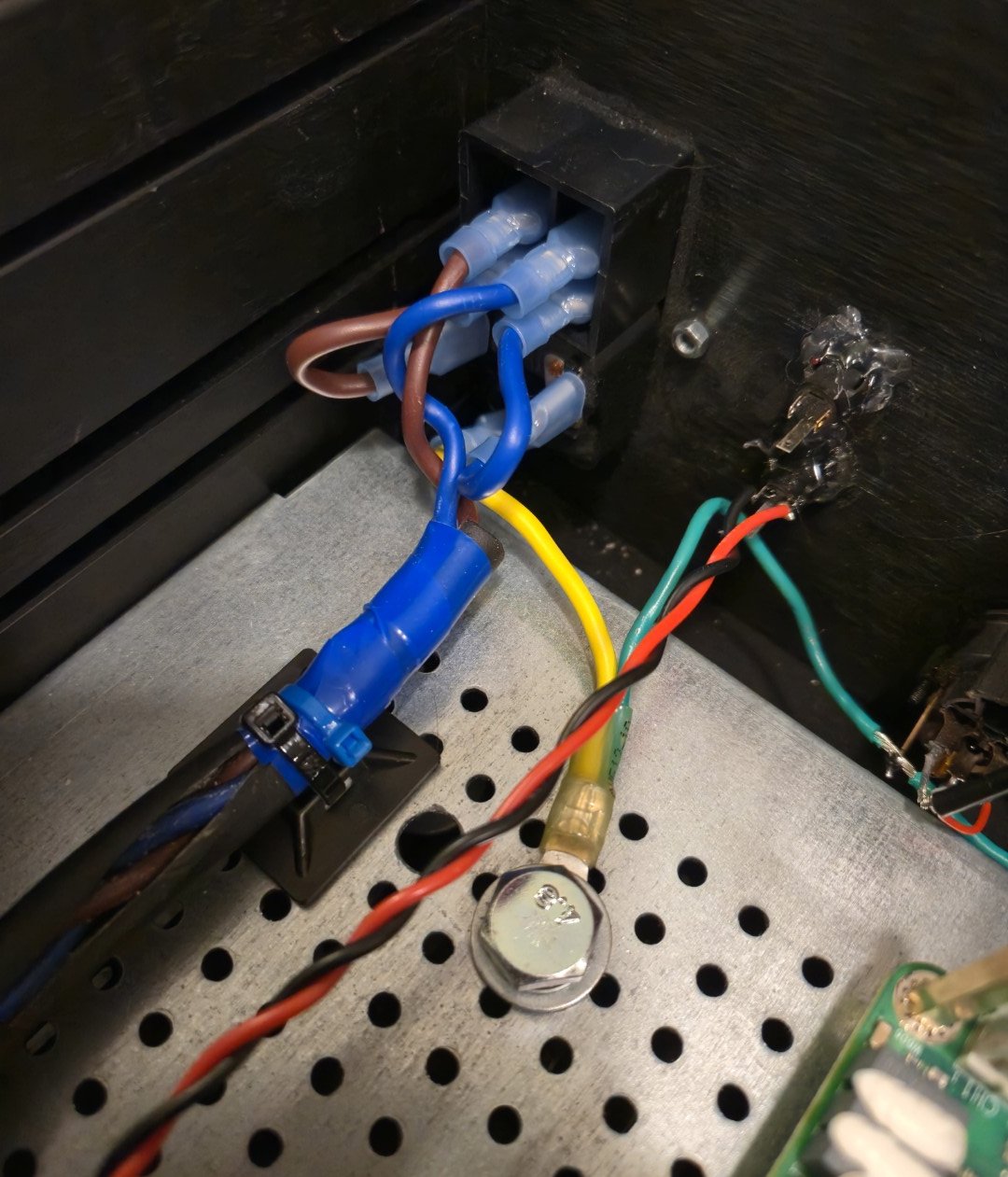

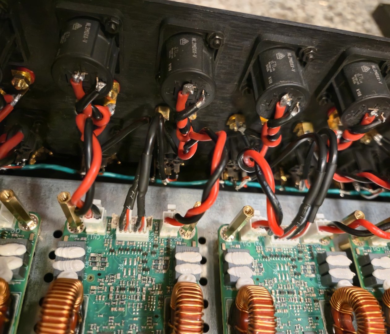

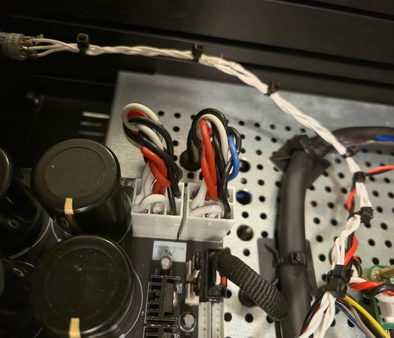

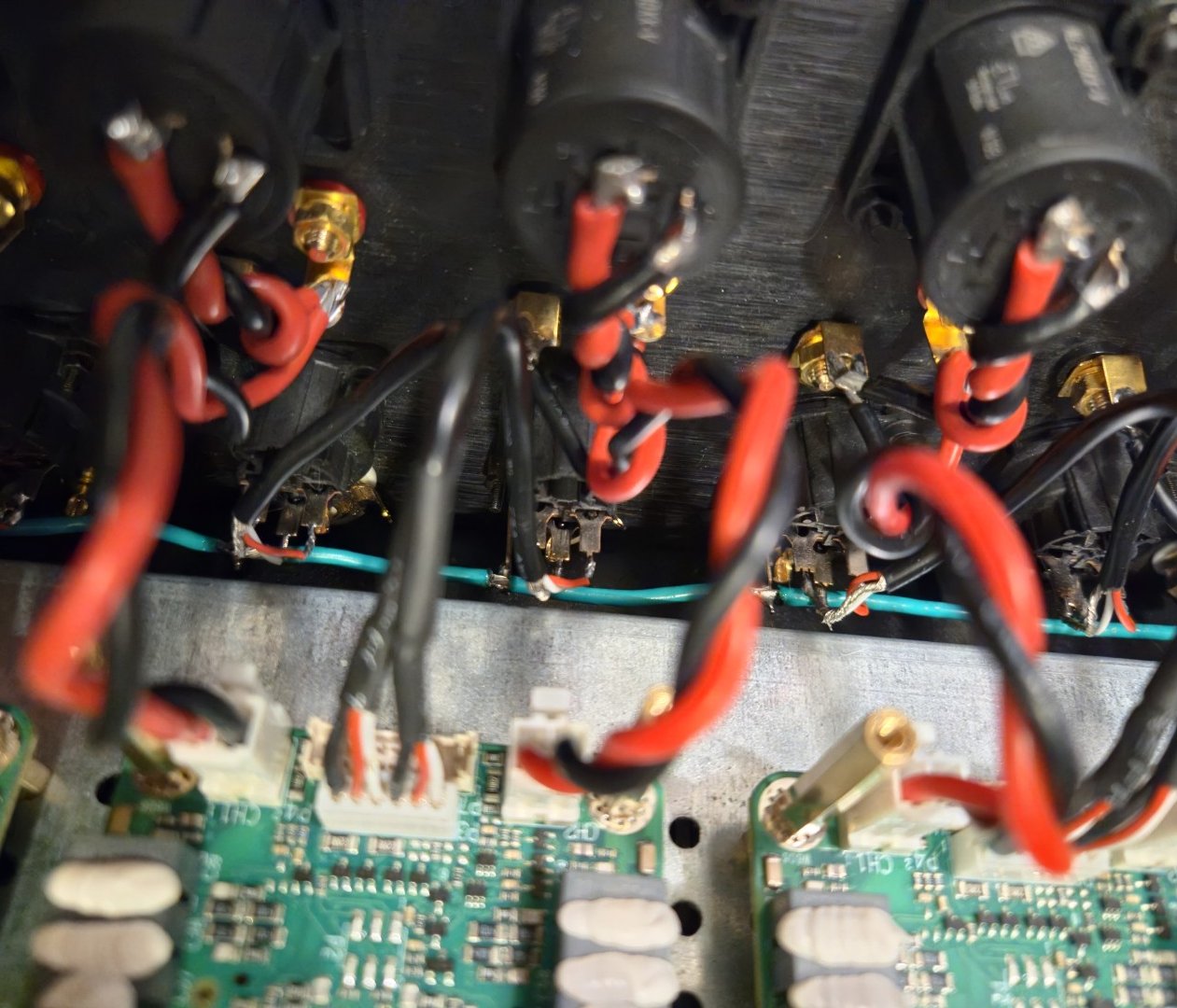

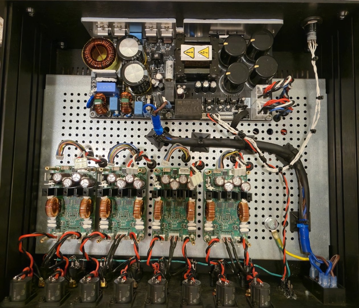

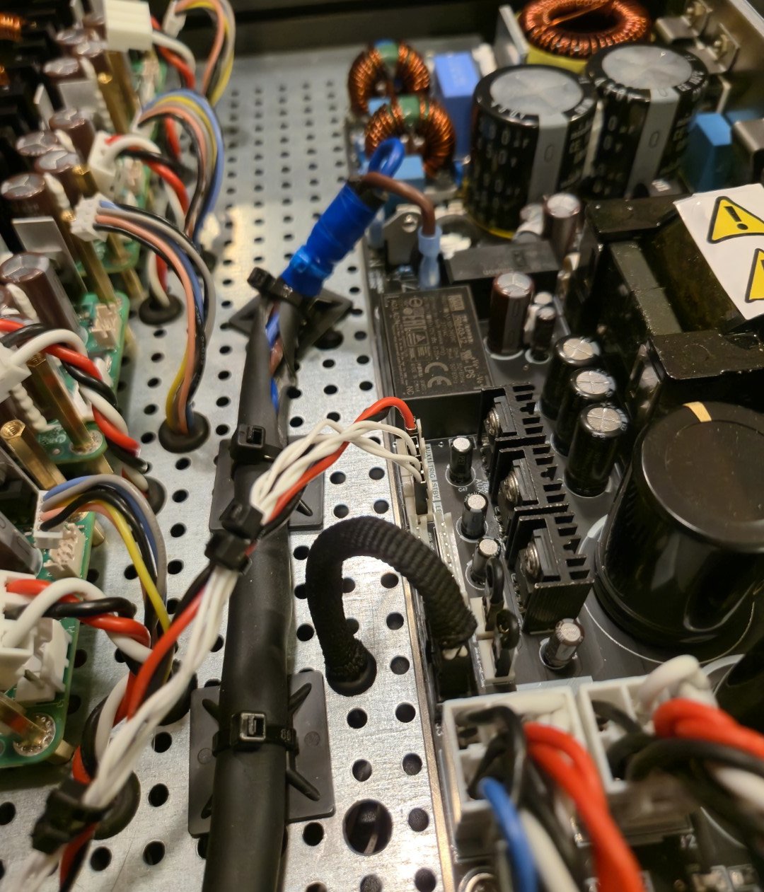

Here are pictures. Maybe they will help!

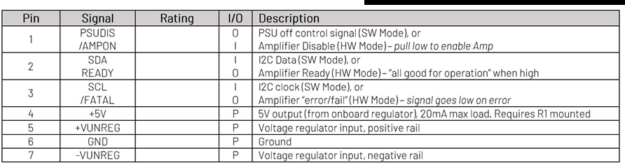

Power supply aux connector J4, pin 3, error.
Do you have anything connected to this pin?

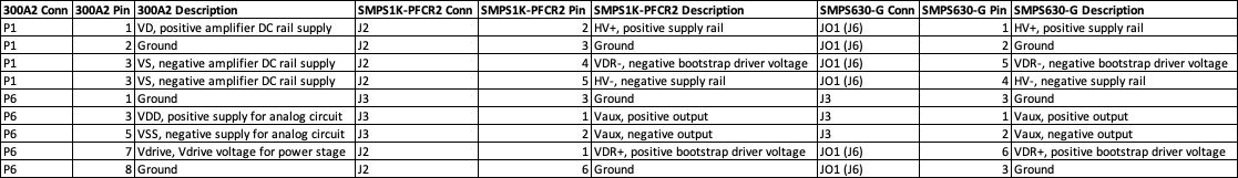

Been a while since I built a 300A2 amplifier, but here is the table I have in my files for use with the Micro Audio SMPS1K-PFCR2 and SMPS630-G. Only immediate difference I see is I was not using the DC error trigger input.
Michael
Michael
I don't think I used DC error. It would probably be worth reaching out to Sami to better understand how the DC error trigger input is meant to work.

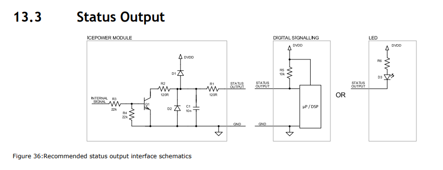

My understanding is that there should be a pull up resistor to pull the output "high" during normal operation as shown in the schematic below from the 300A2 datasheet.
Have you tried measuring the DC error pin on the 300A2?

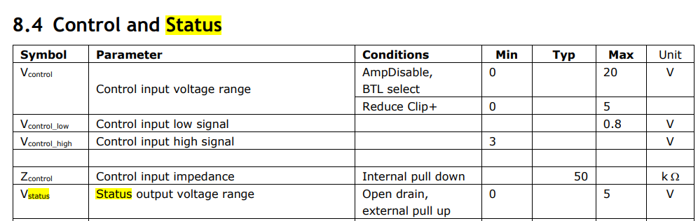

I agree that trying to use J4 pin 3 might be a good idea, I wonder if it pulls up to a different value than J3 pin 10. The 300A2 datasheet indicates the status output can only be pulled up to 5 V, it might be that the power supply is pulling up to Vaux (+12 V) and this is why you are having issues.
Michael

Thank you all for the replies. @mdsimon2 you have led me to the exact cause! Excellent analysis!
I did reach out to Sami at MicroAudio. He said the connections all were correct on paper, and to double check that's what I've actually implemented. Since I had already been down that road, twice, I concluded it must be something else.
I measured the DC Error pull up voltage on the Cobra-S2 SMPS, both on J4:3 and J3:10 (might be connected in parallel). What do you know, 13vdc! SO that is well above the maximum allowed by the 300A2 of 5vdc. Bingo.
I severed the DCerror connection and no problems now with the amps/system. I purchased a buck converter to lower the DCerr pullup voltage to something like 4vdc. I hope this doesn't cause issues or introduce any noise--it is a completely self-contained module, not requiring an external power supply, so I'm hoping that keeping it all within the same circuit avoids any problems. IF it needed to be powered by an external source, I would be concerned. I wonder if anybody has used a buck converter for this purpose before? I'll report back!
