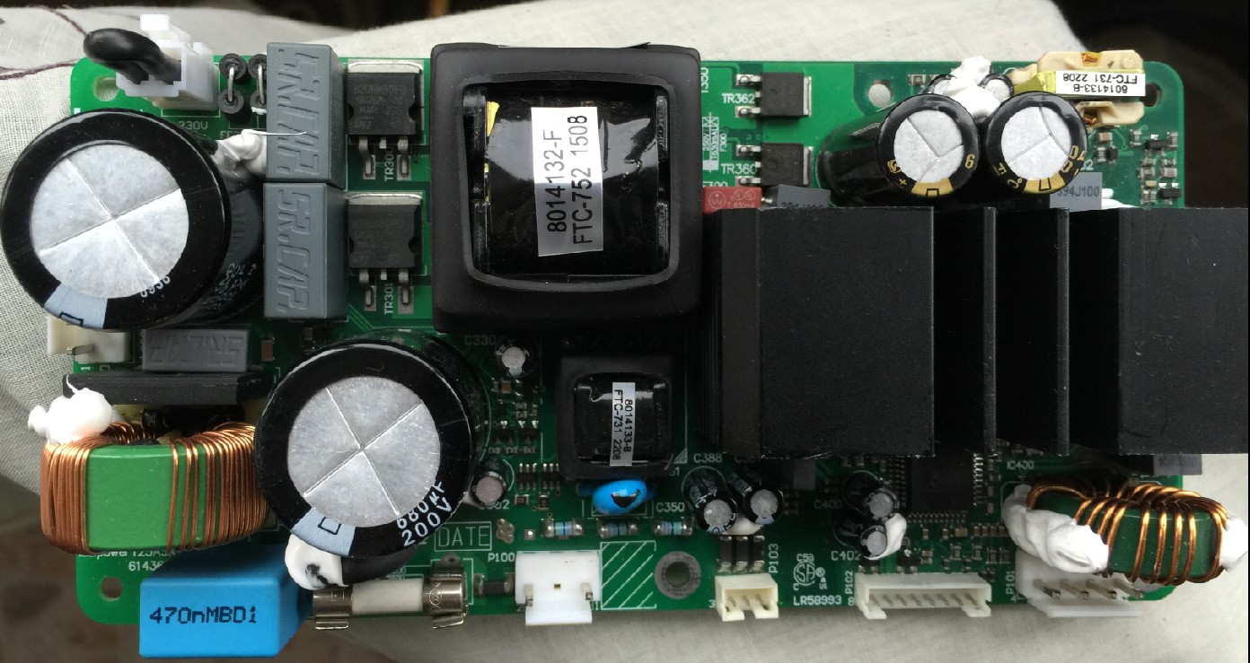

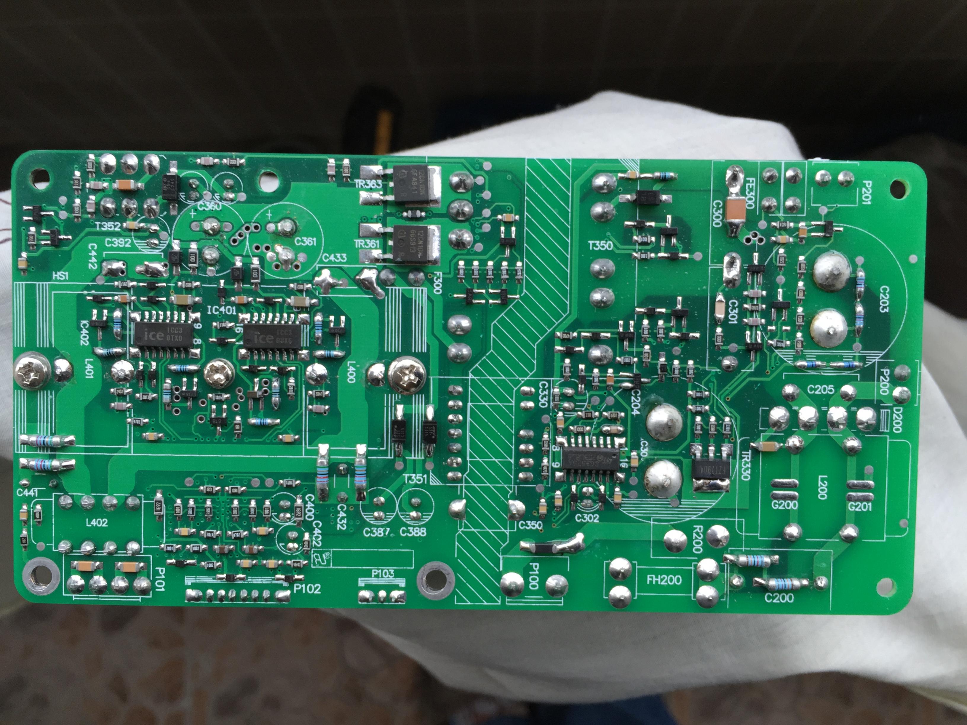

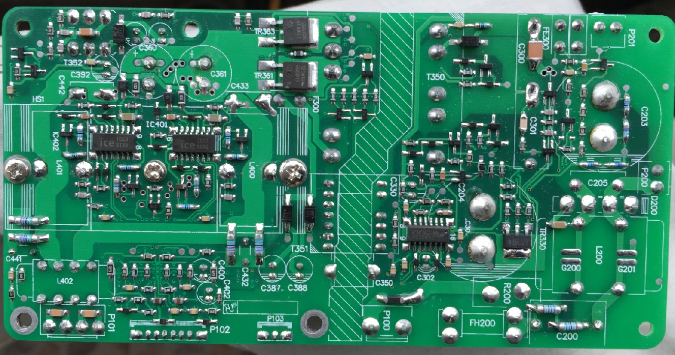

I bought 2 pieces icepower 125asx2 board online, but it looks like not the same as the official website shows!
please take a look, this is genuine or fake? thanks.
They look close enough I think. The pictures you see online will most likely be of older versions and so they look a bit different.
In order to fake the module, you'd have to fake the heat sink (which is a custom extrusion), rebrand the controller/driver chips as ICC1/ICC3 (custom ICEpower ASICs) etc. I don't think that's worth it.
There are obvious fake ICEpower A-series modules on taobao, but they look nothing like the real thing.

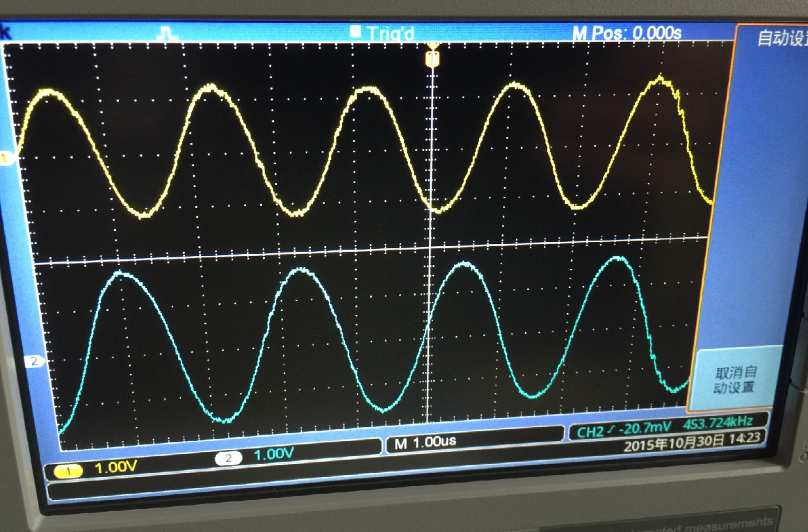

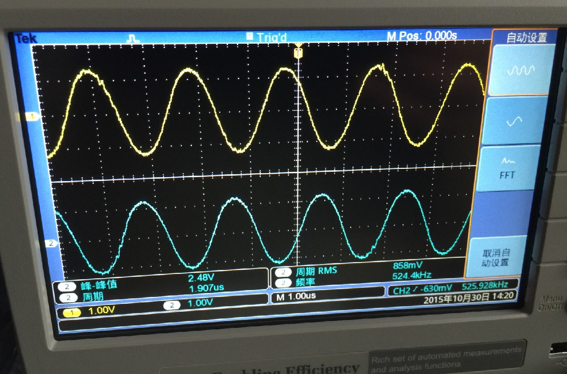

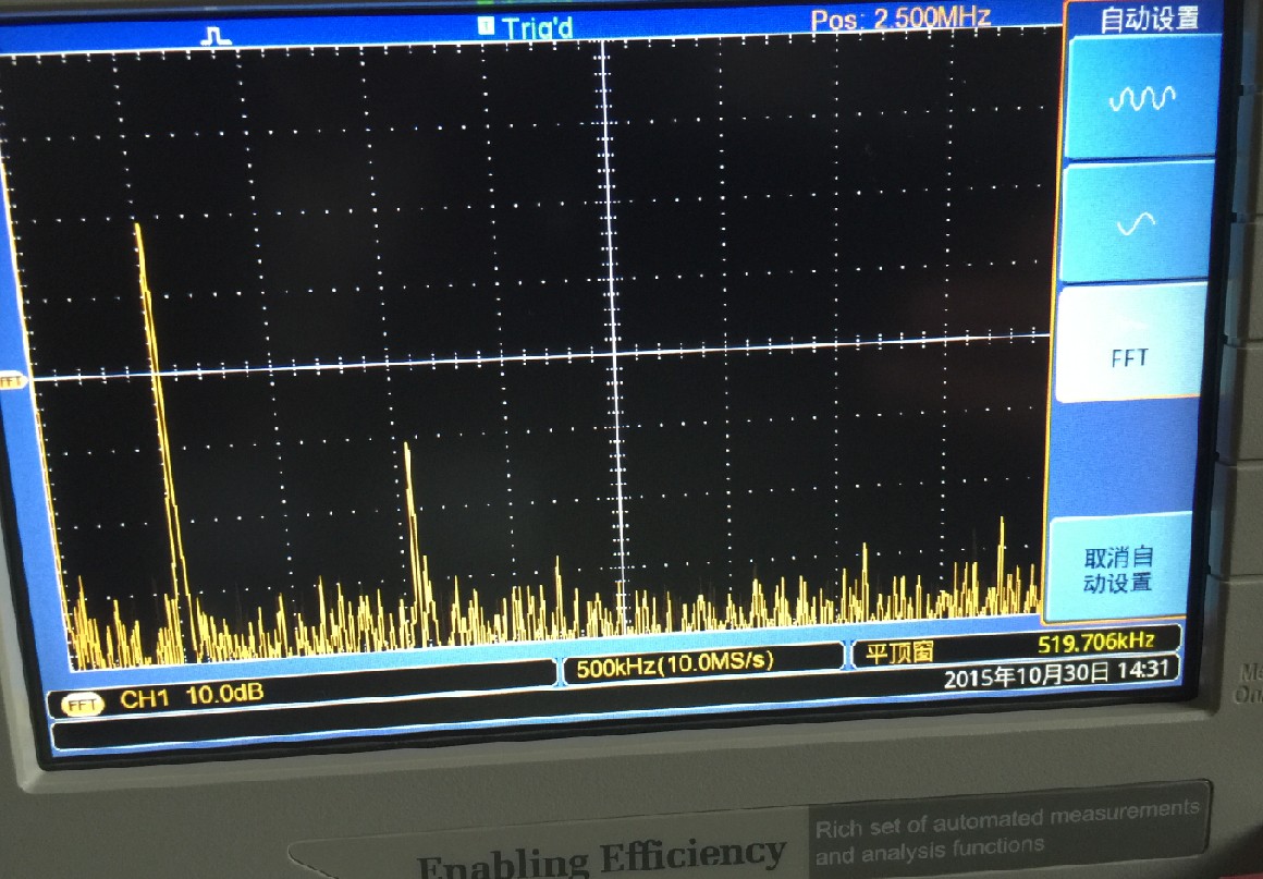

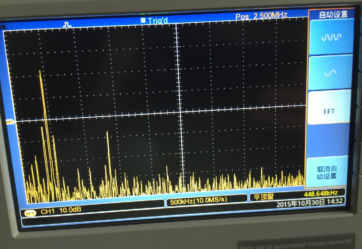

Oscilloscope images!
BUT. now I DO think it's fake one, fake technology by incredible!
please check oscilloscope image.

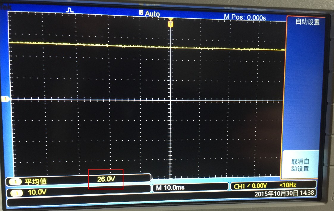

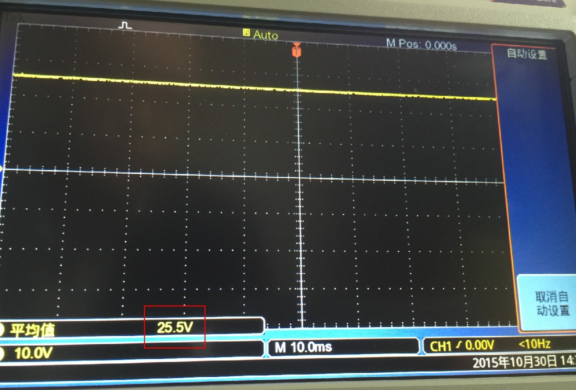

BTL model, output O+ and O-, +24v bus, tow pieces of A and B.

Please check the Font style
Based on the photos, I think these two boards are NOT genuine.
The Font show in the back side of the board is not correct.
Original Font adopted by ICEpower, since 500ASP, is a special "slim" type of font.
The font show in the back side of the board are more "rounded".
