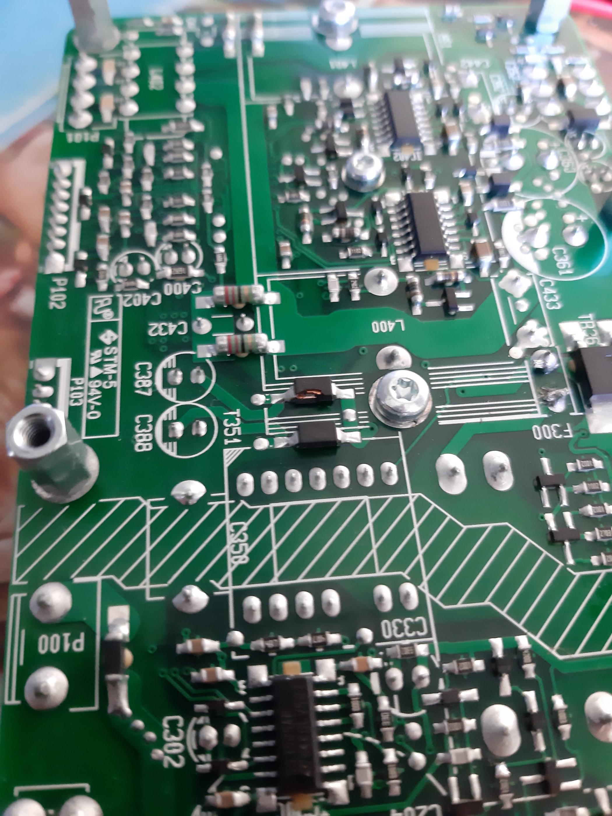

I still think this is caused by the fuses. Most often, the AUX supply (if not shorted) goes bad because the AUX power load has a large capacitor over the power lines. The inrush current to this capacitor when switching on, damages and then open the fuse over time.
The solution as recommended by the makers of ICE power is to add a 10 ohms , 2W resistor in series with the AUX power wires to your project. Also be sure not to exceed the rated AUX current (250mA for 125asx2).
The AUX fuses are not the 3 black things near to the connector, but a single red colored rectangle part of the other side of the heat sink, near to the main transformer. It's marked as F300 on the bottom of the PCB.
Fuses are available trough Mouser, Digi-key etc. Mouser order code 530-RST630-BULK

I made a very stupid mistake and maybe you could help me out.
I shortened the auxiliary power and in search for the aux fuse I used this thread. So far so good. But when I the fuse I noticed that this fuse was bypassed (by the previous owner...).
So I searched for broken parts on the board... I found one part broken (in the middle of the picture) but I can't figure out it's part number or value. Hate to admit it but I even don't know if this is the only part broken...
The amplifier bit does work fortunately.....
I hope you can help me...
