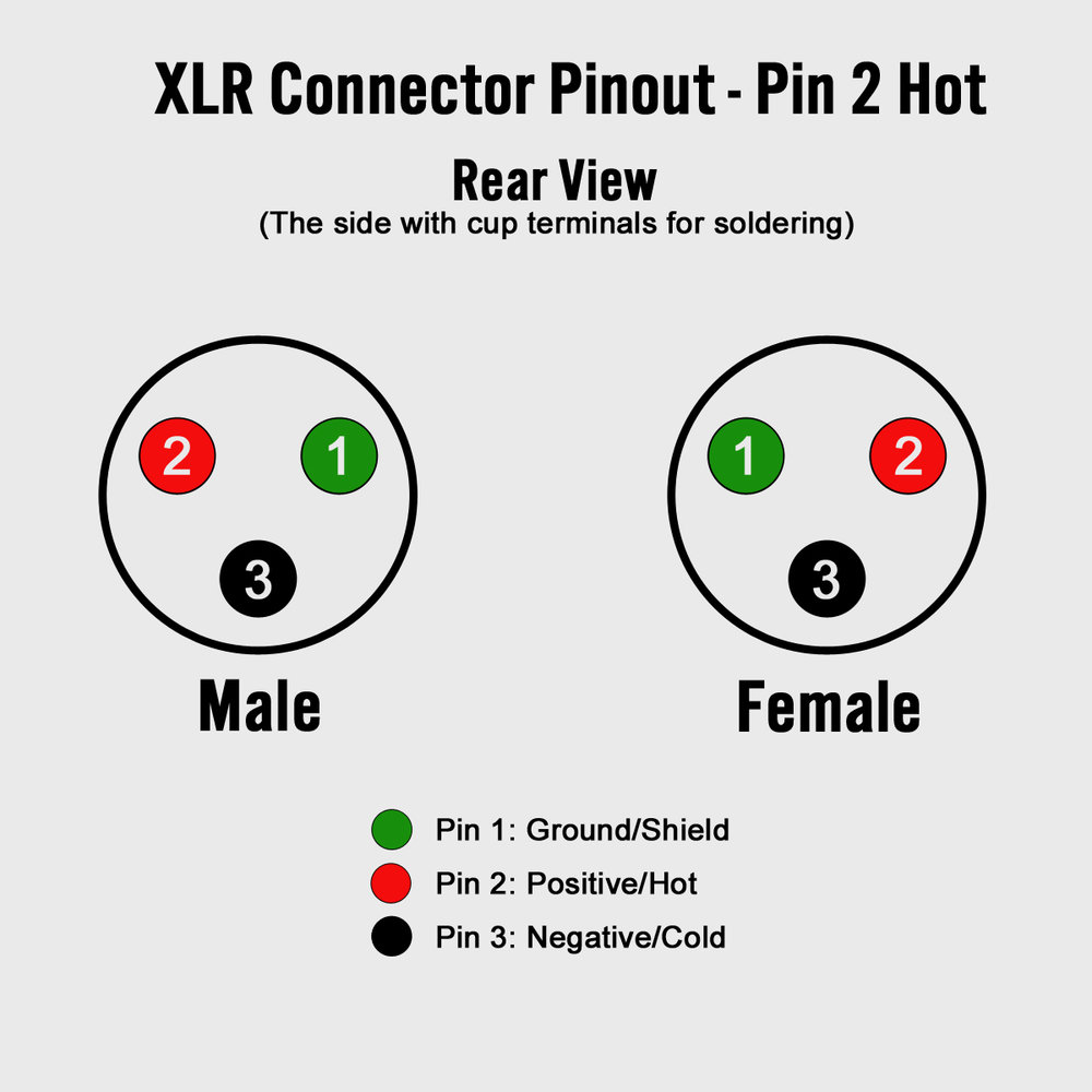

The Ncore NC122MP will be used in stereo and bridge (BLT) configuration.
From the picture in datasheed I do not fully understand how to connect the source to the amplifier in bridge configuration. I will use XLR input.
If you are using XLR from a true balanced signal, you already have two out of phase signals which is what the amp needs...
XLR 1 --> Ground
XLR2 --> IN+
XLR3 --> IN-

Ok, if I understand correctly i connect the preamp output on one of the inputs on the amplifier and reverse pin 1 & 2 on the XLR cable?

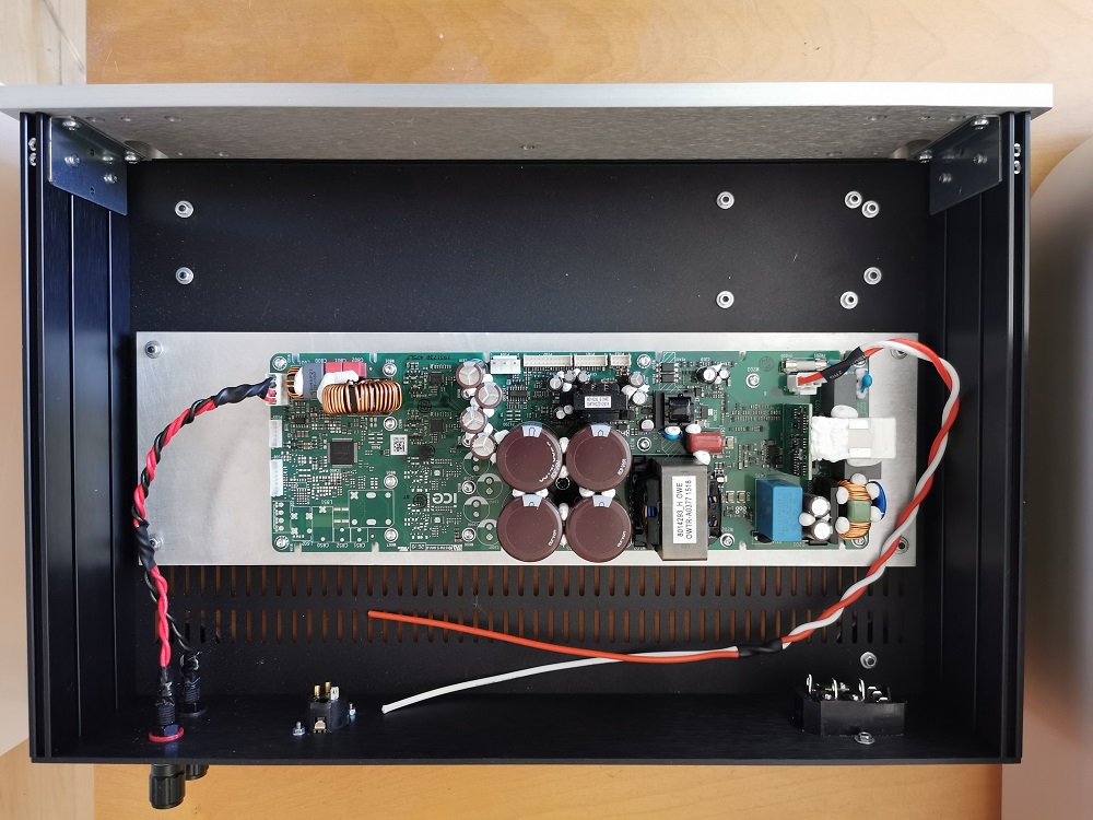

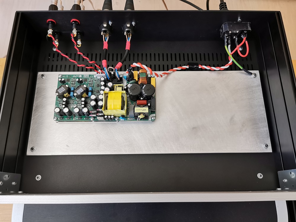

First Ncore is playing music. 🙂 One more to go.
Then i will start with Icepower 1200AS1 but i'm not sure if the main switch i have (250V/6A) will be ok for one mono amp.
