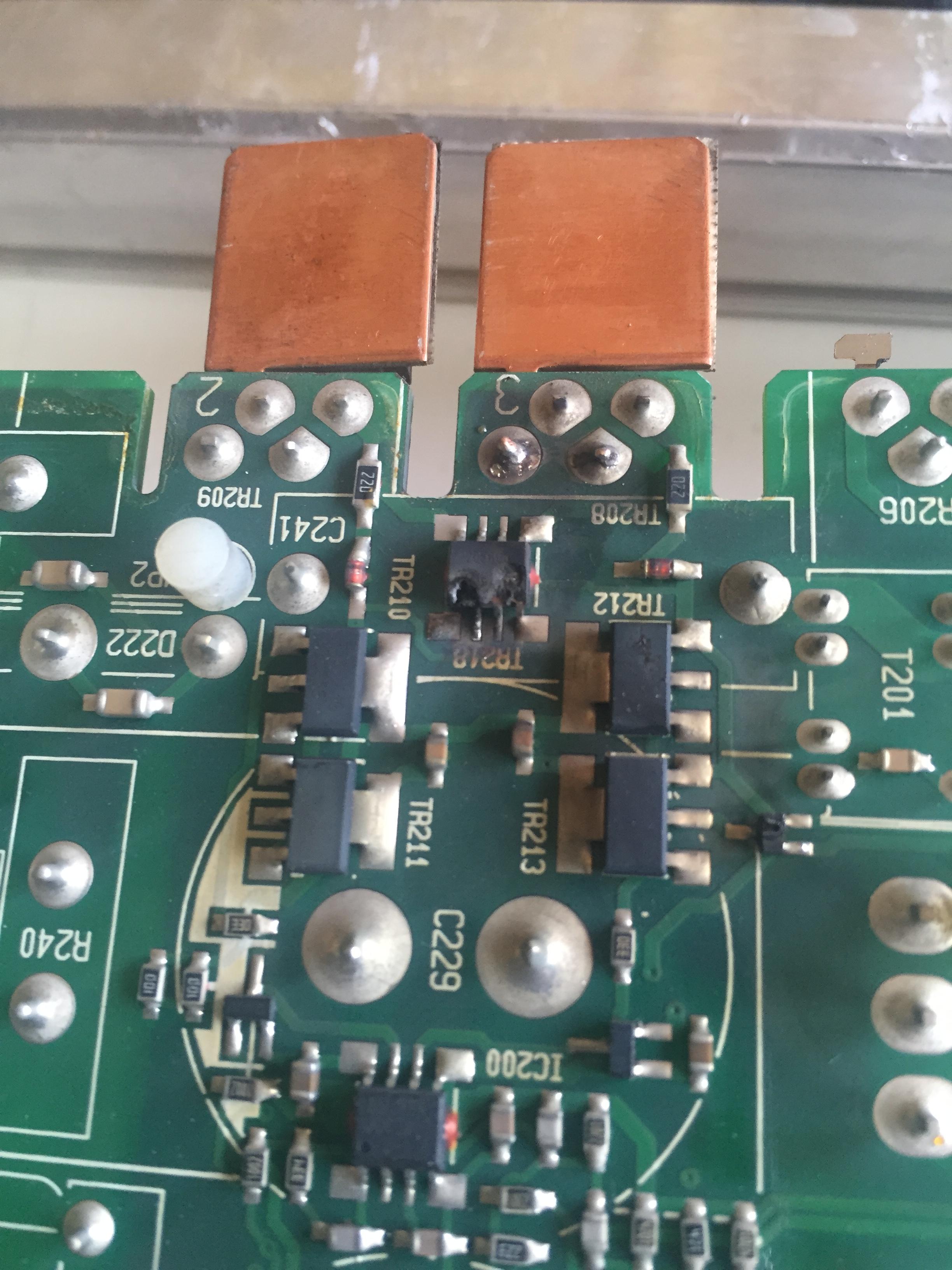

So far this is the only image I have found with an intact TR218, but I can't read the markings on the chip. From this German thread.

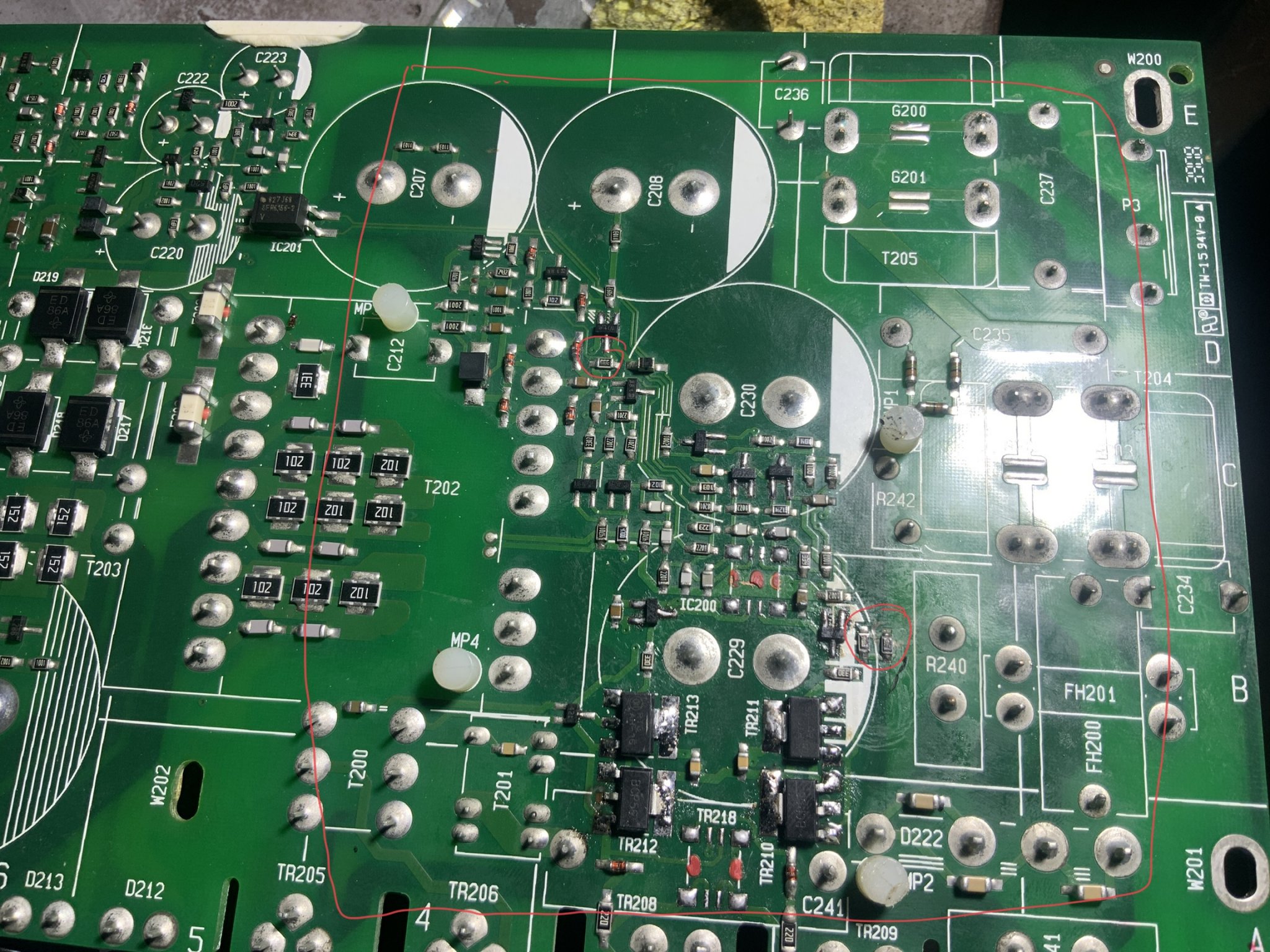

This Polish thread has a picture of the TR218 blown, plus a lot more.
TR218
TR218
TR218

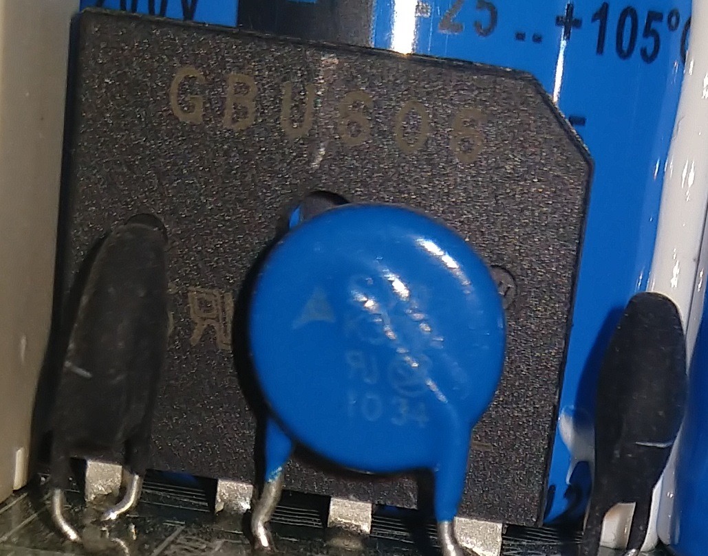

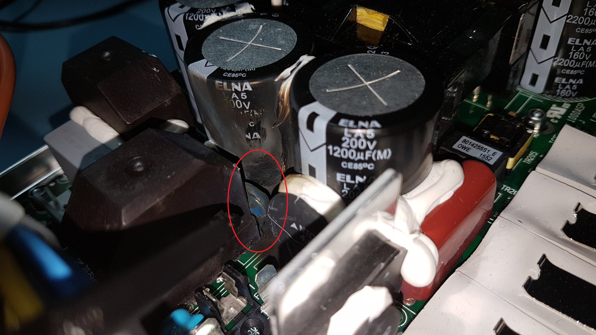

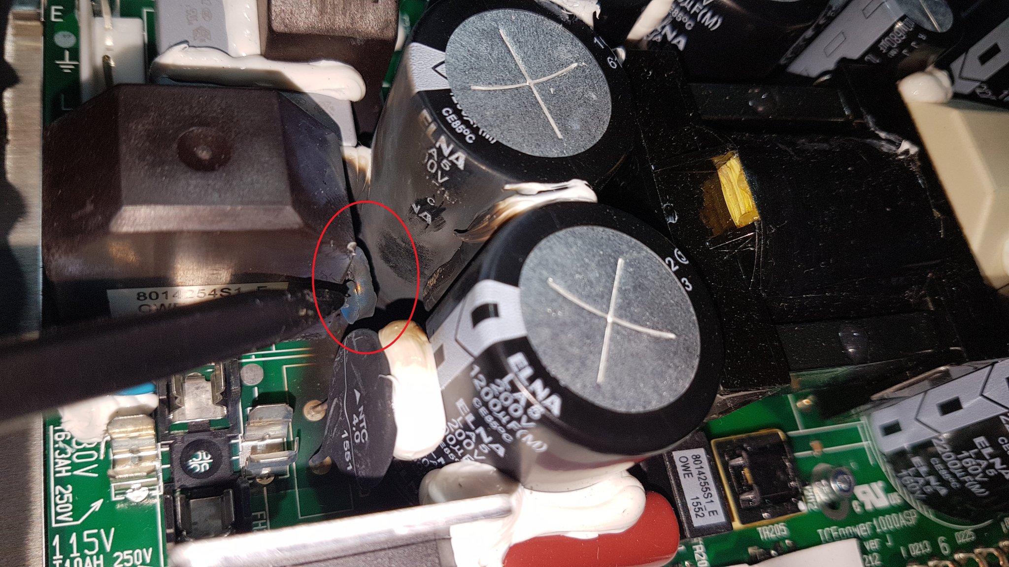

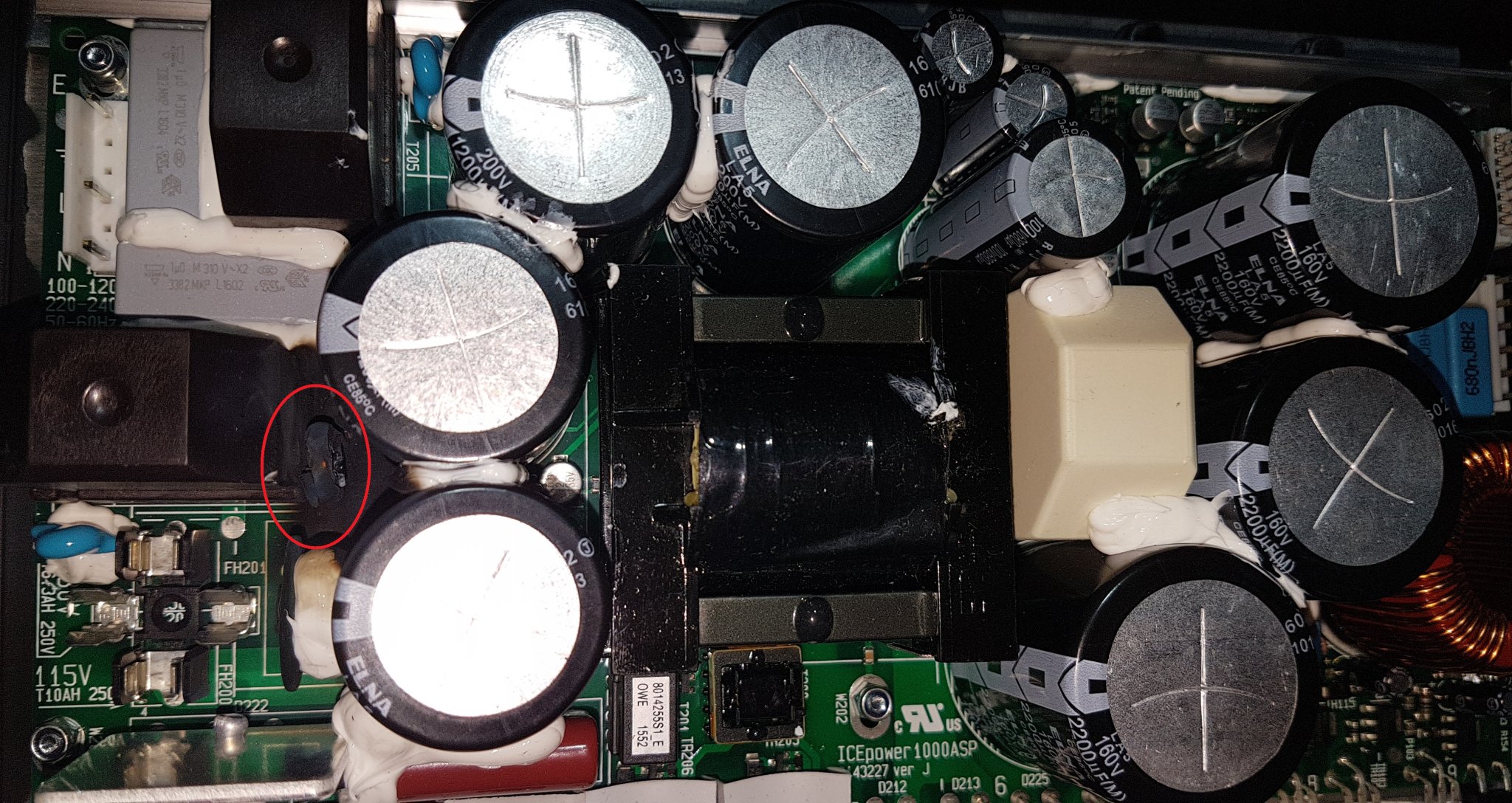

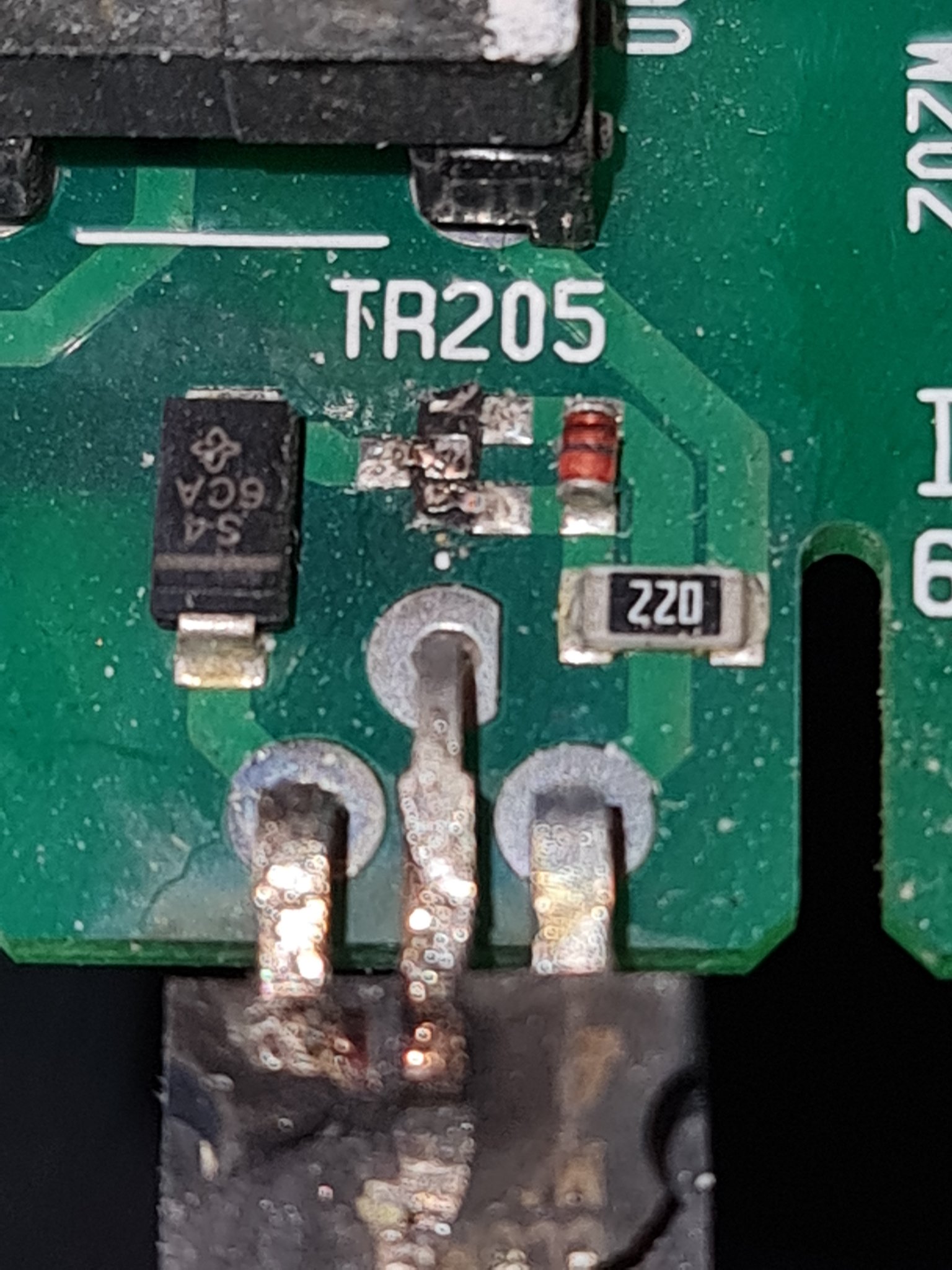

Hi guys! I would like to ask for your help. I have two icepower 1000asp modules, on which a PTC thermistor on the SMPS primary side has exploded. So unfortunately the value is unreadable. Could someone help me with the identification of this? A close-up photo, where the code can be read, would be very helpful. Thank you in advance!

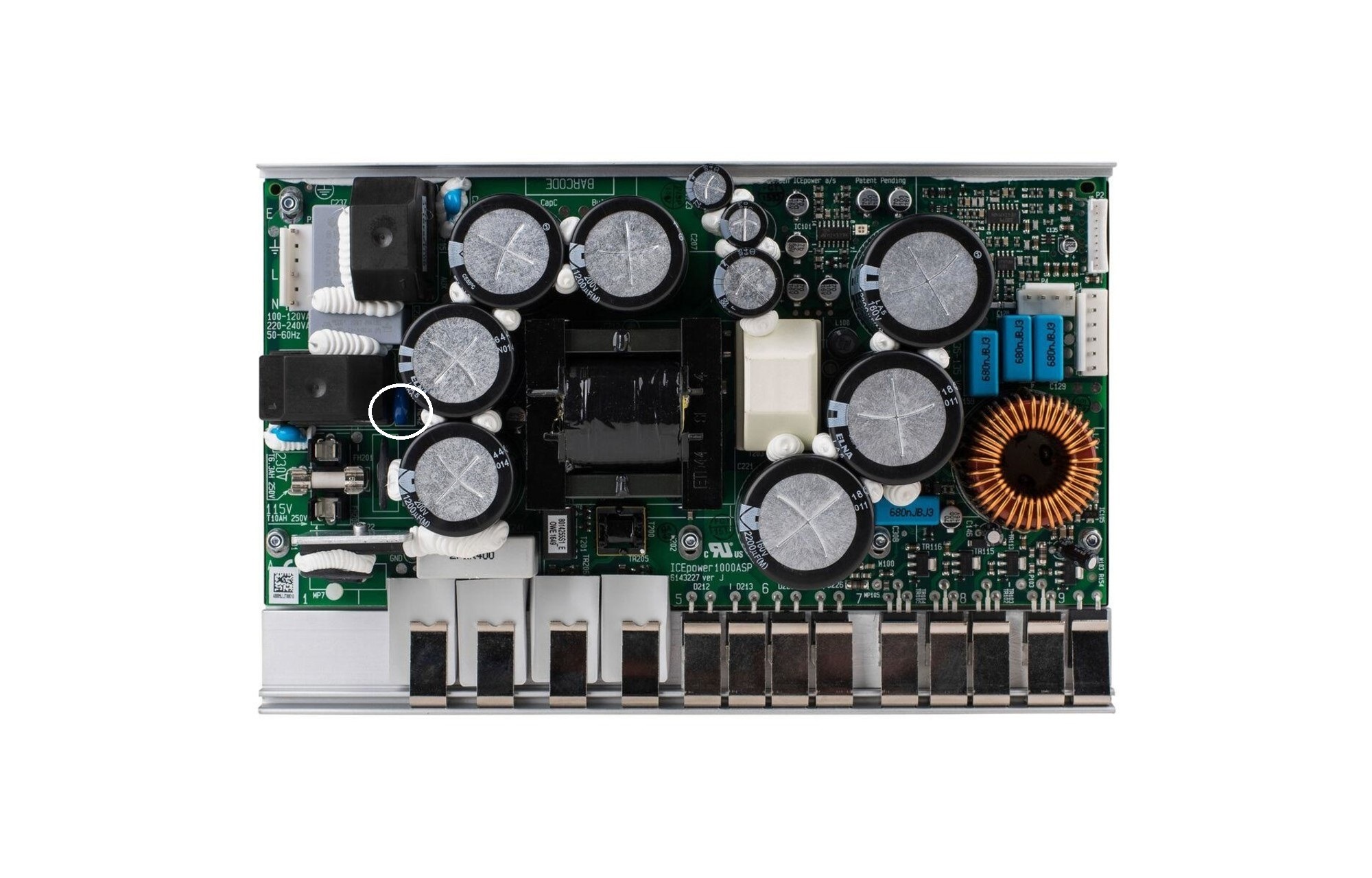

Mine is a 500ASP. In your photo, I can see the blue remnants of what looks like a MOV. In photos of the 1000ASP, it looks like a blue MOV in that spot. In my amp it's an Epcos S10K320. Likely the same part in the 1000ASP?Hi guys! I would like to ask for your help. I have two icepower 1000asp modules, on which a PTC thermistor on the SMPS primary side has exploded. So unfortunately the value is unreadable. Could someone help me with the identification of this? A close-up photo, where the code can be read, would be very helpful. Thank you in advance!
500ASP Epcos S10K320
1000ASP
Thank you for your reply! I disassembled the module to be able to measure it and, based on its position in the circuit, this should indeed be an MOV.Mine is a 500ASP. In your photo, I can see the blue remnants of what looks like a MOV. In photos of the 1000ASP, it looks like a blue MOV in that spot. In my amp it's an Epcos S10K320. Likely the same part in the 1000ASP?
1000ASP
I hope too 🙂I hope its sacrifice saved your amp.
Thank you for your help!

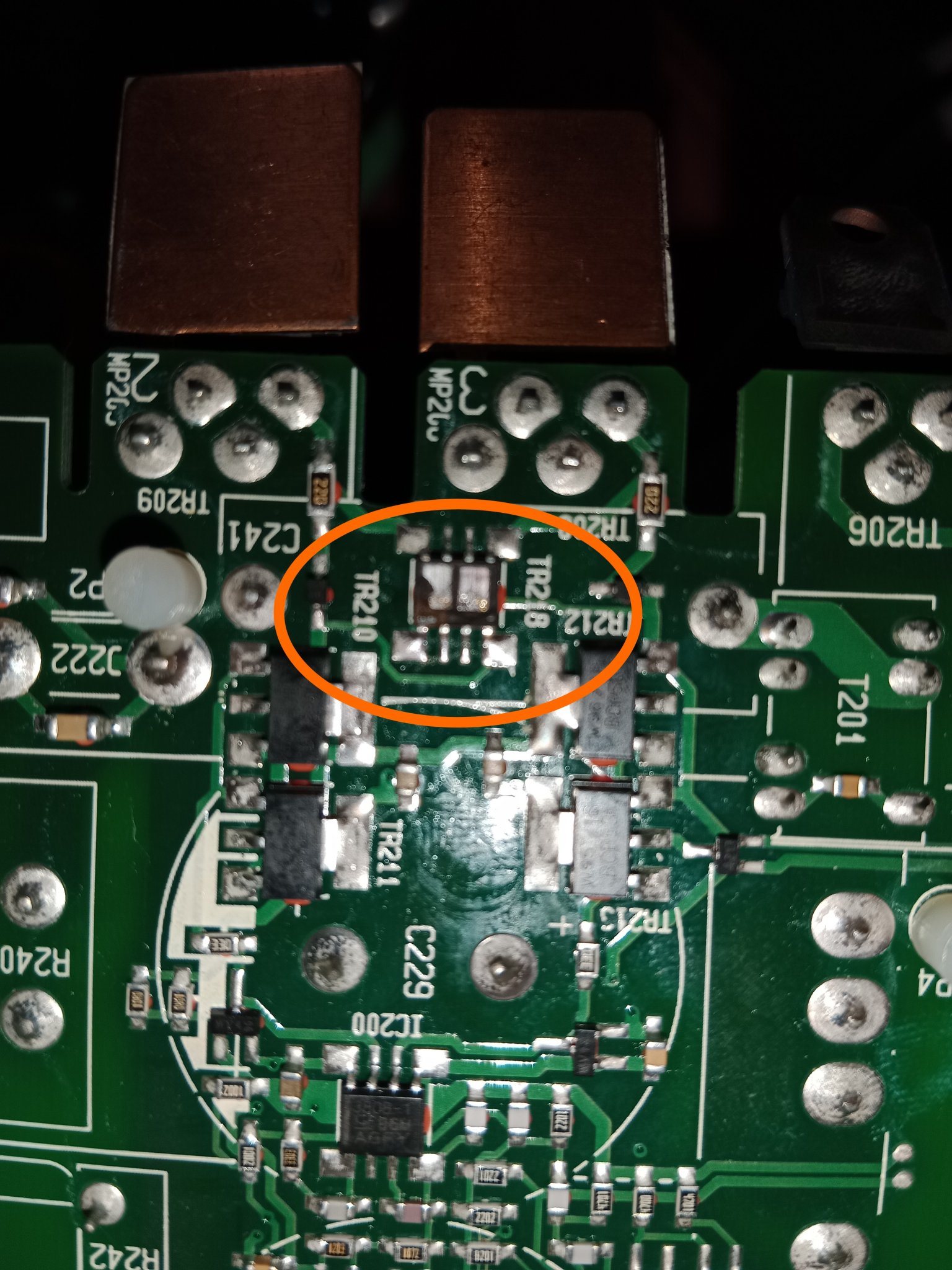

Have you finished repairing….?Hi guys, i have two modules icepower 1000asp damaged with high voltage, so exposed some components. Anyone can say the code of part number of TA218 and TA210
ThanksHi guys…..please let me know the value of highlighted components or please upload a photos of whole areas
TR218 is STS4DNF60 ,IC200 is UCC2808;TR210-BCP56-16Hi guys, i have two modules icepower 1000asp damaged with high voltage, so exposed some components. Anyone can say the code of part number of TA218 and TA210

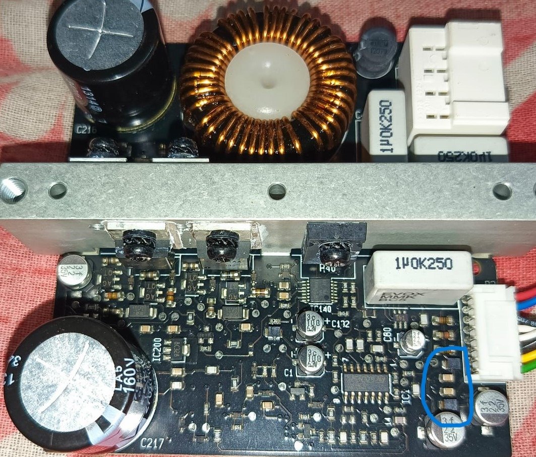

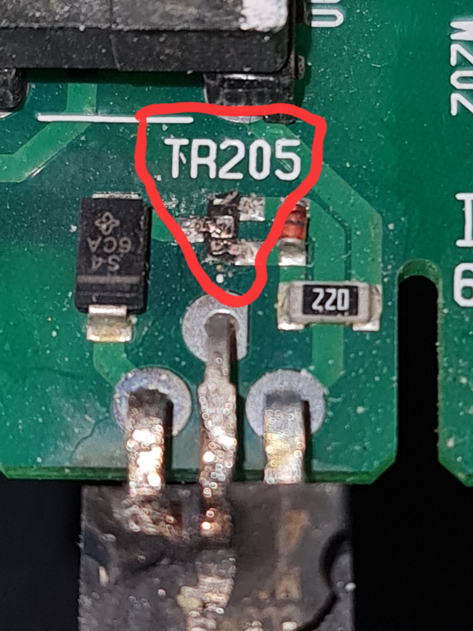

Hi All
Please help to identify the parts marked in the Ice Power 1000a module picture they are adjacent to the input connector. I have 2 modules one the parts have unfortunately come off and got lost in transit and one module with the parts populated. Most of the components are marked and identifiable, somehow the parts that went missing are not marked.
Below is the module with the parts missing in blue
