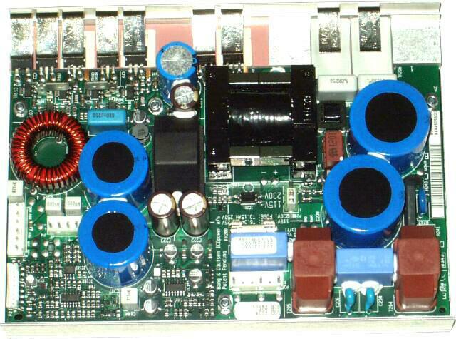

ICEpower picture
Yes i believe that this is an B&o Icepower ASP series - with an SMPS integrated with the class d amp - as used by Jeff Rowland (i believe) in their model 201 power amplifier.

Mr Rowland uses output transformers etc. which makes these amplifiers quite different what has yet been built using ice-power. Does JR really use SMPS ?
Mr Rowland
Yes he uses SMPS, and did in his model 10 and 12 also.
Mr Rowland may use transformers in the input / output stage of his preamps etc, but the 201 is made (certainly in part) by the ASP series from ICEpower AS in Denmark.
I am sure that the input stage will have refinements, and he would have ensured that his additional circuitry adds to the mix to ensure good performance from his amplifier.

I just opened the Jeff Rowland Concerto Amp... there is really an Icepower 500 ASP in the case; at the inputs they added a Lundahl transformer, that's all 😉 the same is in the 201 without preamp
I took a lot of pics, maybe I'll build some amps to fully activate my systems for 10 % of the price of 6 Rowlands
