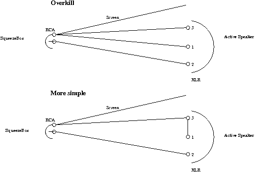

I have a SqueezeBox that has unbalanced RCA/phono/cinch sockets on it and have bought some KRK VXT4 active speakers with balanced XLR Combo (accepts 1/4" TRS/Jack plug).
I need to make two cables. From what I've read screened interconnects are a good thing in noisy environments so I'd like to build two screened interconnects.
KRK's advice is two connect pins 1+3 (ring and sleeve) at the ^source end^ (at the SqueezeBox.) This suggests, to me, using 3 cores + a screen. Two cores going to the ground on the RCA and the third to the live pin.
1st question: Is this overkill? Should I just join pins 1+3 at the XLR/TRS or is the 'wasted' core useful?
I've attached a 'diagram' of what I mean. Are the two options equivalent in term of audio quality?

2nd question: How dumb is connecting the screen/ground of the SPDIF to the earth of a 3 pin plug AND plugging it into the wall? Sounds dangerous to me.

Gosh, a namesake, and in the midlands... 😀
Now to your question.
I'd build the recipe as follows. Screened dual core cable (standard balanced cable) - One core to the ground (and the screen to ground), and the other to the center pin on the RCA.
If you want to get the most 'noise rejection', then the main length of interconnect will need to be balanced in operation - this can be achieved using some 600:600 transformers.
High Performance PCB Mounting AF Transformers
http://www.maplin.co.uk/Module.aspx?ModuleNo=46782.
Wire up one side with an RCA pigtail to plug into the SB, connect positive, ground and negative to the output from the transformer +, center-tap and - respectively.
Presto, one unbalanced to balanced link. This could be build in a project box, sweet tin, etc etc.
