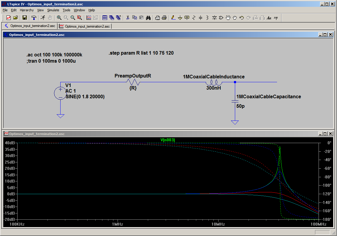

What I got from the formula is that there are two factors that determine if we should use lumped elements or transmission line - (1) the rise time which relates to frequency and (2) the length of the wire. While at RF above certain frequency the rise time is fast enough, there is a second factor. Because audio cables are relatively very short, transmission theory does not apply.
If that is the case, my previous posted picture of the simulation of the coaxial cable using lumped elements should be correct.

Correct for audio frequencies, maybe. Not for calculating a 'resonance' at 42MHz!HiFiNutNut said:If that is the case, my previous posted picture of the simulation of the coaxial cable using lumped elements should be correct.
