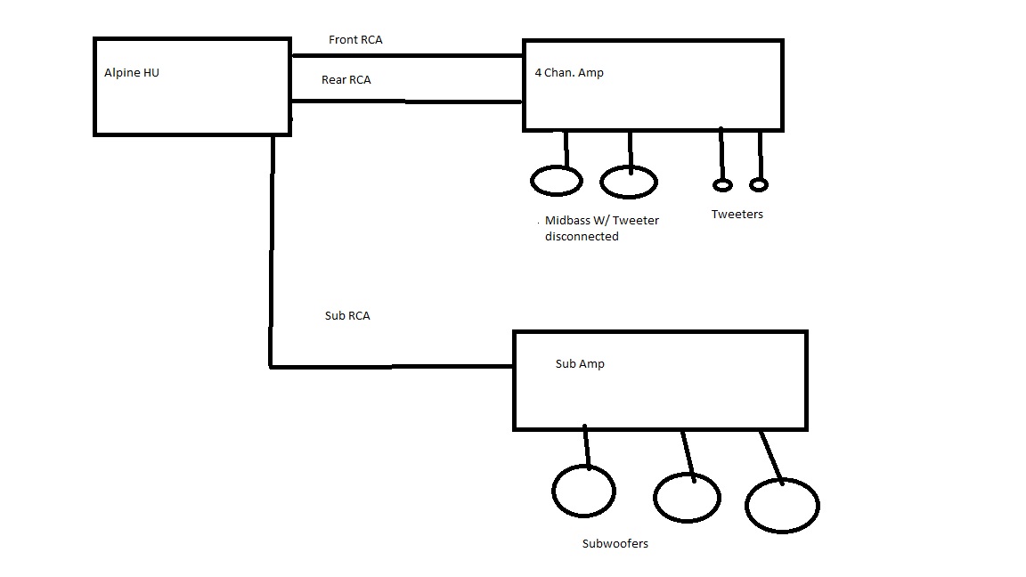

I think that covers it, so my question is the system is loud as hell. Mid bass on AC/DC and crystal method is very clear. Highs on female vocalists are awesome. The problem is the sound Stage appears to be right above my center console above my floor shifter. I Can shift it a little by lowering the rear speakers but not much. I believe the sound processor can help this a bit with time alignment and cross over points (that and adding the subs will change the crossover point for the 6x9's and I can turn them down). I don't think I can use custom kicks because there is not much room in my foot wells. I thought of putting 5 1/4's or 3.5's in the corners of my windshield but according to the 2010 rules I can't block any part of the windshield. So that leaves the A-pillars with custom pods or custom door panels adding an additional set of components. What is my best option here. I will add that I have not actually heard a perfect system nor have I ever competed before so I am going on what the rule books tell me and what I can find on the internet. I do have one ace up my sleeve and that's a Musical acoustics professor at Tiffin University that I could ask for help (I took his class last year). You can follow my progress at IASCA optima

Well first thing you need to do is disconnect your rear speakers or fade them out. Rear fill is only for rear passengers. You will never get the proper sound staging and imaging with rear speakers.
You are already looking to buy a processor but you have not even come close to utilizing that head unit properly yet. You should be running your front stage 2 way active and then tune using the parametric eq in that head unit. A processor will take you to the next level but that head unit can do a whole lot more then you are using it for.
I have attached a pic of how you should have your setup running with the gear you have. Personally I think you would be better off going with 1-2 15" subs and possibly something other then Alpine but that is just my preference for SQ installs. I would also disconnect the tweeters on the coaxials if you can do it without damaging them. Certain brands have a wire you can cut or a terminal you can disconnect. This isn't as important as everything else but it could be part of the reason you are having staging problems.
You may want to put a cap on your tweeters at a crossover point lower then your tuning to protect them. When running active it is easy to fry a tweeter if you are not careful when installing, setting up and tuning.
You could do a center channel if you really want but it wont fix any of the problems I have outlined. That is usually something you want to do after you have a stereo install setup perfect and it is still lacking. Peronally I think kickpods are a much better solution to getting better then stock sound stage and imaging.
You seems to have some stuff down but need to study a bit more on how and why you want to do things in an SQ setup. You may want to check out DIYMA.com - Car Audio Forum & 12 volt Community Board

The head unit that I currently have is a CDA-9886 which does not have the imprint processor built into it you need the PXA-H100 to get the parmetric Eq. I Could change my subs to a 12 at most but that means starting ALL over in the trunk when its all trimmed out already and the box is in for the 3 tens. Thanks to the link to the mobile site I hadn't seen that. As for the choice to go with Alpine they are a personal preference since I used to install the product and its in my price range. I have a second party that I need to justify the cost too and 3 grand was hard enough for her to accept. 🙂 Thanks again on the recommendation on the kick panels I will build them before I go any further with the system. As for the EQ I will start out with the alpine unit and see how close I get to good imaging I would imagine a properly built and aligned system should sound pretty good without the eq.
