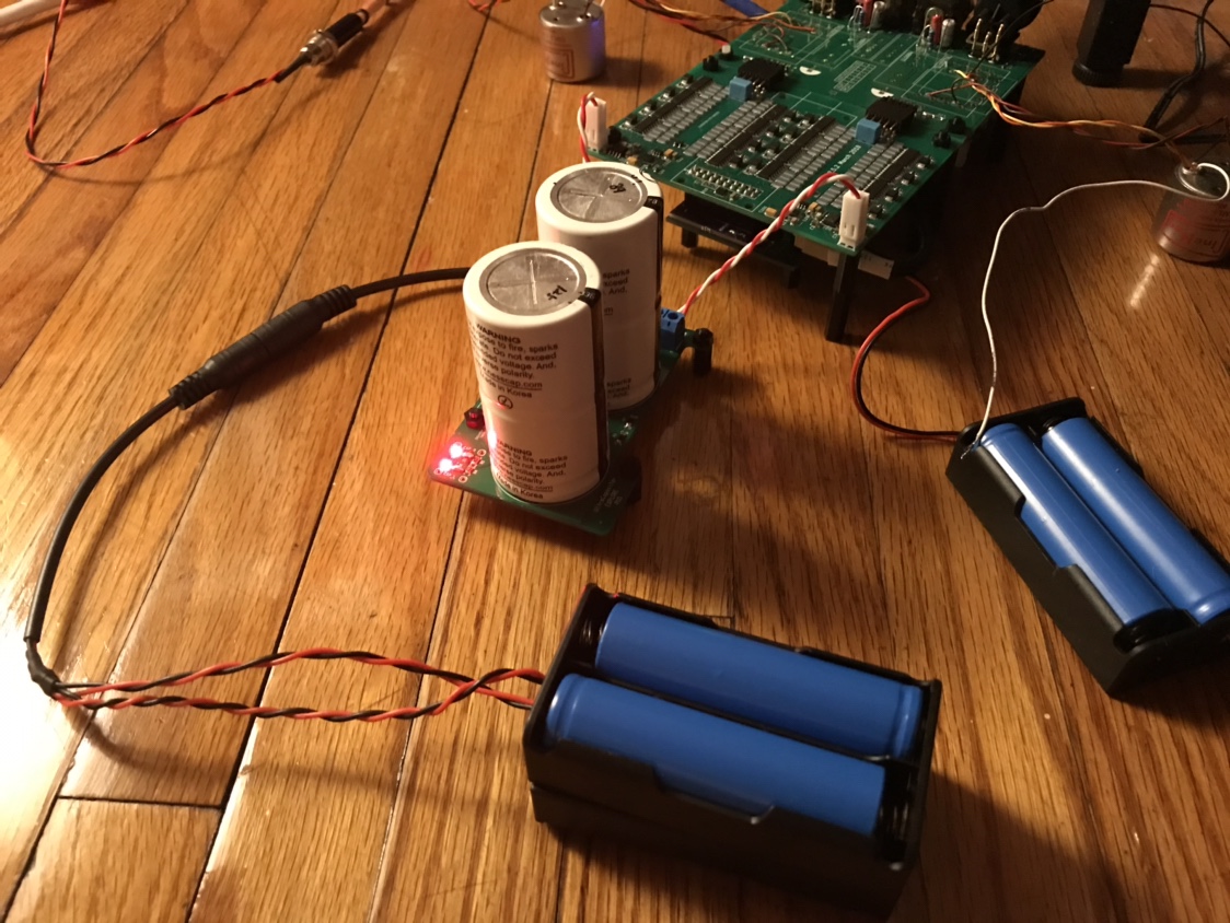

@iancanada
It’s alive!!!
Preliminary results:
1. I pulled the jumper and waited for the voltage to reach 4.8V and then connected the jumper. The PSU was connected to a lowly 5V switcher.
There was quite a nasty buzz in one of the channels, but the music was playing.
2. I pulled the switcher off and the buzz disappeared. The music kept playing only with the Ultracaps.
3. I decided to connect 2x2 LiFePo4 16850 (6.9V) batteries to the Ultracap PSU in order to counter the discharging process.
4. While I was preparing the battery contraption, the music kept playing. By the time I was ready in 30 minutes, the voltage was a bit above 4.5V and the music kept playing.
There’s no way for me to compare the sound, but I can only subjectively say I’m back glued to my chair. I love the concept and measurements of RME ADI-2, but the latter doesn’t glue me to my chair like that.
About my Frankenstein DAC:
BBB->Hermes->Cronus [4x clocks]->DSC2–>Cinemag transformer output stage-> Balanced out.
I’m currently powering the DSC2 registers bypassing the LDO with 5V.
Next step is to power directly the DSC2 logic and Cronus with 3.3V

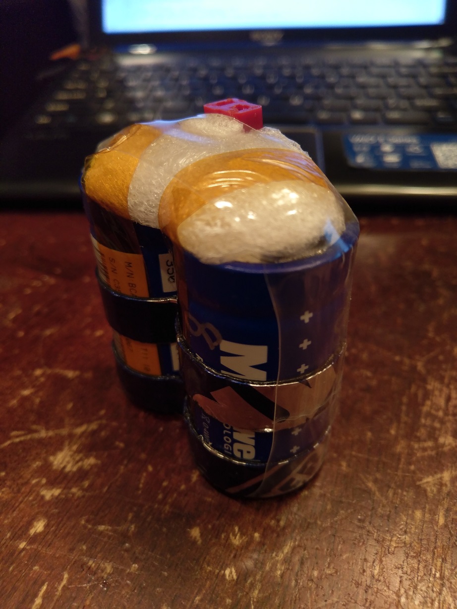

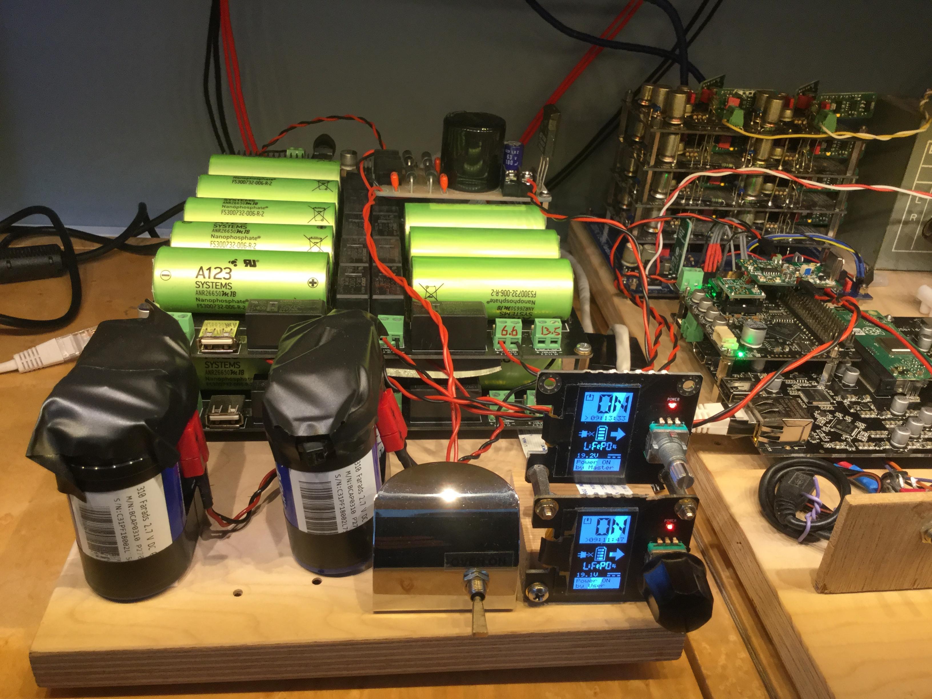

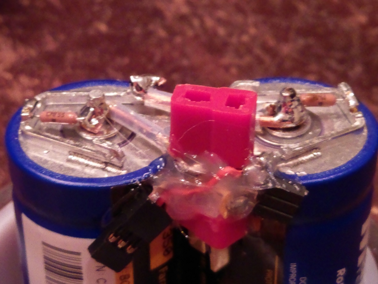

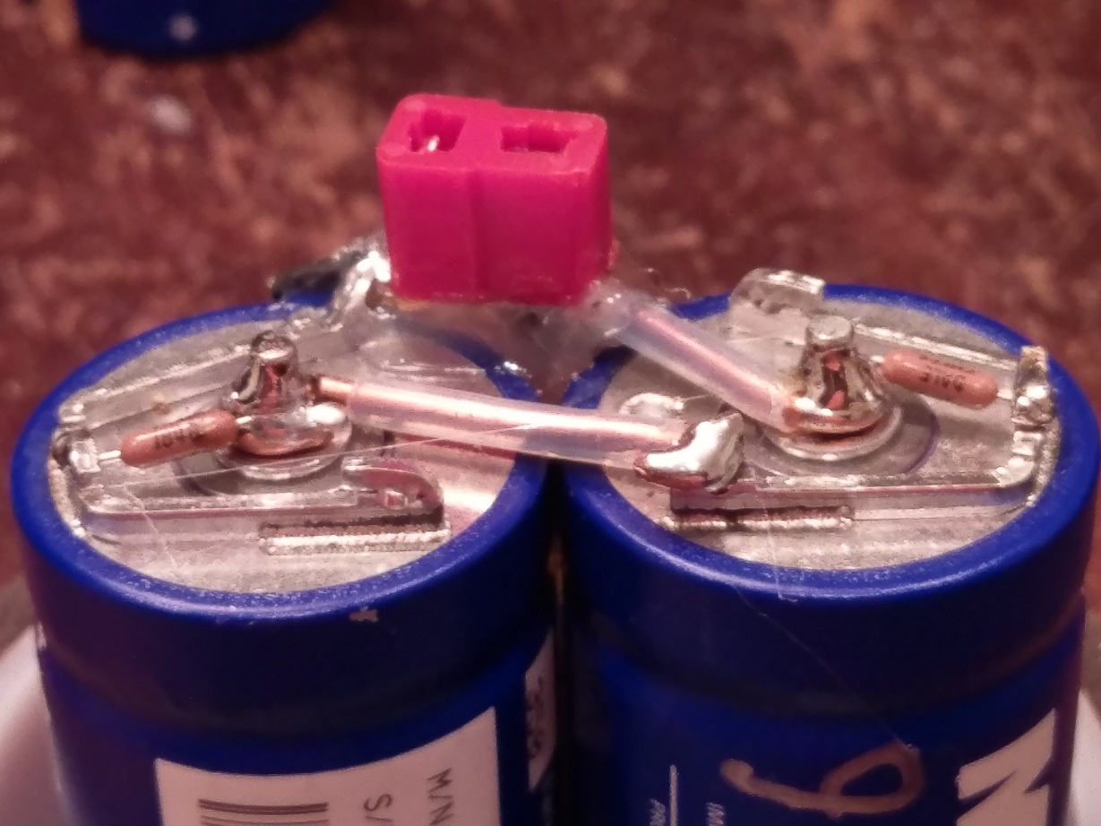

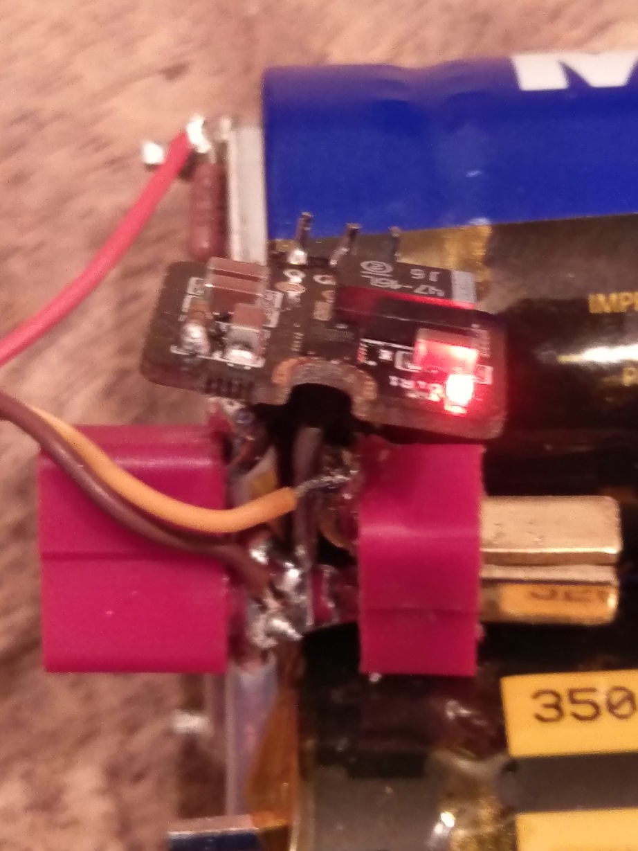

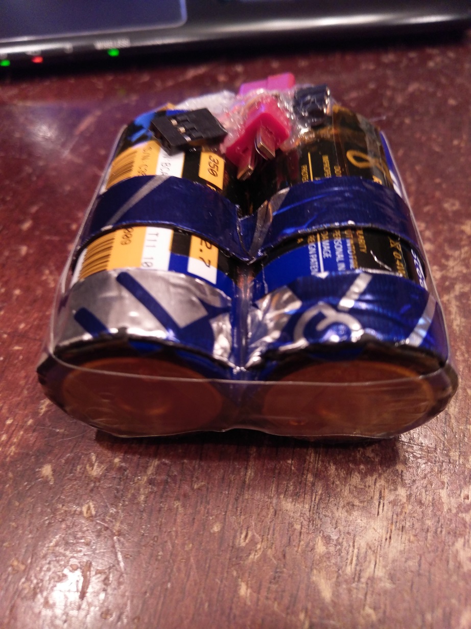

Update on my DIY Point-to-Point UCPi...
Basically, with all of Ian's boards spoken for, I built several of these this summer and have been using them as a quick way to have more UCPi supplies available for my setups.
I use a common model aircraft/car high-current plug for connections such as these. To make these units fairly durable, I integrated these connectors into the structure and used stout (18g or so) solid copper wire sleeved with Teflon for the connections.
During assembly, I liberally insulate potential short points with Kapton tape to ensure I won't run into problems over time. Once assembled and tested, I insulate ALL metal surfaces (note that the bottoms of these Ultracaps are live!), damped them, then securely wrapped them with large heatshrink. Fully insulating them is a critical step and I don't recommend leaving it out... charged, these Ultracaps will push over 200A into a dead short! You don't want accidents with these!!!
Connections are Vin, Vout, charging regulator, and voltage monitor. I used these voltage monitors when initially charging them and putting them in a setup, but remove them after things are setup and stable:
bayite 3 Wire 0.36" DC 0~30V Digital Voltmeter Gauge Tester Blue LED Display Panel Mount Car Motorcycle Battery Monitor Volt Voltage Meter with Reverse Polarity Protection Pack of 5: Amazon.com: Industrial & Scientific
I left out the on-off header from Ian's orignal configuration. I first pre-charge them to the target voltage, then plug them in to use and disconnect them when not in use. I also didn't include the charging filter choke as I have been using these with quiet power supplies constantly connected to float-charge the Ultracap pair. When first charging them to the needed target voltage (typically 3.3V or 5V) I use Ian's LT3045 regulators with a 250mA current limit to control the charging rate. Once charged, if I used a supply with the same voltage as the target voltage, I replace the regulator with a small jumper.
A good example of where I used a charging supply of the same voltage as the target voltage is for powering an RPi or RPi substitute. I used a 250mA current limited 5V Ian LT3042 regulator fed from one of the typical 5V supplies I would use to power the RPi to charge the DIY UCPi to nearly 5V (they won't get all the way there due to the LT3042 dropout voltage). Then once the DIY UCPi is charged and before I connect it to the RPi, I remove the current-limited regulator and jumper input to output so that it is fed directly from the 5V supply. I do this because even though the supplies I use for this application are current-limited, because they need to have a current-limit of greater than 1A (I generally use 3A-3.5A supplies for my RPis), they'd get VERY hot during the charge phase, likely more than the heatsink will handle. BUT once charged, I need a current limit higher than the 250mA of Ian's LT3042 regulator boards to keep the Ultracaps charged when powering an RPi (with no charging supply, the USPi powering an RPi runs down to about 4V in about 10 minutes... not very useful!)
I leave it to the readers to duplicate this for their own setups and connector requirements.

These are currently my best sounding supply setups for both the 5V inputs on an Allo Katana, the 3.3V inputs on an Ian GB FiFoPi/DAC setup, and for an RPi or an Allo USBBridge Signature.
I followed the idea of Greg for the ultracaps. As a diy drone builder I had some connectors lying around 😉
The ultracaps are used on the ps for the fifopi and andrea mori clock (3.3v supply).
It’s now running in. I am very curious of the results.

For my DIY UC pair PTP builds, I used Ian Canada's UCPi schematic as a basis, but only kept the Vin, Vout, UCs, balancing resistors, and 3-pin connector for the current-limited regulator. AND I added a connector to measure voltage with the small voltage monitors I linked in some of my previous posts on these.
Ian's UCPi schematic is linked in post #1 of this thread.
On my original builds I used the 1K balancing resistors in Ian's original schematic. Later Randytsuch shared a rationale and formula to calculate those resistors... I think he posted it on a thread at TirNaHiFi.org at one point, but I didn't take the time to find it there. From the email he sent:
"was looking yesterday to figure out the value of the balancing resistor, and found this info:
Passive Balancing: One technique to compensate for variations in parallel resistance is to place a same valued bypass resistor in parallel with each cell, sized to dominate the total cell leakage current. This effectively reduces the variation of equivalent parallel resistance between the cells which is responsible for the leakage current. For example, if the cells have an average leakage current of 10uA +/- 3uA, a 1% resistor which will bypass 100uA may be a good choice. By using this resistor in parallel to each cell the average leakage current is now 110uA +/- 4uA. Introduction of this resistor has now decreased the variation in leakage current from 30% to 3.6%.
Leakage is .75ma for the BCAP0360 P270 S18
So if you aim for 10x that its 7.5ma or 0.0075 a with balancing resistors
For a 3.3V power supply, each cap sees 3.3/2 = 1.65V
v=ir r =v/i = 1.65/.0075 = 220 ohm
I will probably go even smaller, around 75 ohms would consume 22ma. A smaller value resistor will use more current, but will do a better job balancing the voltage."
I noticed Ian is using 470R or so resistors in his scheme for paralleling 2 325F-350F UCs instead of the 1K in the UCPi. On my next set of PTP UC pair builds, I used 499Rs across each UC for balancing. Then when I built up a couple pair of 3000F UC pairs, using the formula above gave me something around 100R. I used 100Rs.
The balancing Rs are not an exact science... a close value will work ok. AND even the 1K Ian used in his original UCPi should do a fair job of keeping the 2 UCs in balance, just not as good as the recommended lower value.
I say all of this because from an 'Everything Matters' perspective, I like the simplicity of passive balancing Rs and a current-limited/temperature-limited regulator for charging. AND I am cautious about the impact the boards on the UCs you mention will have on SQ.

I have found that the purple ebay lt3042 3v3 regs wont charge my UC pair from empty. The led remains unlit and the thing got hot fast. Seems to have survived I guess it went into current limiting shutdown.
So I charged them with my bench psu. Set to 3v3 CV it peaked at the psus max of 5.3A and dropped into CC mode until the voltage rose a bit and then the current dropped and it went back into CV and charged to the 3v3 target.
It didnt seem to take long..a few minutes. I thought I was going to be there some time.
Plugged it into a Fifo I have sat here and it remained lit for a good hour and was still lit when I unplugged it....voltage in the caps dropped to 2.6v.
Shall try the lt3042 again now the caps have some charge left in them.
@jimk04;
Do you have my free LT3042 PCB? My LDO board doesn't have problem with charging UCs. I set the current limitation to 200mA, it takes around half hours or more to charge a 350F UC and doesn't go that hot.
