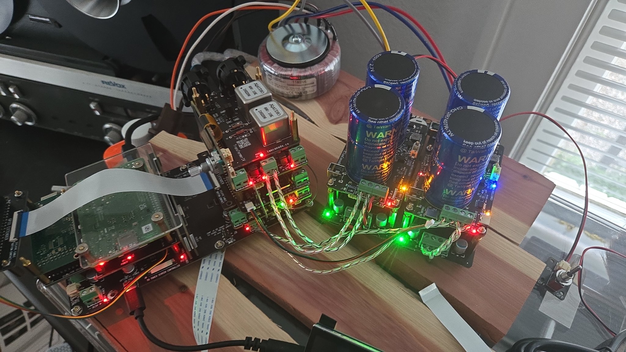

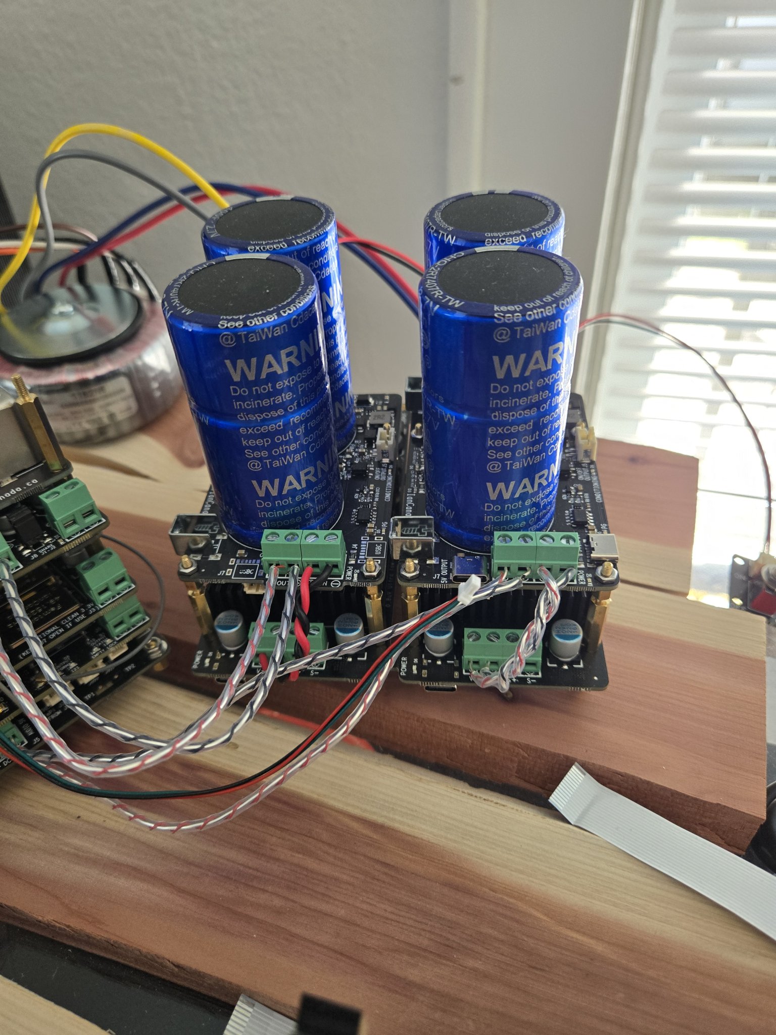

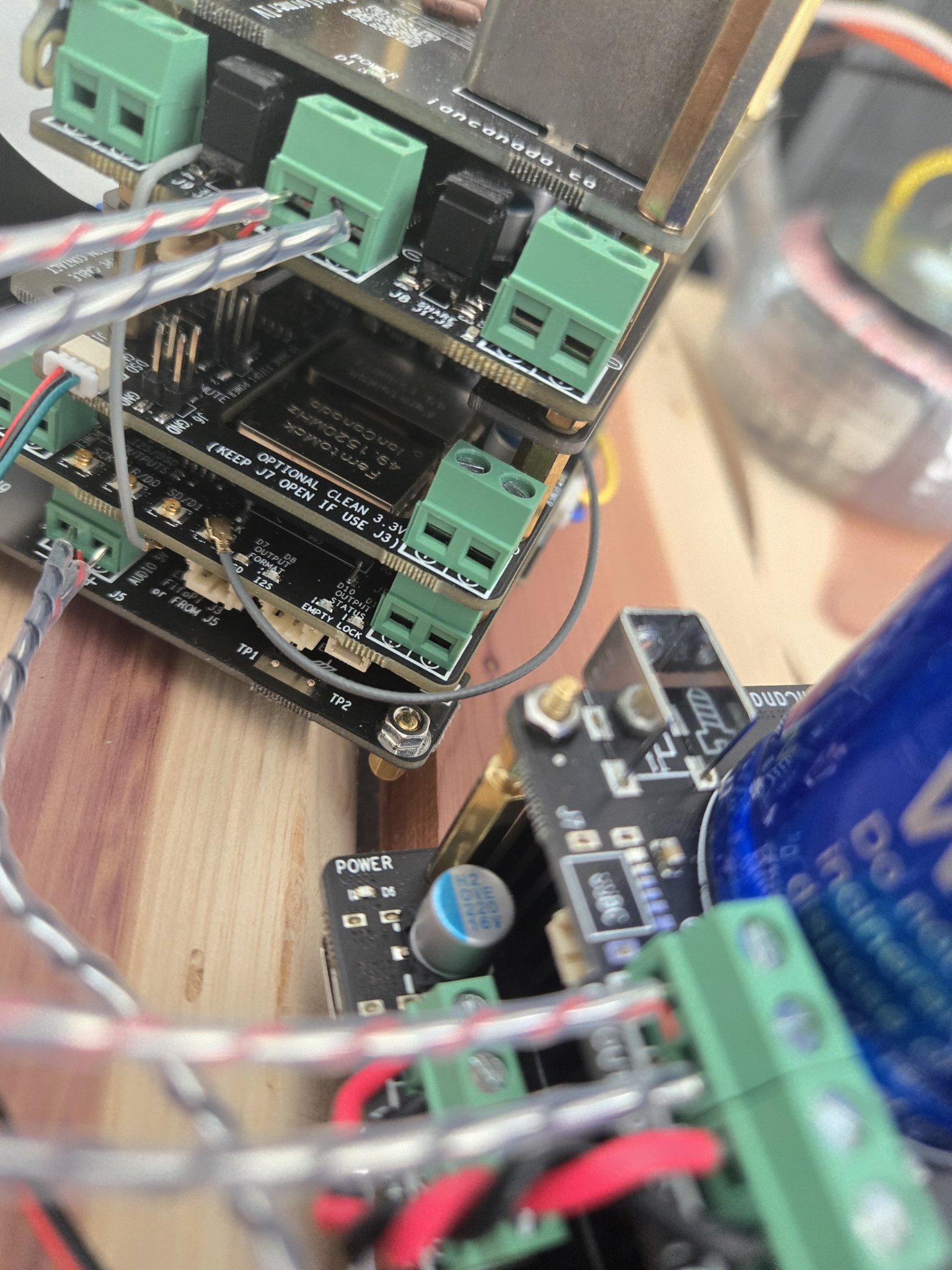

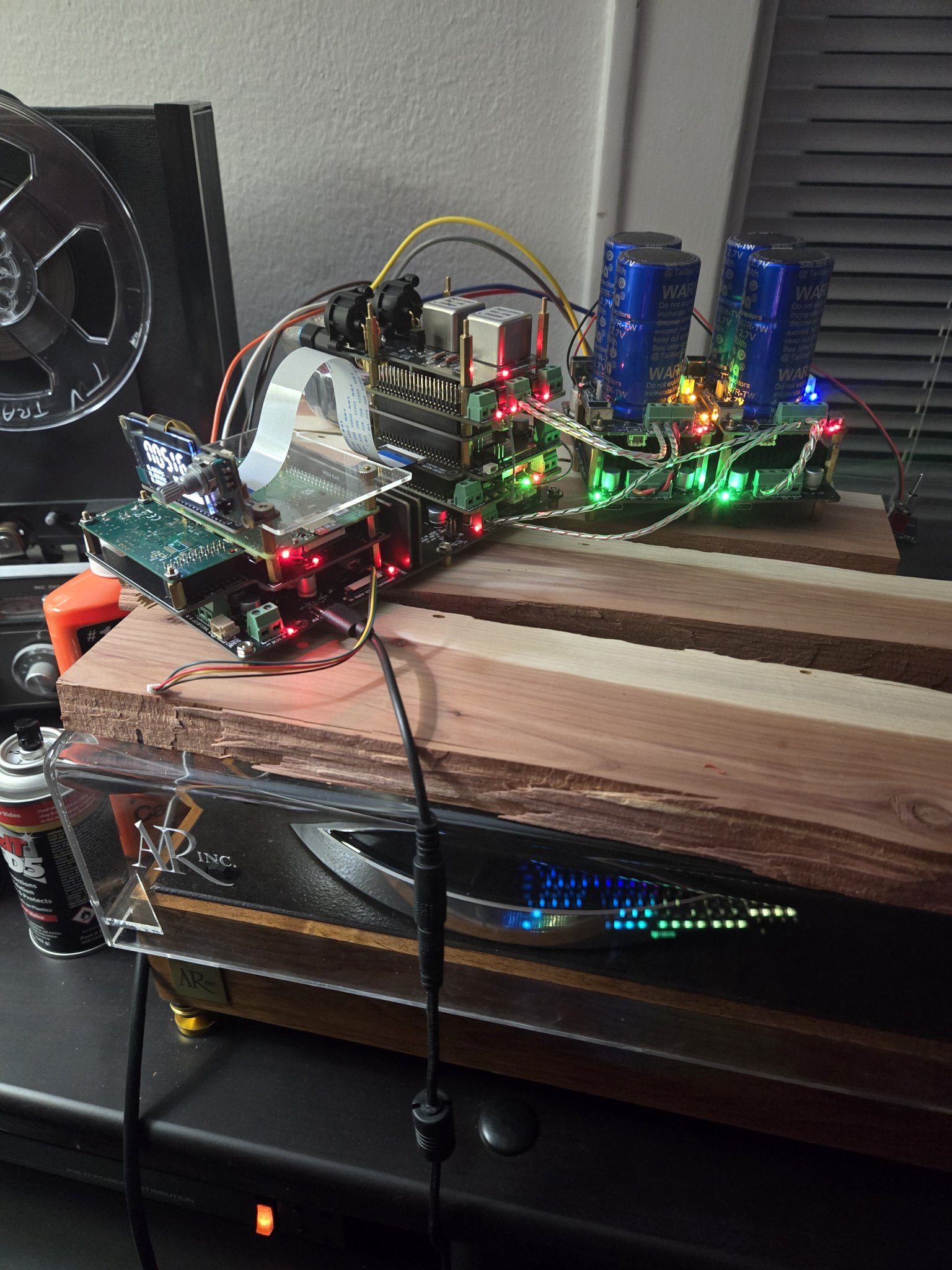

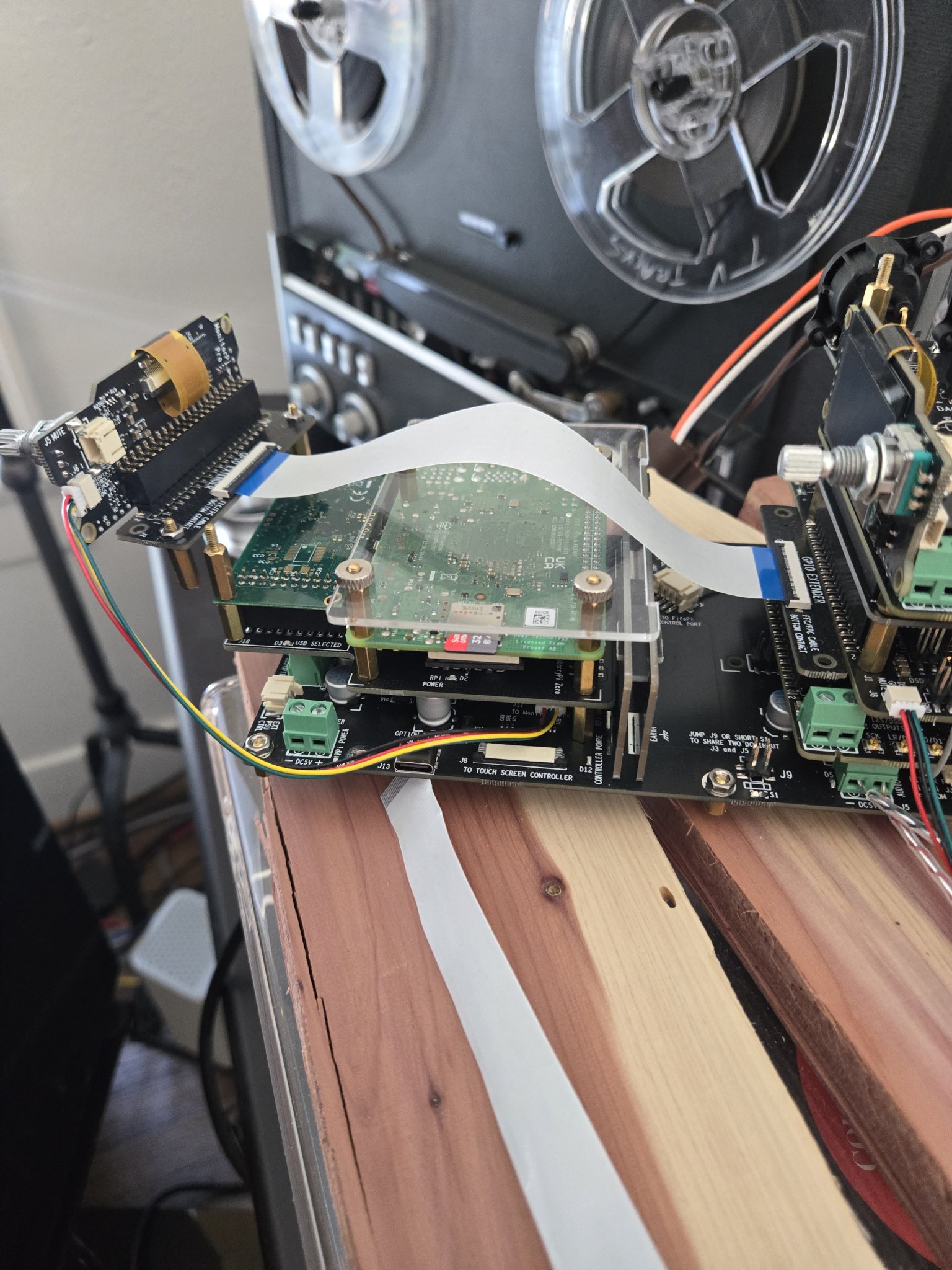

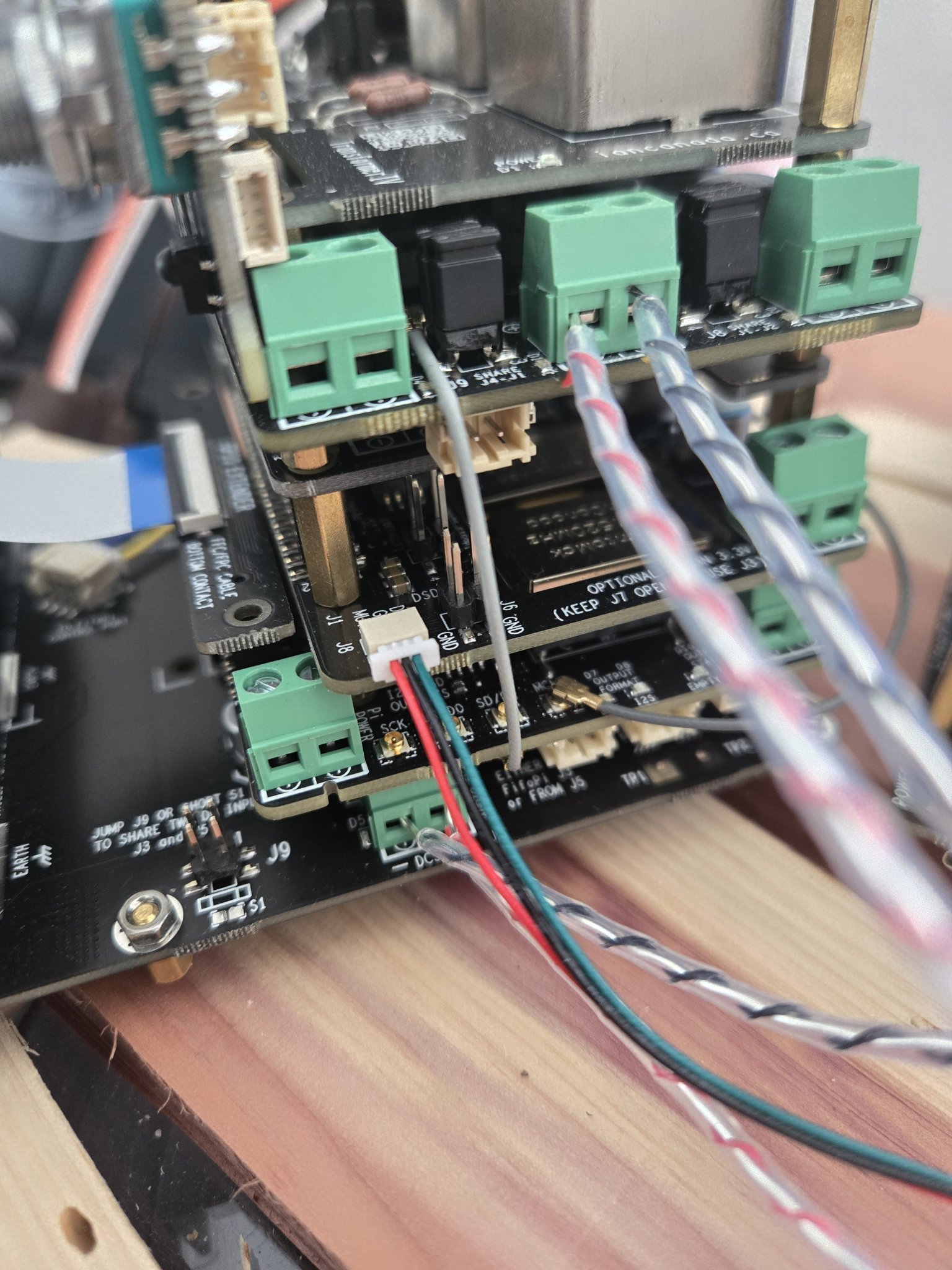

Here are pictures of the build to help. The unit is powering on and I can see it in Ropieee. It just doesn't work in roon.
Power stack
Right (clean) side stack
Left (dirty) Side stack
I originally assembled and initialized this RPi as a Streamer (no dac hat) only and it seemed to work fine.
now that I added the better power supply and DAC hat to the clean side it doesn't conn3ct to Roon.
My Conclusions and Questions:
1. Since Ropieee was installed and initialized before the DAC components were added, this unit is now initialized incorrectly for its current hardware. Maybe this is why ROON will not connect and the unit is not working.
2. Maybe my stack is not assembled in the correct order.
3. Is it a problem that both the HDMI Pro II and ES9038Q2M are using the FifoPiQ7 as a re-clocker? Is it okay that both boards are connected to the MClck input of FifoPiQ7 II via U.FL cable?
4. Is there a problem indicated by the LEDs in my picture attached? I believe each board is getting power. I am suspicious there is an issue with the power to the ES9038Q2M because there is no display from the MonitorPi that's plugged into it.
I'm sorry this post is so long. This has been a big learning experience for me. I've spent a lot of money, and read every document associated with each board I've purchased. I've watched many builds videos by Gabster. I have also spent hours searching and looking for a solution on DIYaudio, but can't seem to locate what my issue is.
Please help!
Power stack

@Sigmafia
Thanks for the pictures. I saw some issues.
1. You can not use two MonitorPiPro in system. Please use only one to the FifoPiQ7. Here are some project for you to reference
https://iancanada.ca/products/flagship-full-function-fifo-re-clock-ddc-streamer
2. I didn't any display on the OLED screen, the DAC will not work if the controller (MonitorPiPro) is not working
There are some tips
1. Have to install PCBs to GPIO connectors correctly. Shift pin positions can cause short circuit
2. Please don't mix up software issue with hardware. If you are not familiar with software, please get started from easy one such as volumio
3. Download user's manual before you get started
4. Do it step by step
Please read the blog for helps
https://iancanada.ca/blogs/news/tips-of-diy-digital-audio-projects
https://iancanada.ca/blogs/news/troubleshooting-cases
Good weekend
Ian

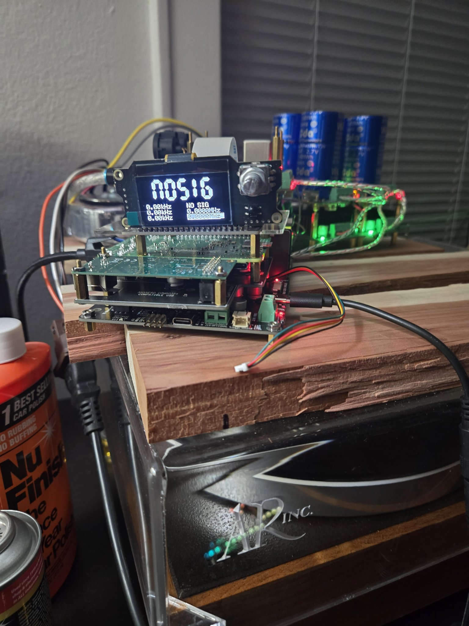

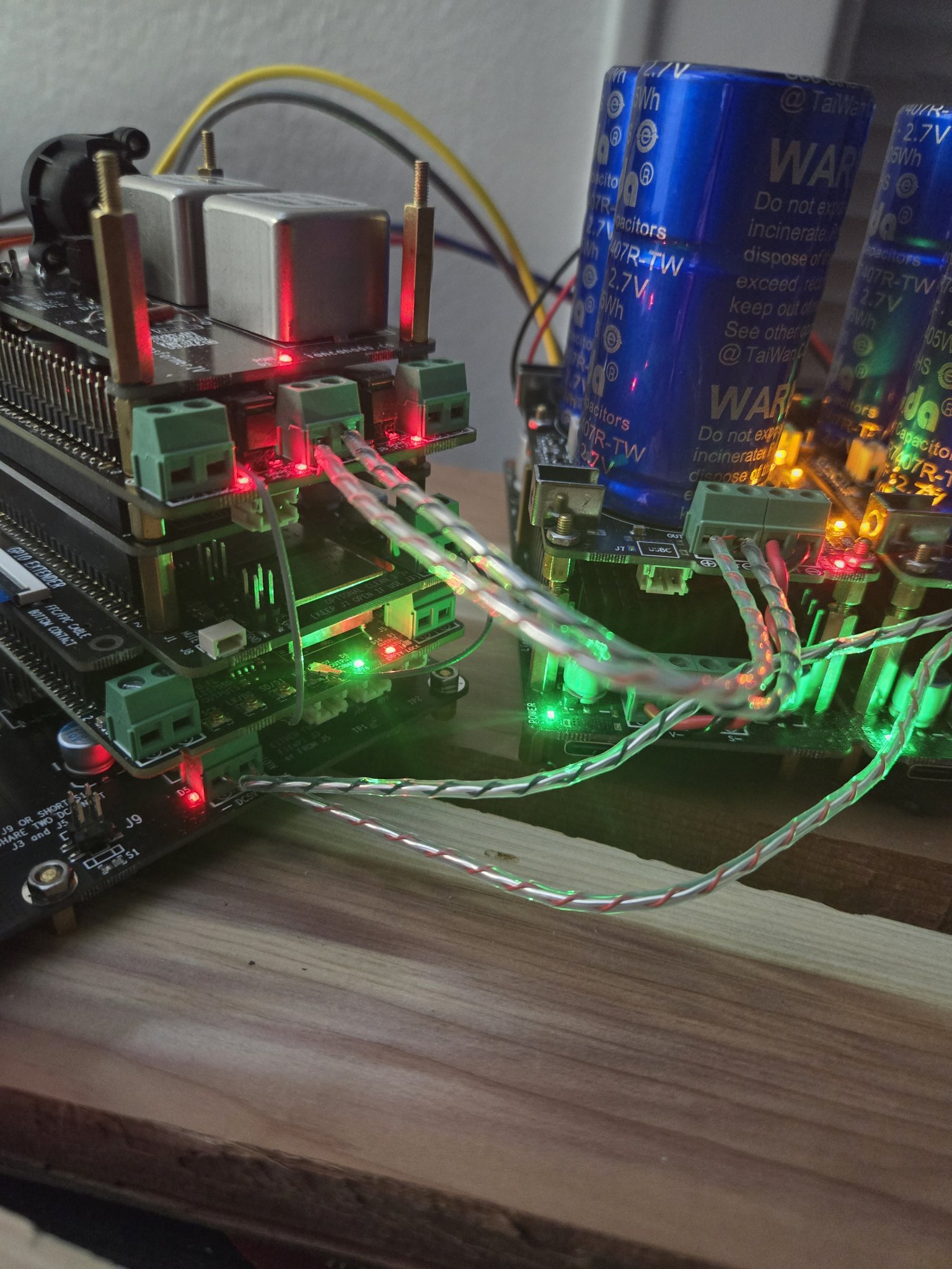

Hey Ian. I had a crazy work week and needed to wait until today to get back into the project. I am available now though and shouldn't have any more delays in the near future.
So I was about to undo the stack and only have Q7 on the right side with a MonitorPiPro as you instructed. I decided to try to intialize one more time since I had made a small change to the configuration since I tried it last. The change I made since your last message was:
1. Removed 2nd MonitorPiPro from system and left only the MonitorPiPro that is connected to the Q7.
2. Removed the power jumpers (J9) on connecting the 5V power to the right and left sides of the StationPiPro. I used an Ifi 5V power plus to power the RPi side and left the 5V and 3.3V from the capacitors to power the right side stack.
With those 2 changes I thought I would give it one last try before dismantling the stack. I powered up the unit and initialized Ropieee with my laptop at IP Address 10.0.0.205. It initialized correctly using the "Raspberry Pi DAC (Generic I2S)" audio HAT selection.

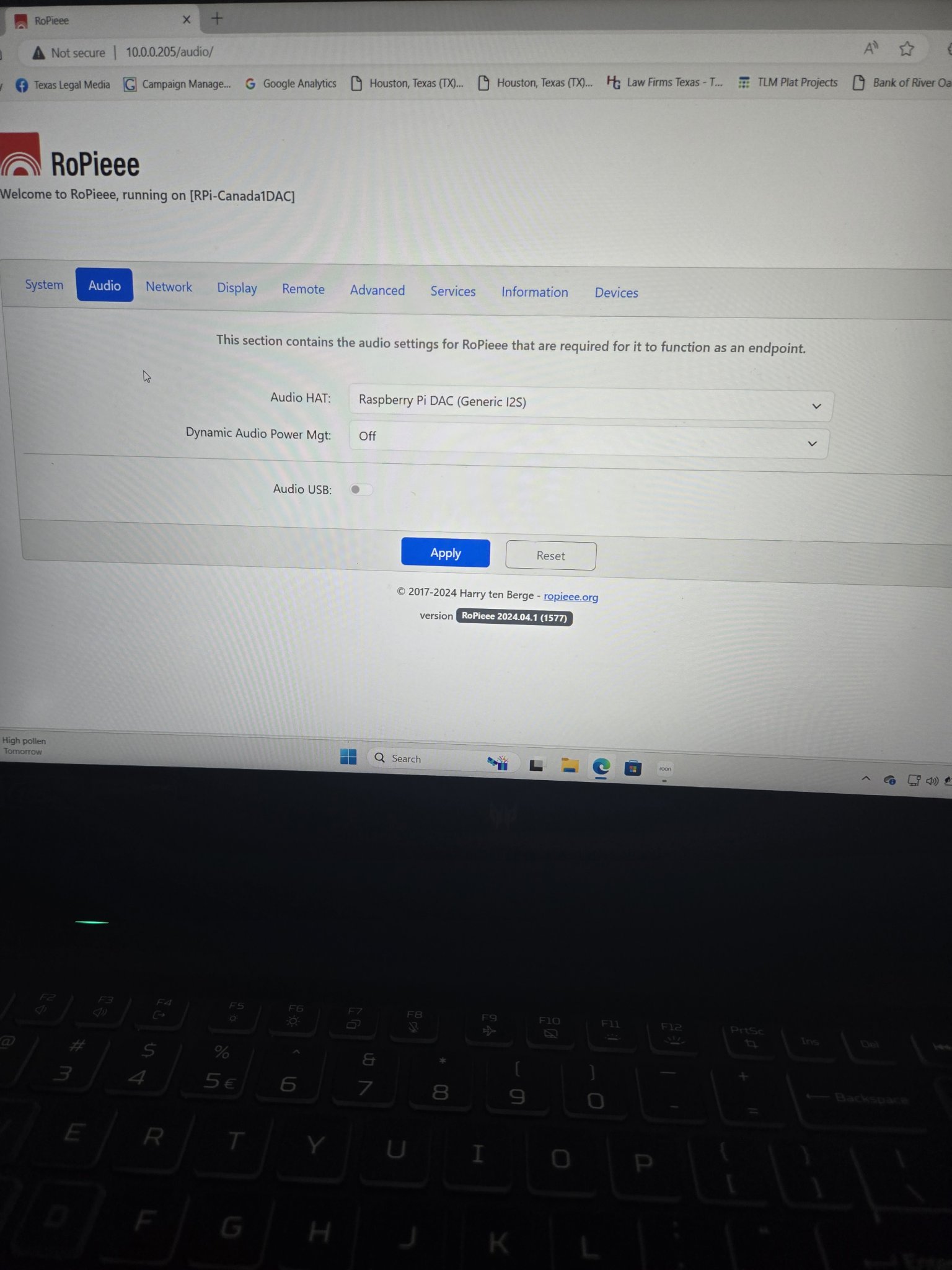

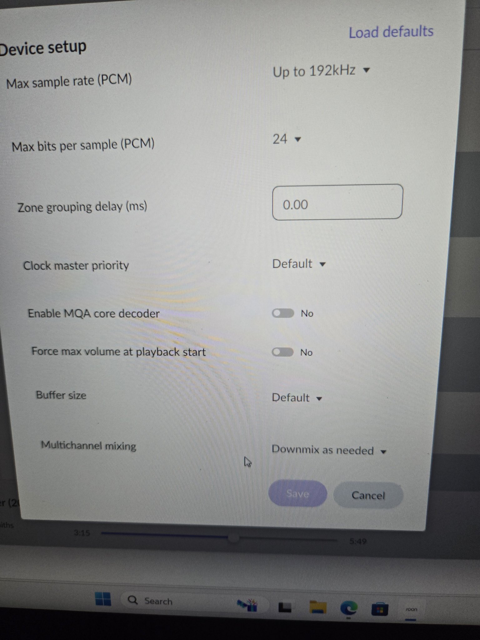

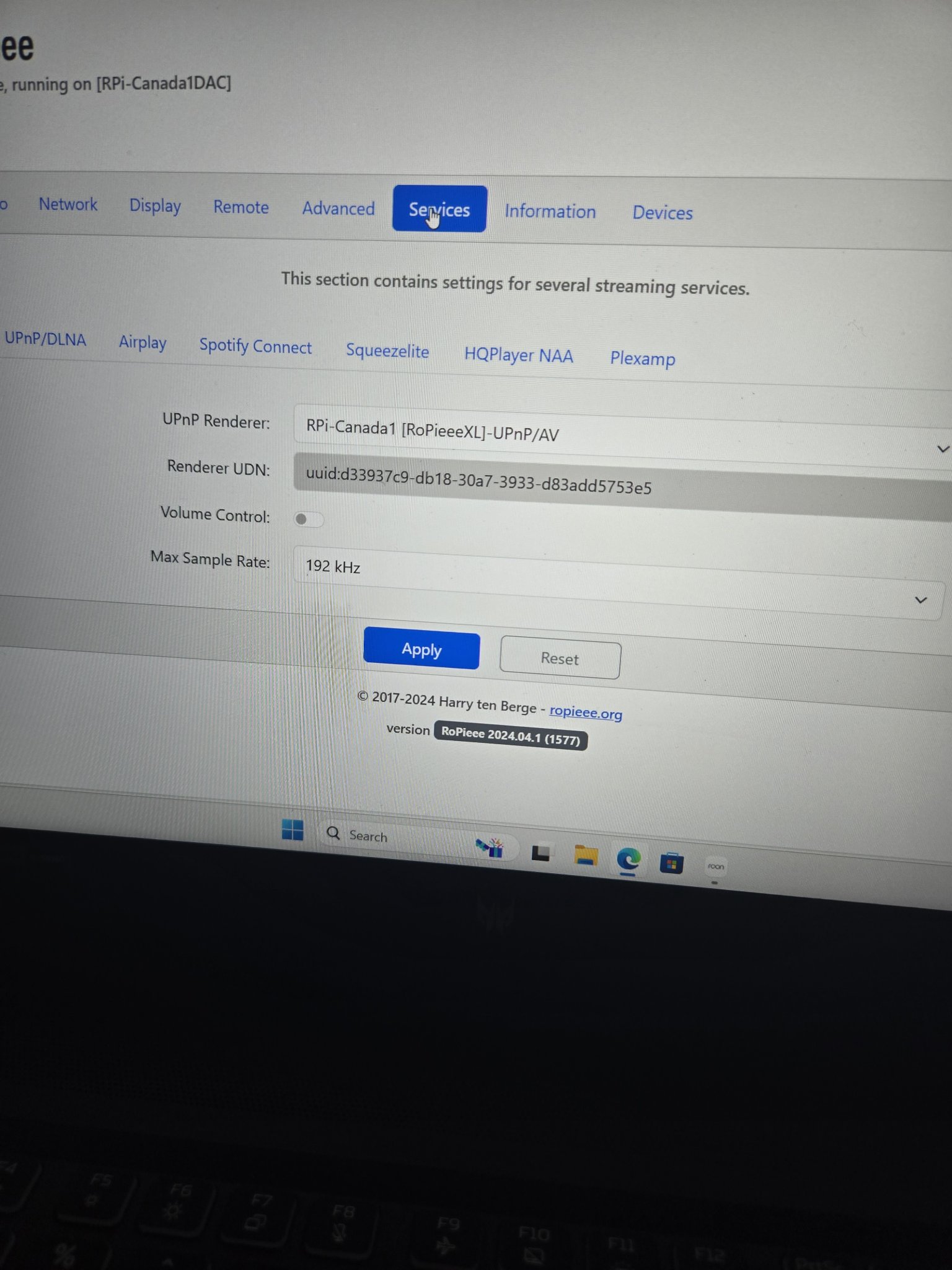

Above is the Ropiee screen after I initialized and reboot. It did not have an issue finding the UPnP Renderer or UDN. This has been difficult in past attempts.

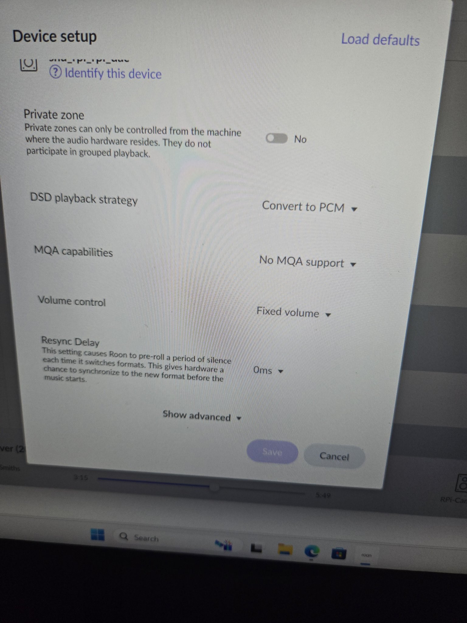

Next I opened Roon and Found the device with no issues. I added it to my device list in the Audio setup tab and kept everything at default. See selections below.
Next I selected a random track and hit play. I wasn't able to hear the playback but something interesting did happen. Whenever I select to play any track the screen on the MonitorPiPro starts flashing between the two - "0.000MHz" options under the smaller "no signal" text. I took pictures with each of the 2 options lit up. Anytime no song is playing the screen looks like below except with no selections highlighted and no screen movement. As soon as a track is played, the selection bar flashes very quickly between the 2 selected options in the below pictures.

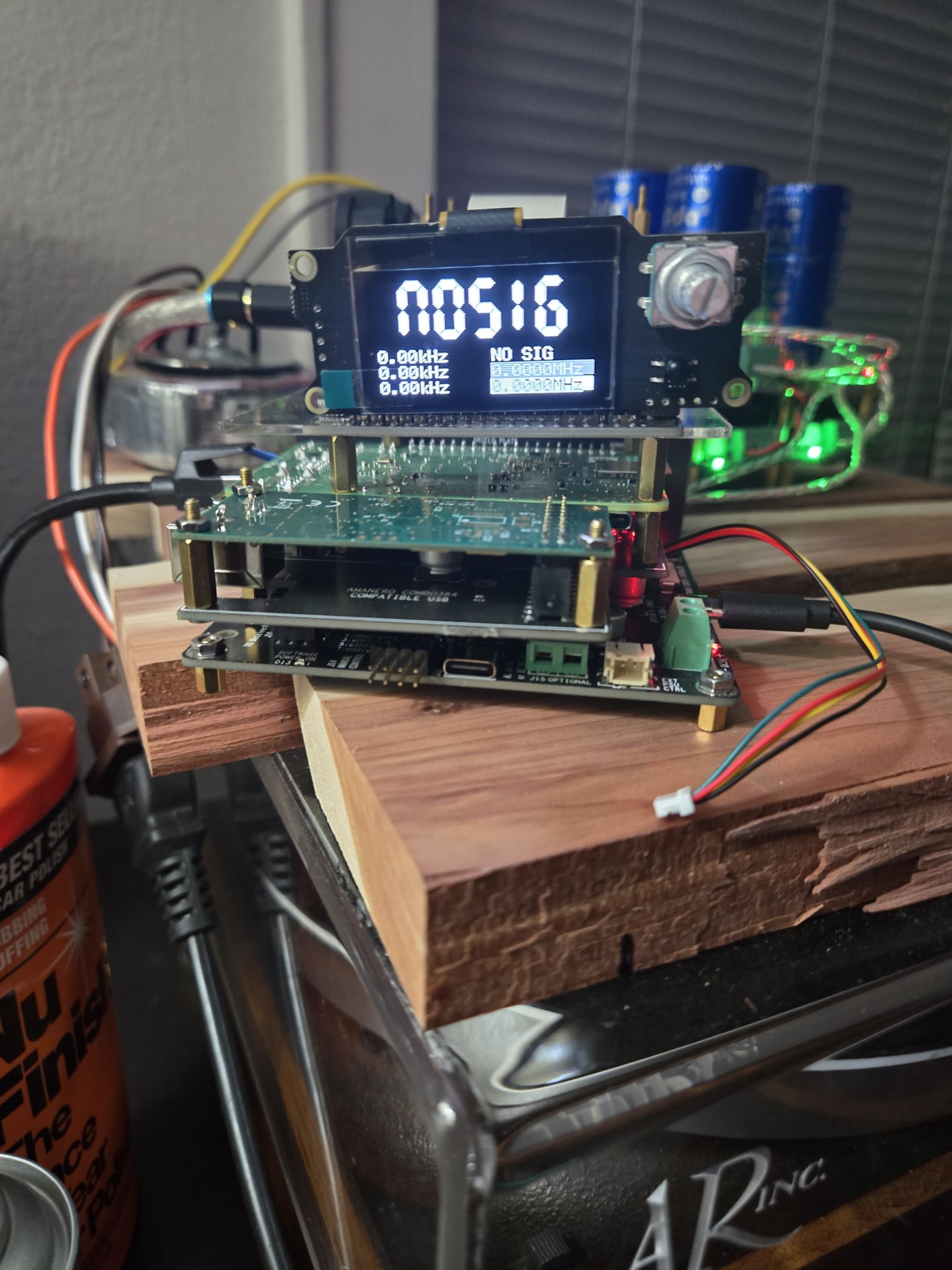

Top 0.00MHz selected
Bottom 0.00MHz selected
In the pictures below you can kind of see it in between selections and it looks like both are on at once.
Switching between the 2 options
I don't know if that is a clue towards the issue? It may not be useful information at all. Just in case, I decided not to disassemble the unit until you have a chance to reply. Maybe this is something you've seen before and can help me solve the issue.
FYI - the MonitorPiPro never displayed anything except "NOSIG" and the flashing selections I've described.
Please let me know if you would like me to start over on the right side with just a Q7 and MonitorPiPro. I am happy to do so and will take any advice you suggest.
Below are a couple more pictures of the unit and LEDs during my test today.
Thank you, Ian. I am so grateful for your help.
Matthew Sigmon
One last thing to mention. I have not seen any LED activity on the board HDMI Pi Pro board. Wvery other board seems to have LEDs on when the power switch is flipped. Just not the HDMI board. Maybe this is normal or maybe I can't see the LED because it's hidden underneath the stack.
When I turn the knob on the MonitorPiPro it gives me the options of selecting:
1. HDMI
2. RPi
3. RCA
4. OPT
I have tried all options with no success. I assume it should be on RPi Since that is the streaming music source I'm playing from.
1. HDMI
2. RPi
3. RCA
4. OPT
Please do it step by step.
First, remove Q7 and all the rest boards at the right side. Just install a MonitorPiPro through a GPIO spacer at the Q7 position.
Make sure the OLED shows correct format when you play music.
Let me know if you have an update.
Ian
Ian
Hi Sigmafia
FifoPiQ7 also need a 3.3V for the clean side.
Please download the user's manual for details
Ian
Ian
