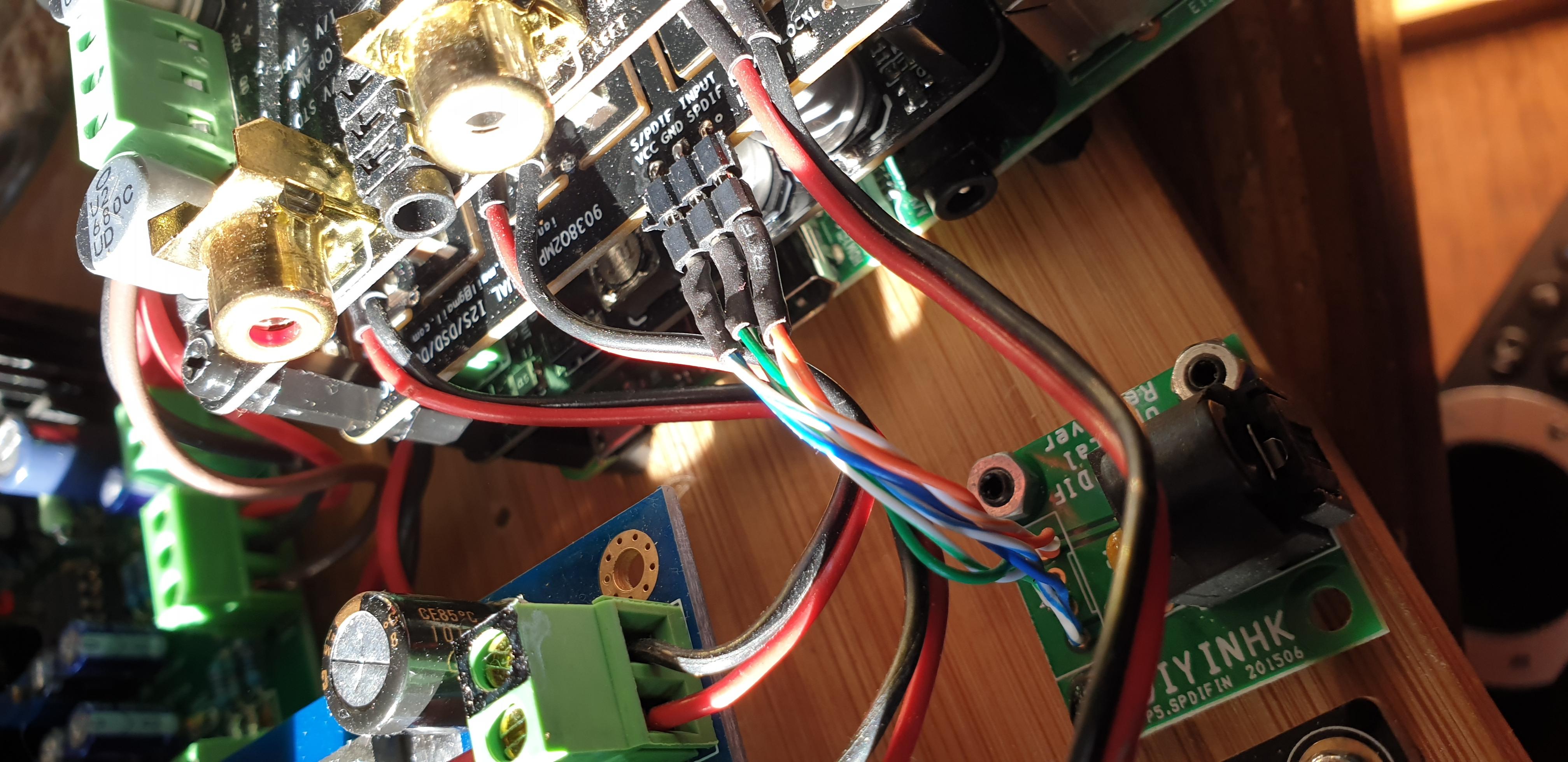

Hello again guys.
Can I ask again please for some help connecting optical spdif to the dac. I got a receiver from DIYINHK and I fathomed out the wiring. Quite simple really. 3.3v/ GND/ SpPdif. So I connected this up to the DAC but I get nothing from it. The lock lights were lit but no signal displayed on the controller. I did have the Rpi powered but I hadn't booted up Volumio or even connected the ethernet.
Guidance much appreciated.
Connnection
Film caps are .1uf, resistors are 200r
Reactions: Bas Horneman
@jimk04,
To get assistance on troubleshooting an issue like this, you need to provide much information on your setup so that we can know enough to be helpful. Please provide:
- An overview of your stack... what cards from bottom to top, any special adaptations or modifications, what software and configuration you use, how you are operating the DAC board (ASRC or Sync mode), how each board is powered .
- Info on the DIYINHK receiver... info on it from the source, how you've hooked it up.
- Your optical S/PDIF source (TOSLINK)... what it is, confirmation that it has worked as a source in other setups like this before, descriptions of those setups.
- Pictures of the overall stack, detailed pix of your general mods / adaptations including hooking up the DIYINHK TOSLINK board.
- List of what you've tried for troubleshooting so far.
With info like that listed above we'd have a chance at assessing what's going on and providing useful information. Without it, we'd have to start a long string of question and answer posts to get to a point where we could even make partially-informed guesses.
AND I did go back through some of your previous posts on this setup... but even with that, I can only guess how you have it setup and running today.
Sincerely.
Greg in Mississippi
Spdif assitance

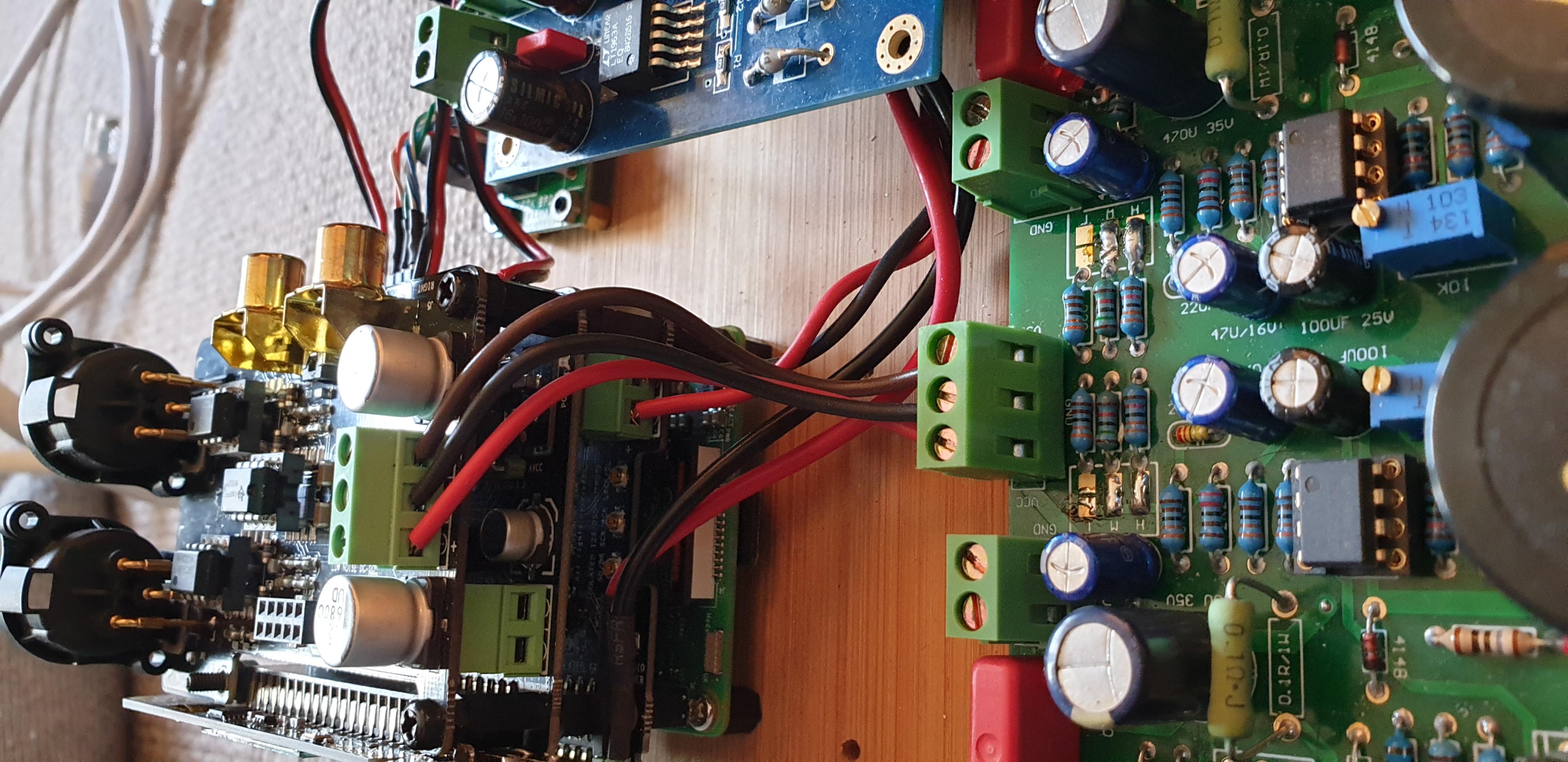

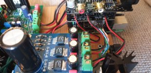

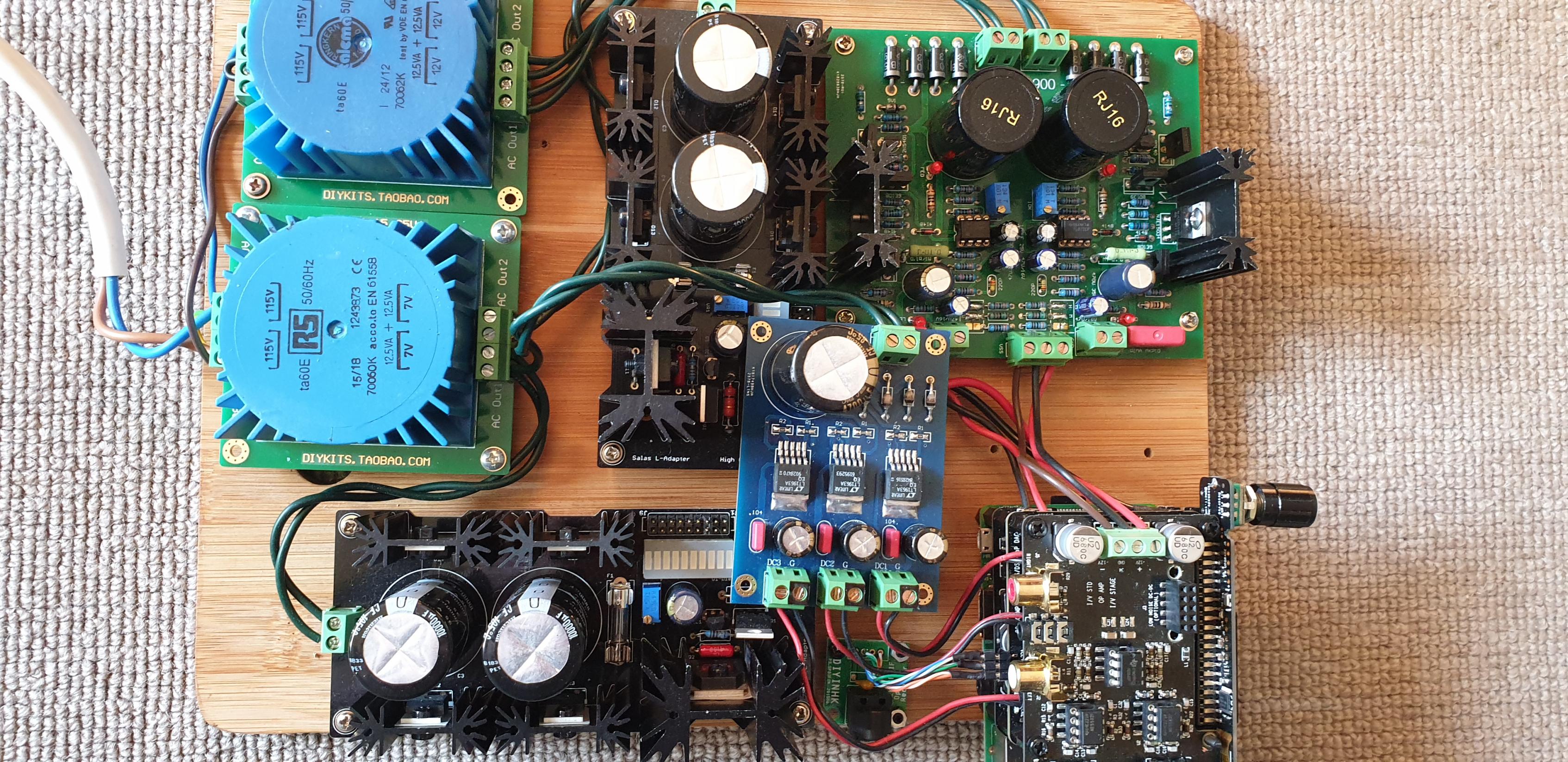

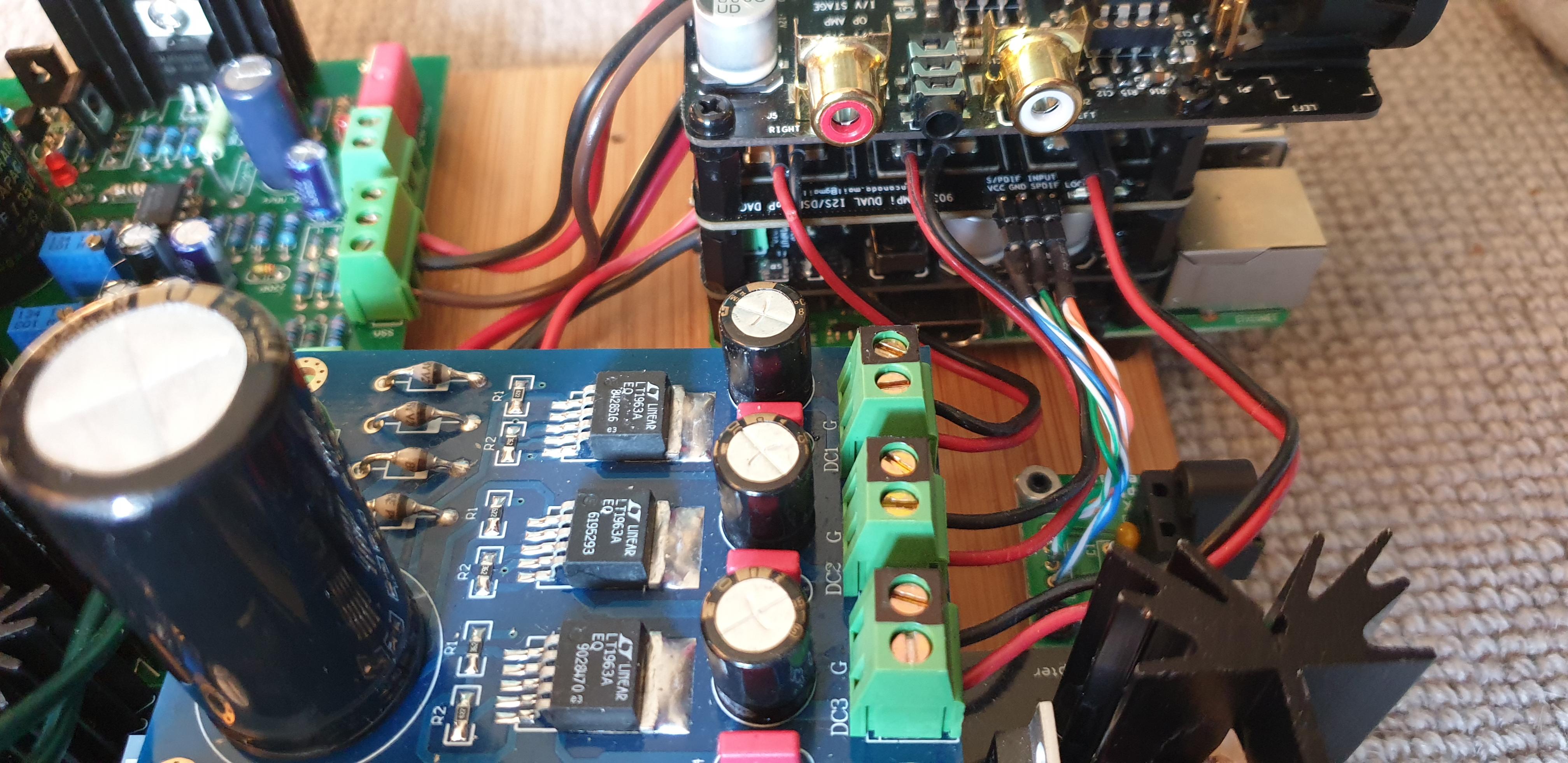

So here is my stack.
Rpi>Isolator v2> dual mono dac> ivstd
Salas L adapter > isolator powering Rpi
Salas L adapter > isolator powering audio
Ebay triple LT1963 > powering 3 rails at 3.3v into dac
Studer 900 psu > ivstd output stage.
All works fine though the RCA into my amplification. Running Volumio. No FIFO board so I am ASRC?
DIYINHK board here
192K Optical SPDIF receiver - DIYINHK
It is based on the TORX147 spdif receiver. I tested the VCC pad on the Ian dac and I do get 3.3v there.
I removed my optical cable from my other dac that is fed from my TV. Has never been problematic. Inserted into spdif receiver on Ian dac. No sound..no signal present on the display.
I thought maybe it is because the Rpi is powered and the i2s signals are priority. Although I hadn't booted Volumio.
Tried disconnecting power for the Pi from the isolator but it doesn't work at all.
If there is anything else required please ask.

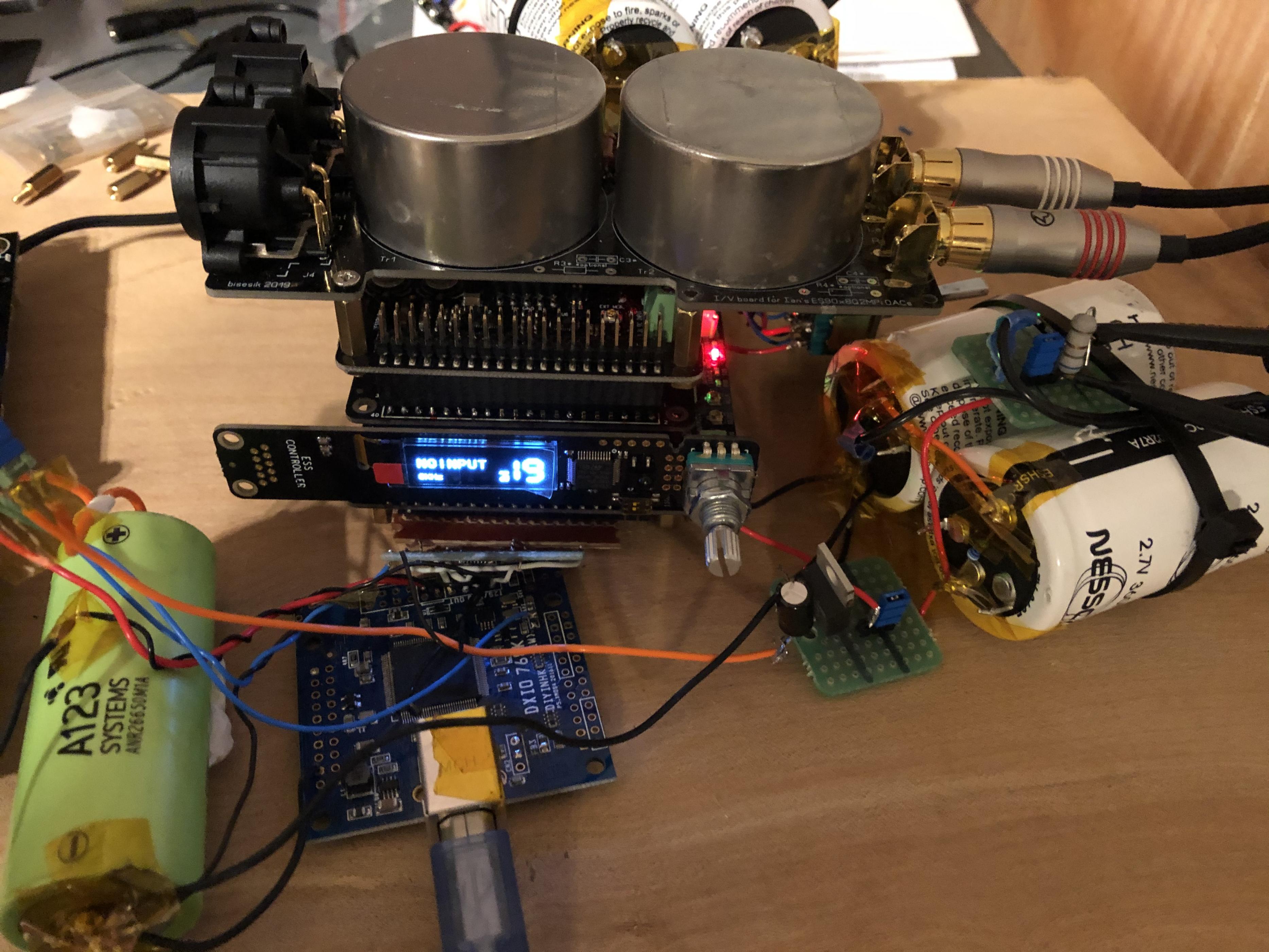

I’m working on this comparison test for a while. I'd like to share my results here with you. Sorry for the delay. I could be wrong. Just for you to reference. I picked up these three because they have the same configuration. I could have more reports for others down the road.
#3 eBay 600:10K audio transformer
I bought this pair of 600:10K transformers off eBay. They are not expensive but look pretty decent. I didn’t expect too much from them. However the real listening test did give me some surprise. They have all the sound signature of a typical transformer I/v stage. Nature, analog, peaceful and without any additional flavor. I would stack with them if didn’t experience the other two. I ran them at my LL1544A transformer I/V PCB with same schematic and same configuration. The only thing is that the footprints don’t fit very well. If I have chance to design the transformer I/V II PCB I’d like to make it compatible with them.
If you have never tried the transformer I/V, I would highly recommend this one as starting point.
