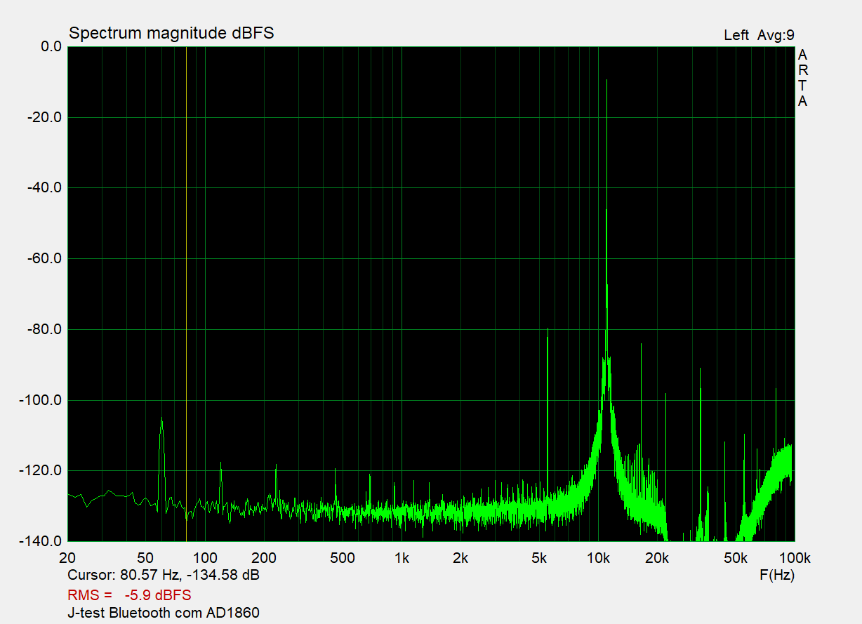

The concept of delaying the bits, even with 32bit frame, worked wonders with the YM3433.
But, the jitter quality of the Bluetooth board are atrocious. No wonder why the PMD100 and PCM63 falied also. These I not measured.

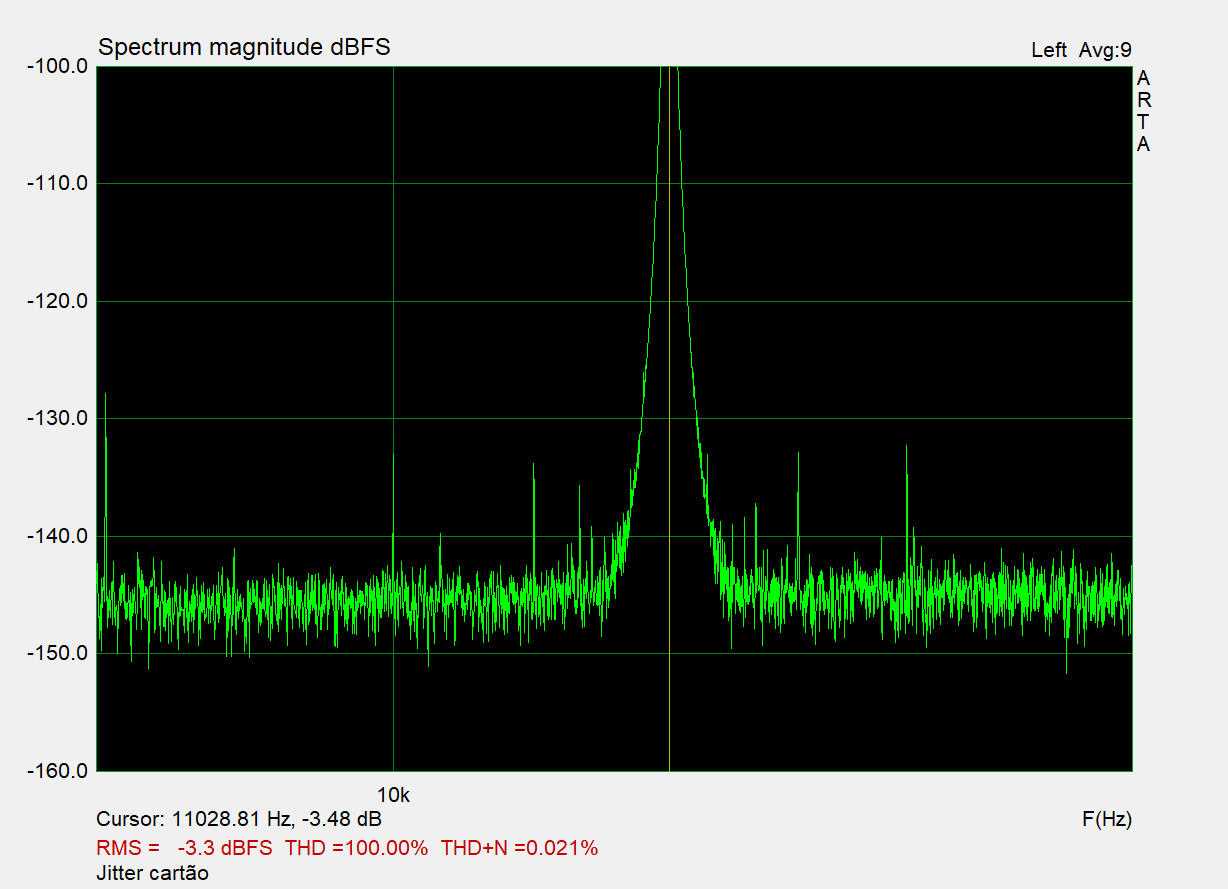

Here some measurements:
Jitter from card player part:

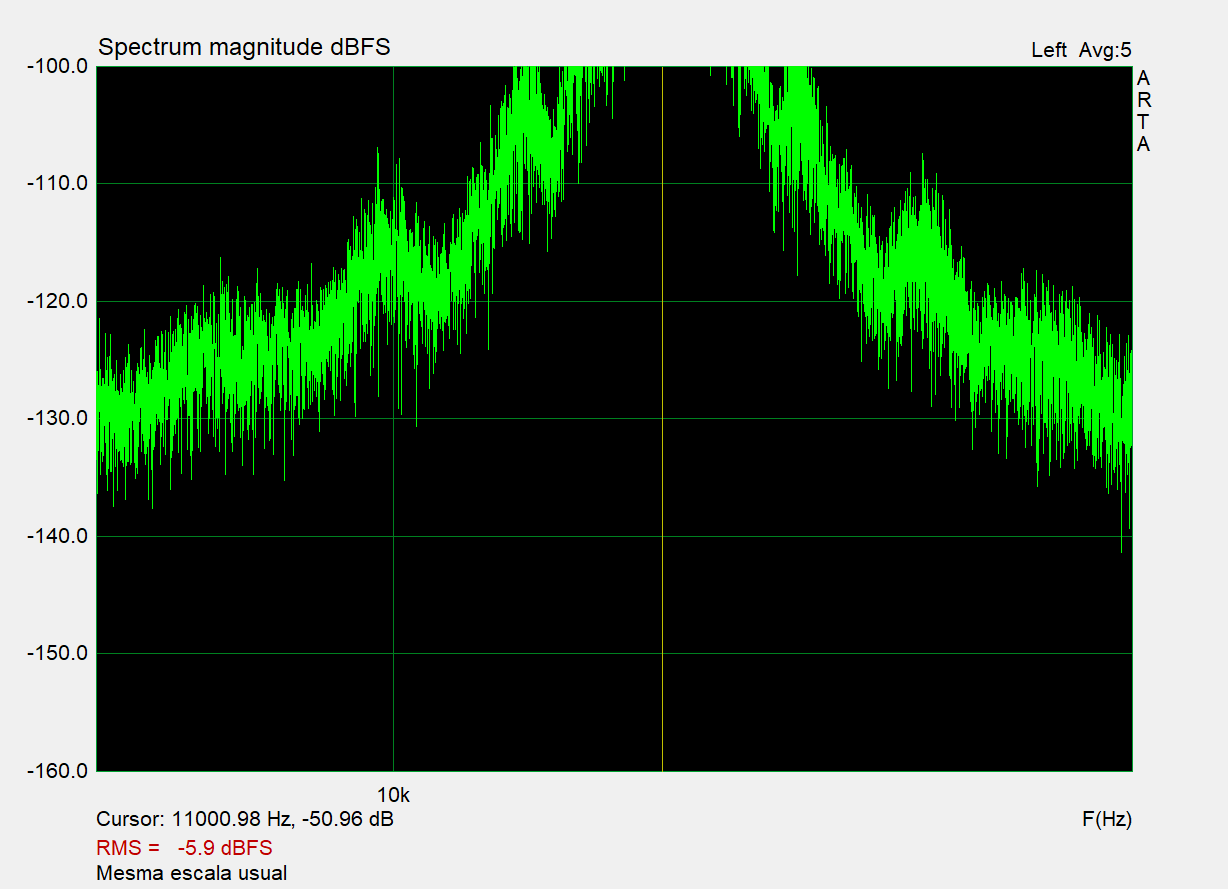

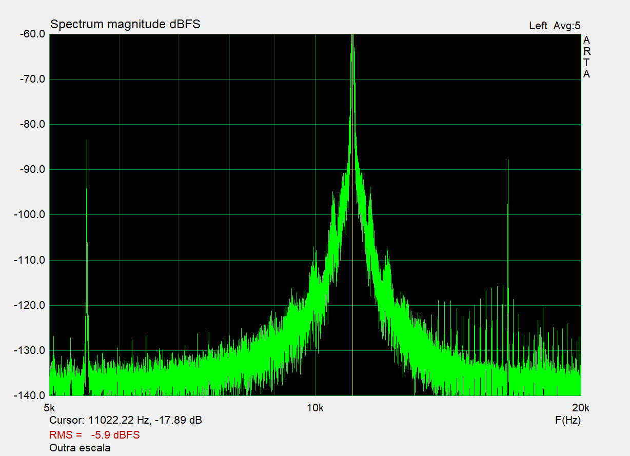

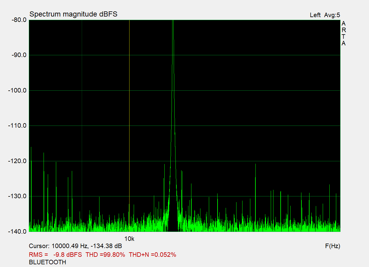

Jitter from Bluettoth (HEEELP):
Another scale:

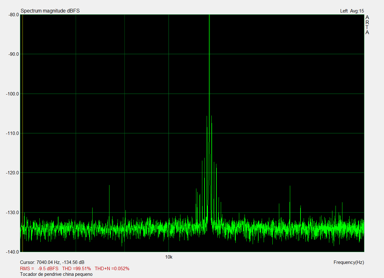

From one "all-in-one" solution (better):

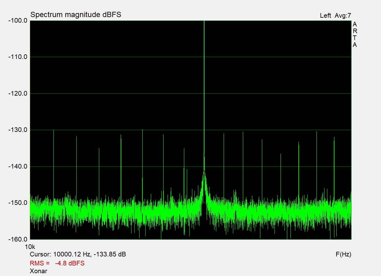

And, for a reality check, one from the same AD1860+YM3433, but using a old horse called CS8412, via optical link:
So is correct, the YM don't provides any attenuation of jitter. And the AD reproduces the LSB toggle bit ok with the CS interface.
