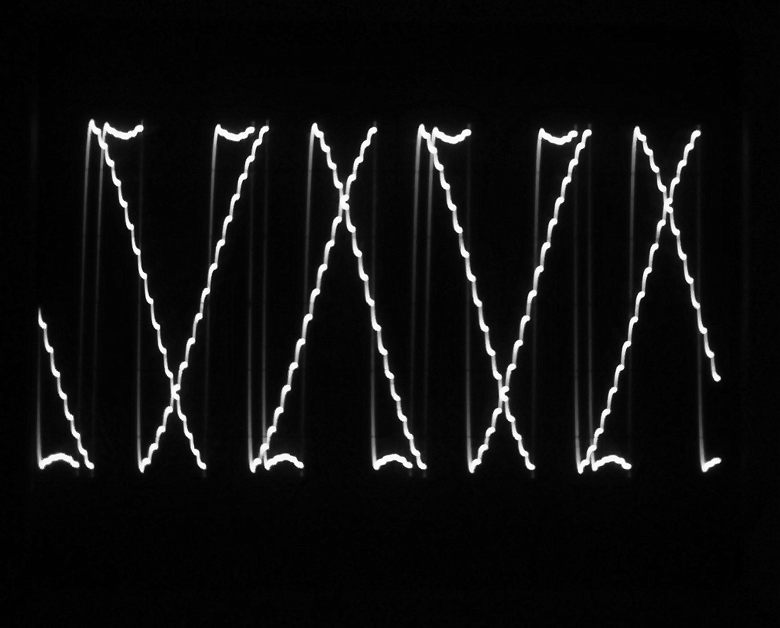

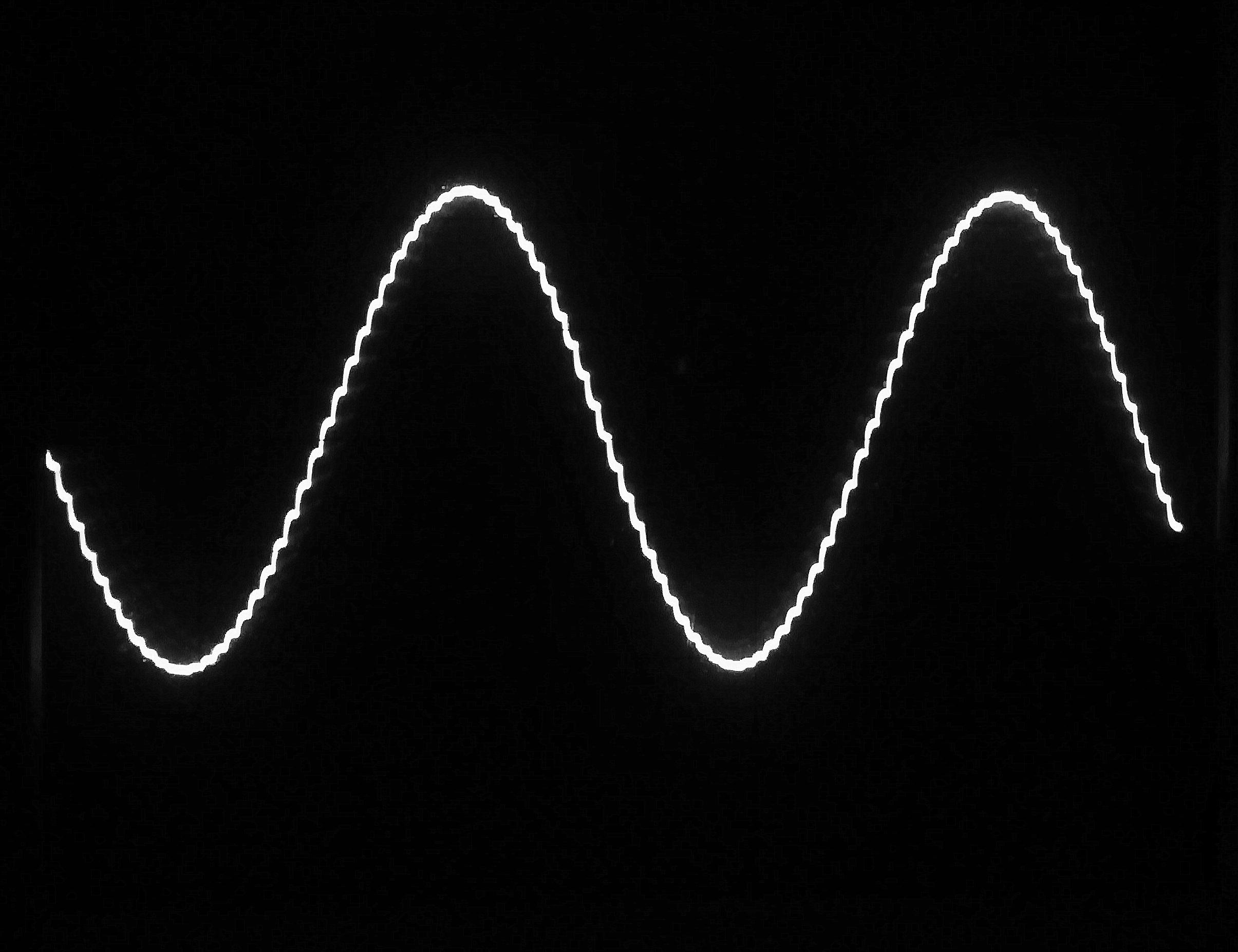

I made my first I2S-DAC board today. With TDA1543/NE5532 to start in the simple. I use a PCM2706 USB-to-I2S board. It sounds surprisingly well considering that the TDA1543 is about the cheapest audio DAC around (photo 1). But, when I increase the signal level on the PC (with Linux), the sound suddenly becomes heavily distorted very suddenly (photo2).
The scope-photos are takes with a 1KHz/0dB input signal. At a certain moment it seems like there is a register overflow, probably in the PC. Am I right in this assumption and is there something I can do under Linux to improve the situation?
At present I “calibrate” the PC volume using the 1KHz/0dB .wav file adjusting the volume at a level just below where the distortion appears. For the rest I use the volume control on the analog side.

I believe you are right, it should be in the driver or a mismatch of the PCM2706 with the TDA1541. It looks like the word is shifted one time too much towards the MSB (overflow) instead of being limited to FFFF as for ordinary clipping.

Have a look at figure 62 of https://www.ti.com/lit/ds/symlink/s...=https%3A%2F%2Fwww.ti.com%2Fproduct%2FSRC4392 for an overview of I2S, left justified and right justified. Putting a left justified signal according to the picture on an input that expects I2S would result in a one-bit shift and overflows when you exceed half scale, as well as a swap of left and right. As it's a Sony document, the signal lines have the Sony rather than the original Philips names.
