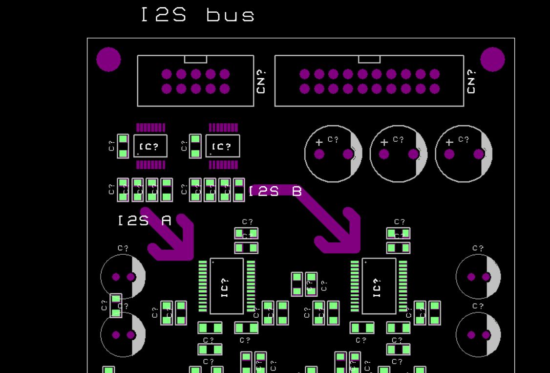

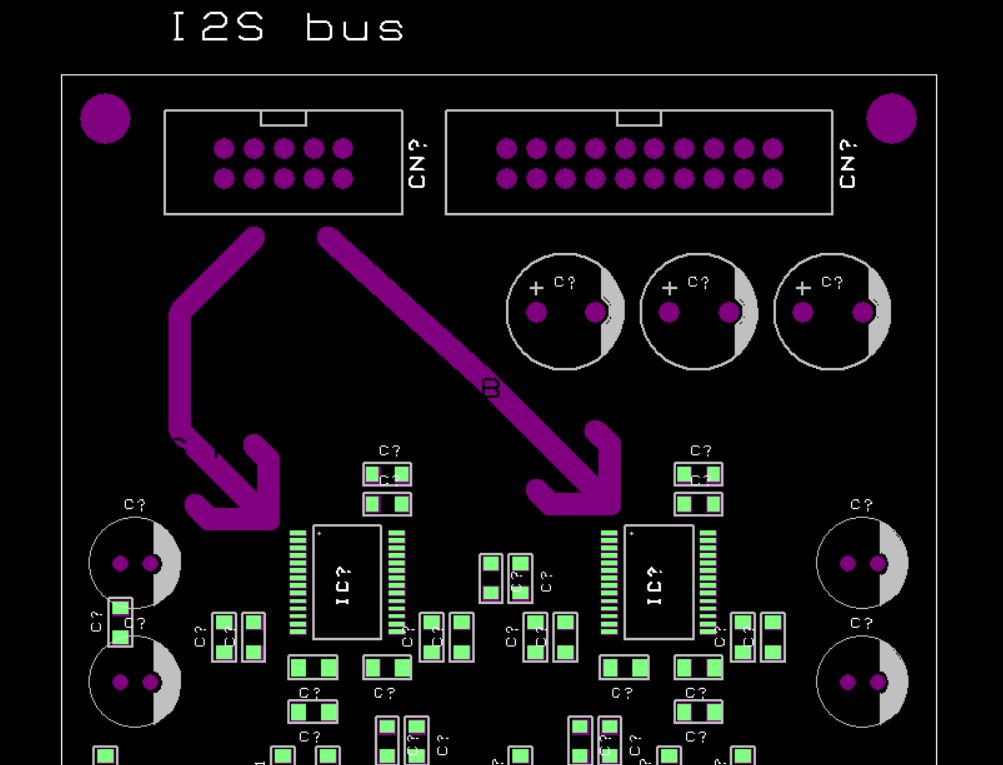

I would need advice how to lead I2S bus for 2 x DAC converter in monoaural connection. I2S input bus is isolated from xmos or fi-fo. I want the best possible quality and I'm not sure if it's better to use a parallel connection for both DACs without a driver or use driver for each DAC separately. I'm afraid about my driver, that it would degrade the I2S bus. If you recommend me a driver as a better solution, can you write me what type I should use to avoid degradation? The distance of the input connectors from the DAC is very small. I don't have enough space, so ideal SSOP package. DVDD voltage is 5V, the driver must be able to perfectly process the incoming 3.3V logic state. Or 3,3V and I will have to use another stabilizer for this driver because I don't have a 3.3V voltage on this board.
Can I use one driver for both DACs and output resistors for DAC-A and DAC-B or better for each DAC driver IC separately?

A fanout of x2 isn't a problem for CMOS chips. You could check the input capacitance for
the DACs in question and estimate the rise-time from that and the drive strength of the driver chip. Factor in the pcb trace capacitance too.
If the traces are short I don't see a problem. Any small increase in rise and fall times will be the same for all signals to a first approximation anyway.

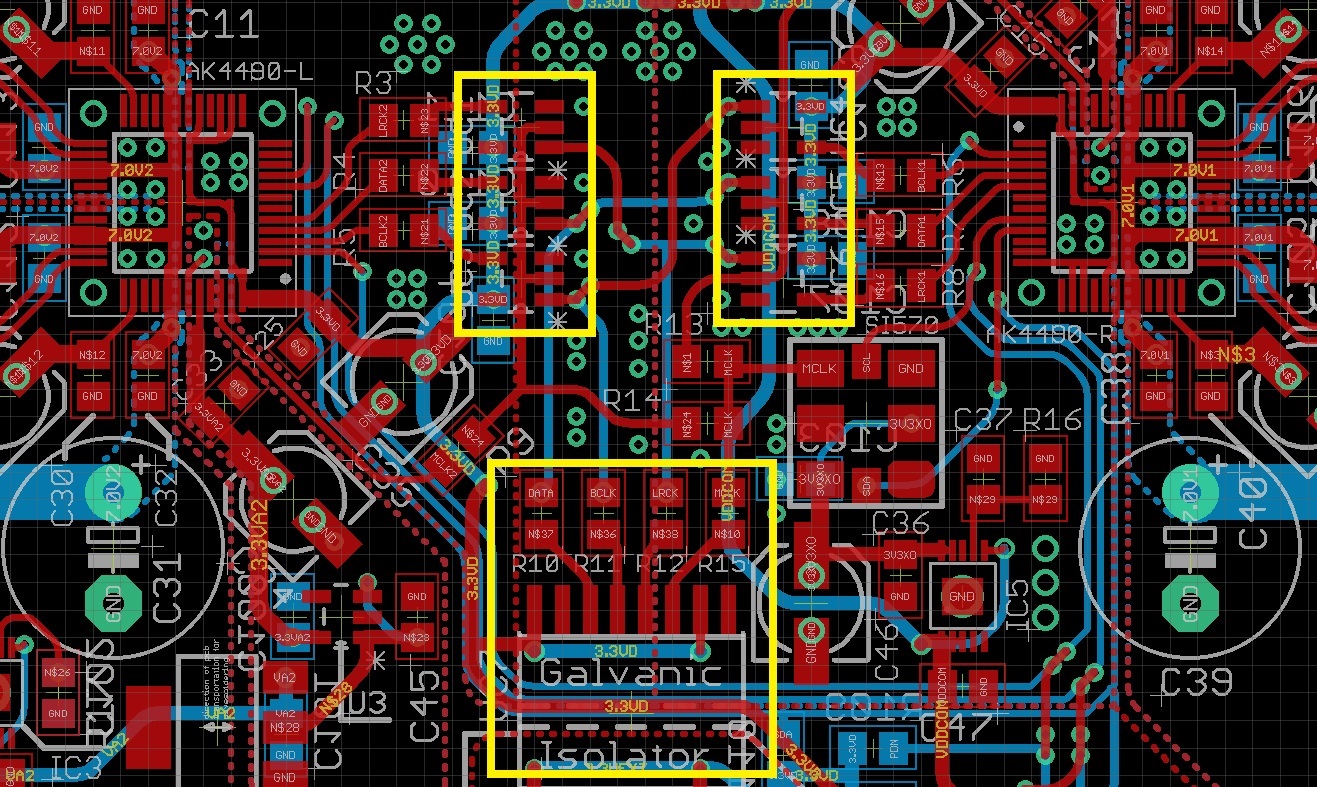

Is your i2s signal re-aligned after isolation?
If no, 3 flip-flops "reclock" for each DAC could also solve your problem. Take care about the flip-flops quality (&delay) and also about the maximum sample rate (related to the available MCLK freq.)

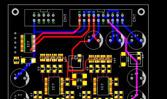

It looks very good with placement and connection in my layout. The signal will be isolated, I want to buy some usb to i2s converter, I haven't studied which yet. I will buy it as soon as I send the PCB to the production process. Several members here sell xmos where i2s is already isolated.
May I ask which specific circuit you used? I am also thinking about the possibility to use something from the production of tiny logic, like the NC7SZ125 and SOT23 package.
Thank you for your help

I used 74AUP1G79 from Nexperia, a single flip-flop in a chip, so there were necessary 3 pcs. for every channel.
For my next project I want to use MC100LVEL30 from Onsemi, 3 flip-flops in a chip, as a re-aligner chip for a FPGA based reclocker. This will be an USB asynchronous (XMOS), synchronous* FIFO reclocker. I have start learning FPGAs, and as much as I read about, as much I love them.
*synchronous means here that there will only be a small amount of RAM for FIFO buffer, but FPGA will tell to XMOS to slow down if the buffer tends to be full, and vice-versa if the buffer is going to be empty, so some sort of synchronicity between FPGA and XMOS.
I have another dilemma. My voltage DVDD is 5V. I can use SN74AUP1G79 but I will have to add a stabilizer. I can also use SN74LVC1G79 and 5V DVDD, which is slower. AUP family is 260MHz, LVC family is 150Mhz. Input I2S bus will be only 3.3V.
Therefore, I prefer to use one stabilizer from 5V to 3.3V and use faster SN74AUP1G79. Is this idea correct?
For MCLK I would use TINYLOGIC NC7SZ125.
Can you please check it? Do you recommend me keep the MCLK buffer or should I remove it and connect the MCLK without the buffer directly from pin input connector?
Thank you for help.
