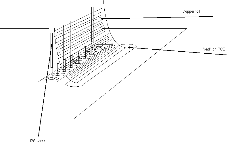

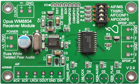

Another example of wrong digital design is Twisted Pear products. They use single GND wire for I2S connectors on their boards. This mistake creates horrorous amount of EMC energy, which both kills analog TVs and radios around, and as well denies the whole SQ gain of external DAC thing. To overtake the issue you should use copper foil tape - solder it on both ends directly to PCB near the connector, and wrap the cable with it. Then you'll get both good EMI shield, good ground and good low semi-controlled impedance.
You can't use a short wire to connect the foil to circuit, you'll need to scratch the board to get to the GND layer directly near the connector, and connect the foil directly to it.
G'day s3tup,
Just wondering if you can post a pic or drawing of what you mean as I have a B III from TP, would like to look at what you are mentioning. Sounds like both ends of the foil are soldered to the same ground point on the DAC board and then wrapped over the incoming I2S lines, though this doesn't make sense.
Can you please advise?
Much Thanks,
Drew.
See attatched.
The copper foil is soldered to "pad" on the pcb, near I2S connector, and then being sticked to I2S wires + wrapping around wires.
The issue looks this way:
On the board above, the "I/O" port goes as follows: GSSSSSSSSS where G is gound and S is signal. In general, you need at least one ground wire for each signal wire, and need to arrange them in "GSGSGSGSGSG"-style on the cable.
Connector should look like this:
SSSSSSSSSSS
GGGGGGGGGGG
OR
GSGSGSGSGSGSG
Your's B3's ports look better, in
SSSSSSSSSSS
GGGGGGGGGGG
style, but i'm not 100% sure the second row of each port is connected to ground. Check it out, and if they are connected to ground, use flat ribbon cables, and stick every 2nd wire into GND pad.

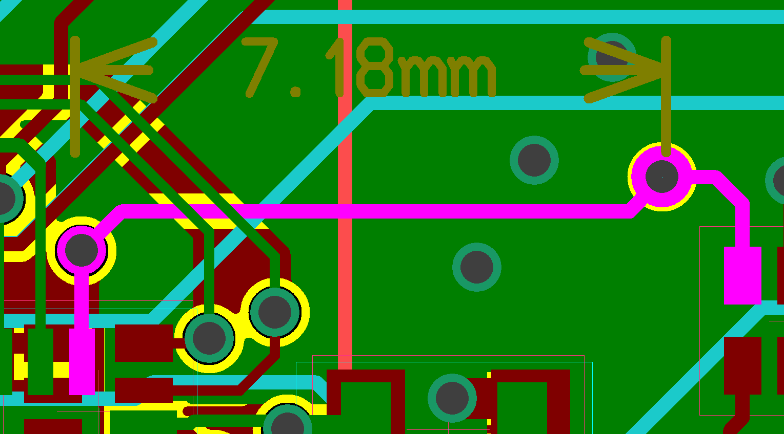

I wonder if anyone would be willing to have a quick look at this and answer some very simple yes/no questions.
It is an example of what, to me, looks like routing that needs to be much improved. Is it very bad, bad, okay, or not-to-worry ? I know it's not great.
There are numerous kinks and vias and the terminating resistors, although smd, are at the receiving end.
The transmitter is Altera Cyclone III EP3C16. The datasheet says Iout for each pin is 40mA, which seems quite high to me, but basically it seems to be quite a low impedance output. Have I understood this correctly ? Does this mean the routing and termination are acceptable ?
http://www.altera.co.uk/literature/hb/cyc3/cyc3_ciii52001.pdf
Thanks for any comments. Much appreciated !
Without the schematic and knowing what the devices are I could not comment on the placement of the resistors, though series should always be at the transmitter end.
As to the routing; there is nothing basicly wrong with the signal routing, it looks like any standard digital board. What are your concerns with the signal routing?
What would be of concern to me and would require sorting is the copper pour (GND) between the signals, if you look closely you will notice that there are numerous slivers of copper pour that do not have stiching vias at least at each end, these for dipole structures on the board, not good for emc.
So to sumerise, the signal routing is standard for digital, it will not cause any problems whatsoever, the ground copper pour though does not have enough stiching vias (to one would hope a full contigous ground plane on an inner layer) and there are long slivers that have only a via at one end.
Thanks for the reply.
My concerns are really because it is a high data rate, a 2-layer (probably cheap) PCB, the terminating resistors are quite large (100ohm), and there are numerous kinks and vias.
I saw the gnd pours and I hoped these would be beneficial but perhaps it'll need some work. I have a scope but only 12Mhz, so it might be tricky to improve it if it's a lemon.
I'll give it a go though.
Thanks again for the comments.
Its not going to have to high a data rate, so I would worry to much on that score. If the waves look OK (dont forget to take into account your scope probe loading) then I wouldn't worry.
Series resistors are there to match the signal to the layout topography, so there is realy no off the shelf value, it depend on the layout topography andf impedance, there are only two ways to determine the value:
Simulate the design using signal integrity tools and choose the best value, or try different values and see which gives the best measured result. Attached are some screen shots showing the actual difference different values of series resistors make, in this case 82R was chosen.
Vias and Kinks in traces will have no noticable effect on signal integrity at frequencies and rise time the DIYer is gonna be playing with, but with good layout you can minimise the number of layer changes a signal has between A & B.
My main concern would be a two layer board, these days ALL digital designs should be 4 layers min, with a full contigous ground plane. The main problem these days is signal rise time, which are forever getting faster and faster, and ultimetly it is the rise time of a signal (suignals) that determine whether a design is high speed.
Yes ground pour help if they are done correctly and are a must for two layer digital boards, but they need lots of stiching vias to be of any use.

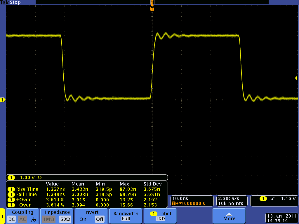

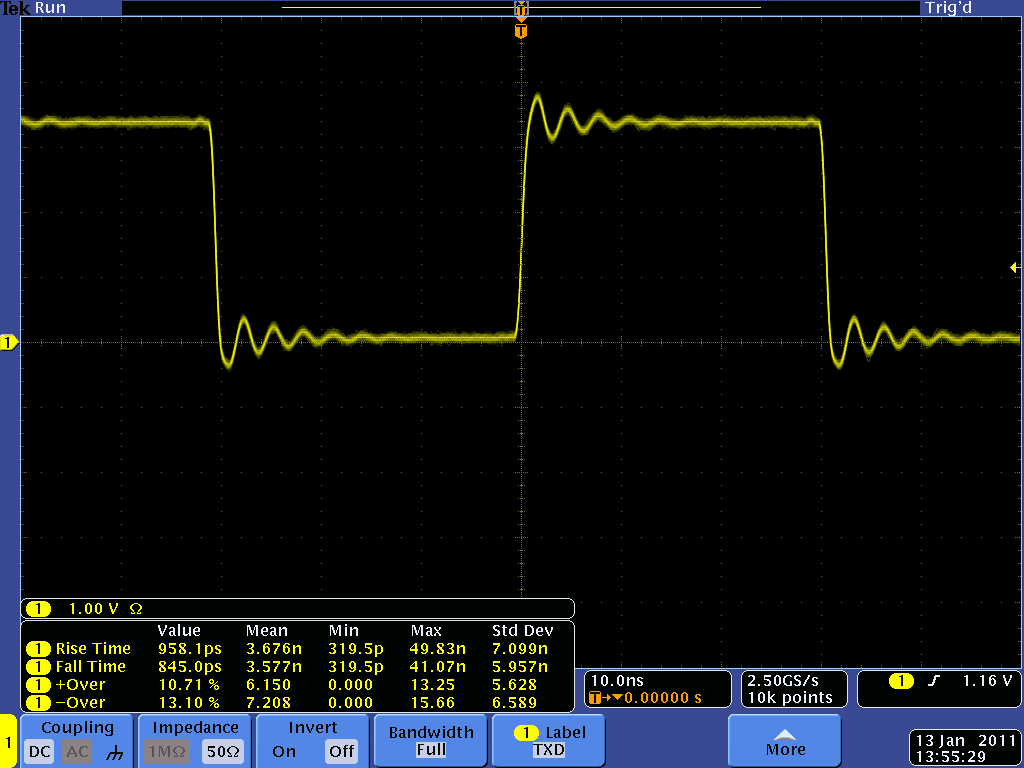

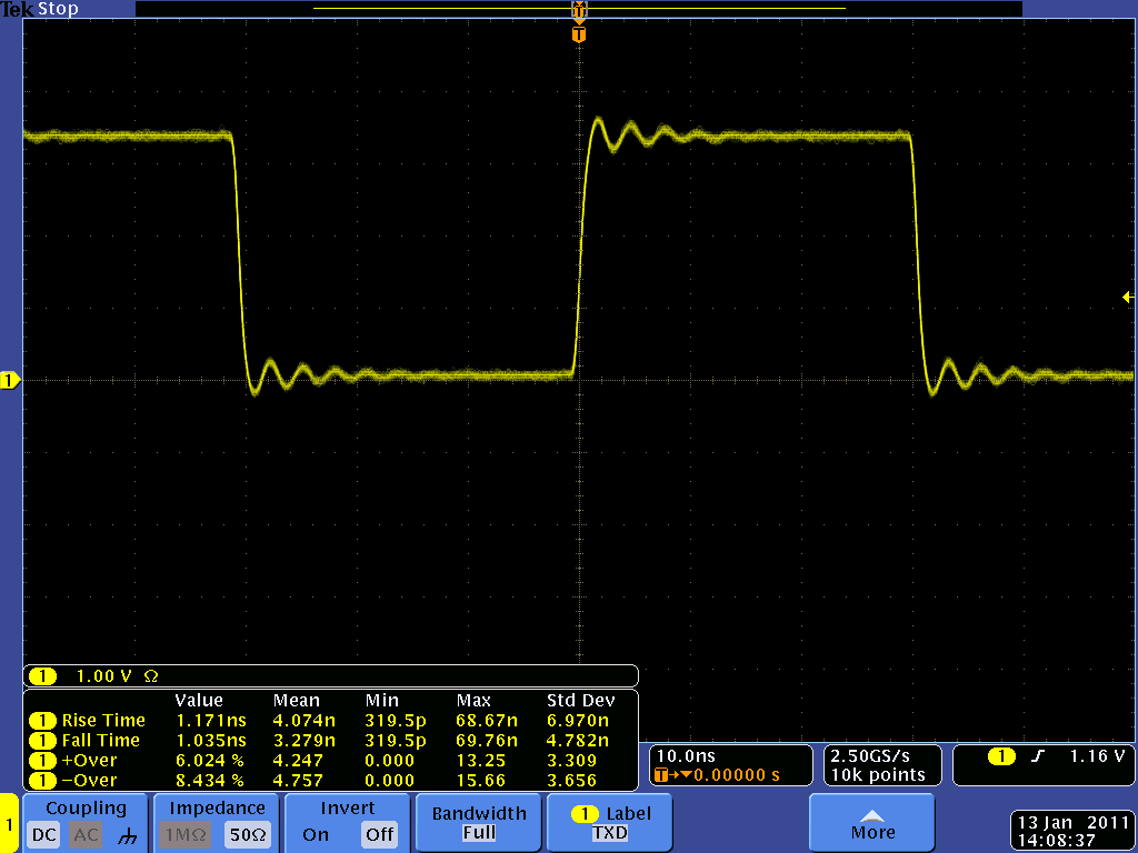

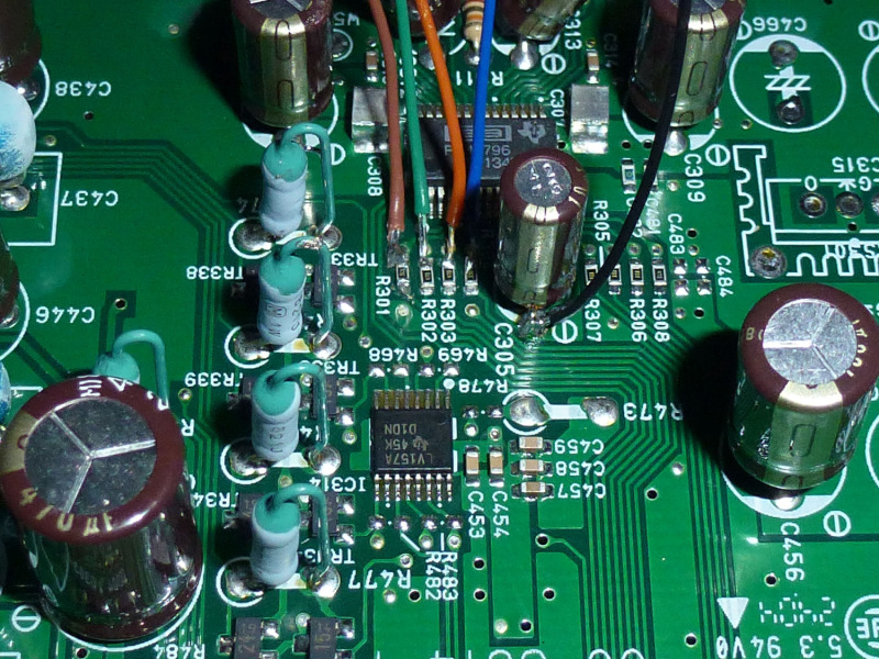

Greetings to all. I am exporting I2S/DSD to an external DAC from a Denon 3910. I tapped between the resistor and PCM1796 DAC chip because at the time I had no idea what they were for. (Still learning....).
No problem, I layout PCBs every day of the week and have done for over 25 years now, and do a lot of high speed, SMPS and hi reliability PCB layouts. I have always got this info to hand, not only for use at work, but for a PCB forum where we get asked the same questions repeatably.
