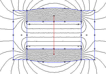

i narrowed the gap from 4" to 1" to recover field strength.
the maximum peak to peak excursion ( space between front and rear magnets ) here would be 0.5"

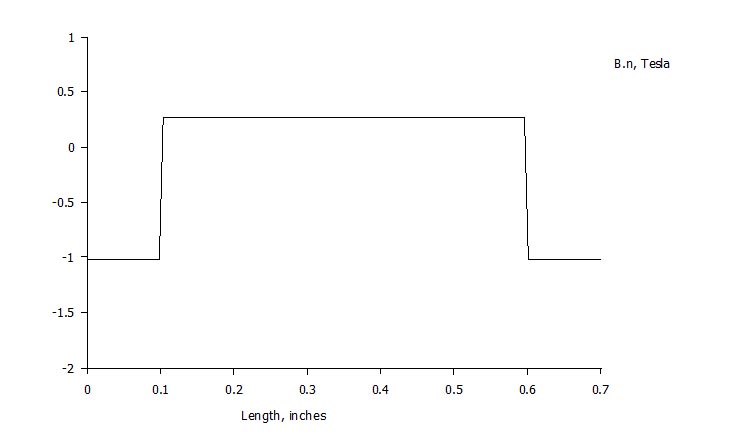

i made a plot of the field along this red line:
which looks like this:

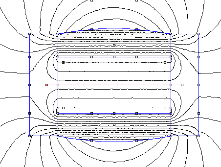

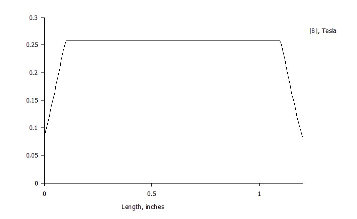

and along this red line:

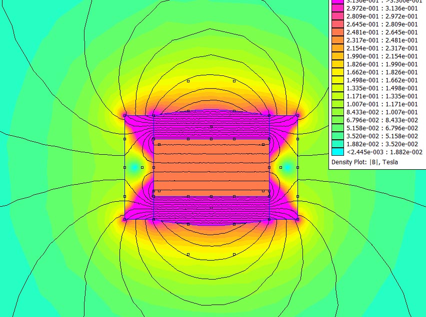

so in fact the technology allows for the same kind field strength levels as you would expect to have in a conventional ribbon but with absolute linearity.
as for the argument that magnets in front of the ribbon would interfere with sound - the AMT drivers such as Beyma have sizeable obstructions in front of the "ribbon" and nobody complains.
