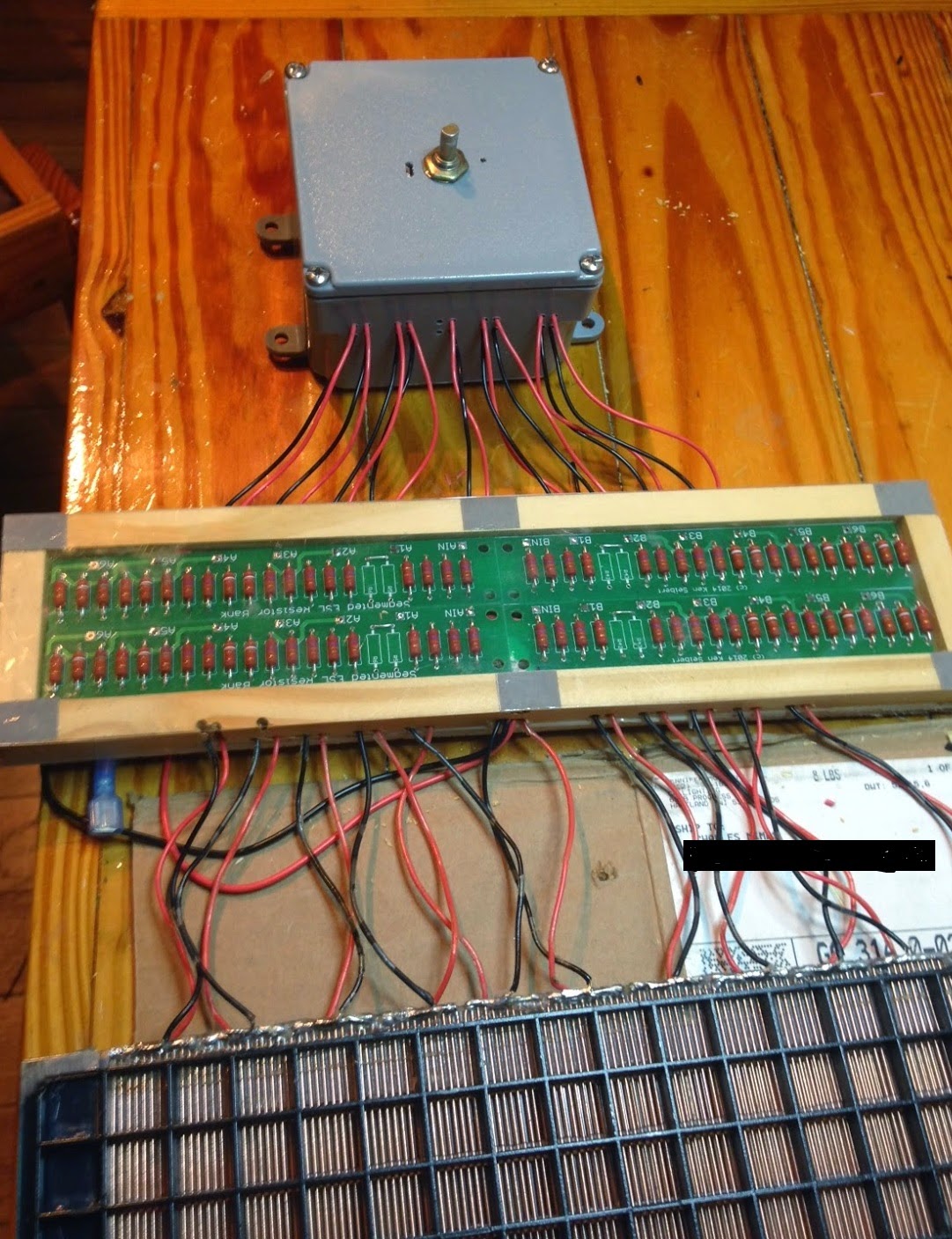

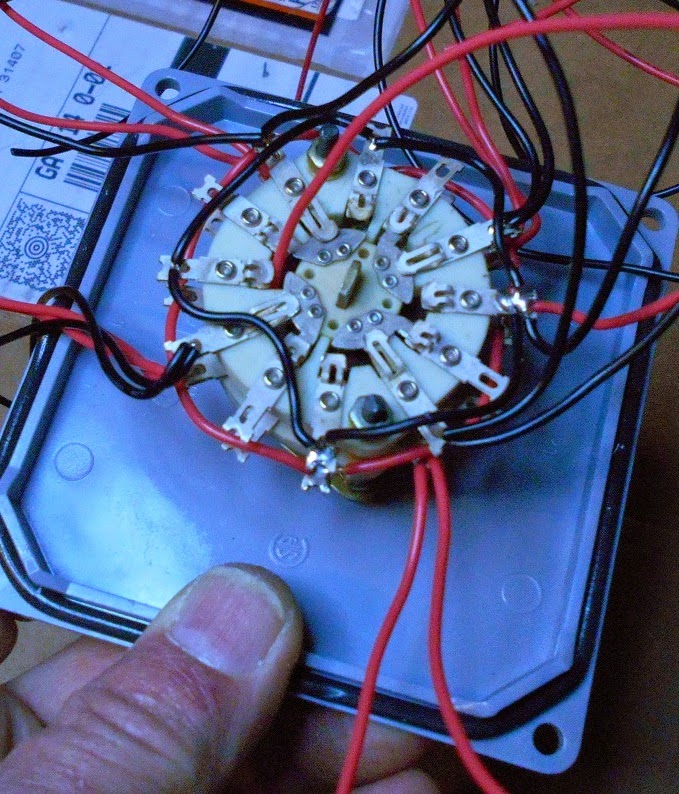

I can't quite picture what it is you want to do but it sounds like you want to place a switch on the HV side of the transformer. I've actually done this:
Some years ago I built a segmented ESL with welding rod stators, which I configured with switch-selectable wide and narrow dispersion modes. This was accomplished by placing a multi-pole rotary switch on the HV side of the transformer, to jump over or leave engaged the segmentation resistors.
Switch ON jumped resistors and put the panel in NARROW dispersion mode. Switch OFF broke the jumpers (resistors now in-circuit) and put the panel in the default WIDE dispersion mode.
The switch was an 8-pole Soviet military rotary type with silver contacts, rated for 300VDC, which I purchased for cheap on Ebay from Belarus.
The switch-mode feature was fun for a while but the novelty wore off pretty quickly because switching modes required powering down, lest arcing destroy the switch, and then I had to re-EQ the panel each time because each mode gave the panel a different frequency response curve. On my later builds, I've omitted the switch mode feature in favor of wide mode exclusively.
The 300 volt switch proved to be reliable -- but I never opened or closed the switch with kilovolt current passing thru it (always powered off first).
