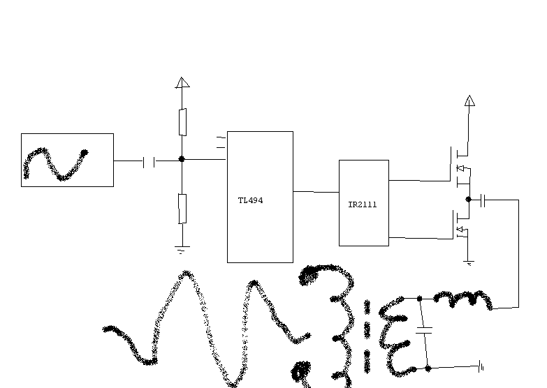

another option is to use sinewave oscillator, push the sine into tl494's 3 or 4 pin (dc biased) -> ir2111 -> mosfet bridge (half or full) (6 or 12V transformer) -> active lpf -> sinewave inverter 🙂
tl494 must be single ended output ctrl. (wider range of duty cycle)
another possib -> lm393+timer555 instead tl494
its possible even with only 555.
try to plug your on battery, it will empty the battery for a moment 😀
This solution will not produce heat at all !!
