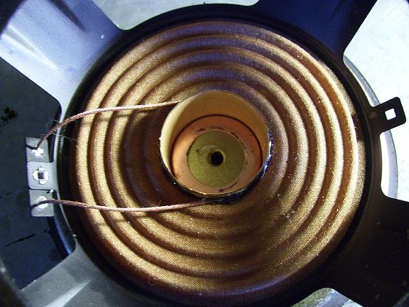

Well the balsa wood I got is too soft. I know there are many hardnesses of it. I will have to find a hobby shop and not buy online. Since the various cone treatments I put on a pair of super 8s would not come off, I decided to cut off the cones to look at the construction. The shorting ring is visible.
Somewhat radical design ... but surely has only little
problems with cone breakup. 😎

The front horns are Oleg Rullit's propriety design, you can see photos of the horns here.
12" field coil pictures from woodworking photos on webshots

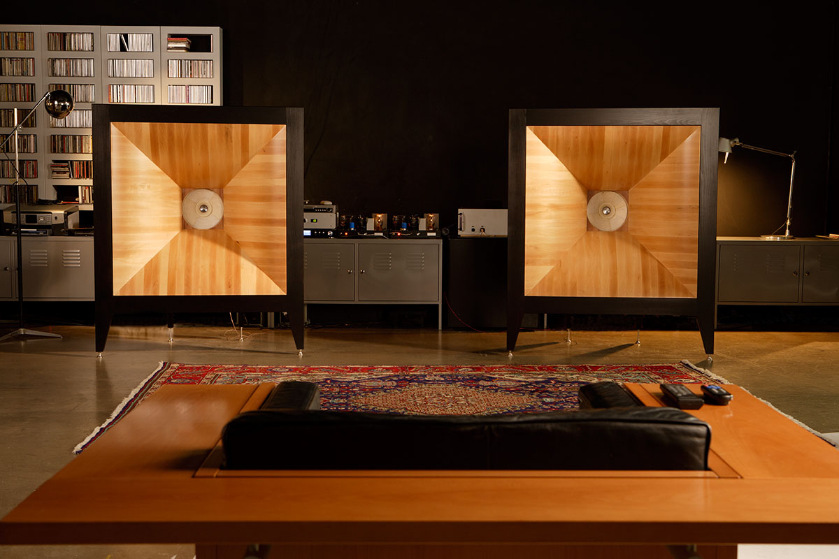

Some pictures of the horns for the Rullit drivers:
In the shop before drivers were installed.
John
John

These are the most realistic speakers I have heard and owned, the massive horn allow every detail and nuance come through, the breath of the singer, the decay of the note of an instrument is uncanny, I am done with searching for speakers, the wood work by master furniture maker jlsem is exquisite.
Hey Shooter,
They look Gorgeous!
What is the system driving them?
Cheers
David
