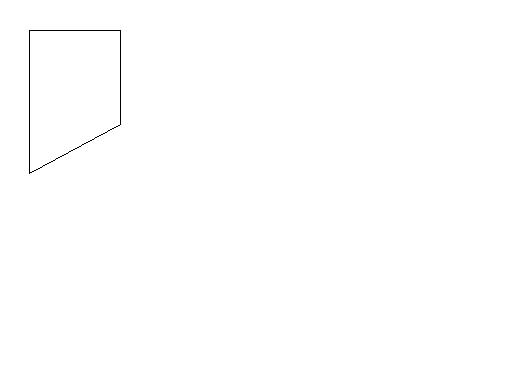

The GRF's would be nice but a tad big for the room.
Could I make a single sided version with it venting down the wall towards the listening position?

Well, yes and no! You'd be designing an entirely different system.Could I make a single sided version with it venting down the wall towards the listening position?
