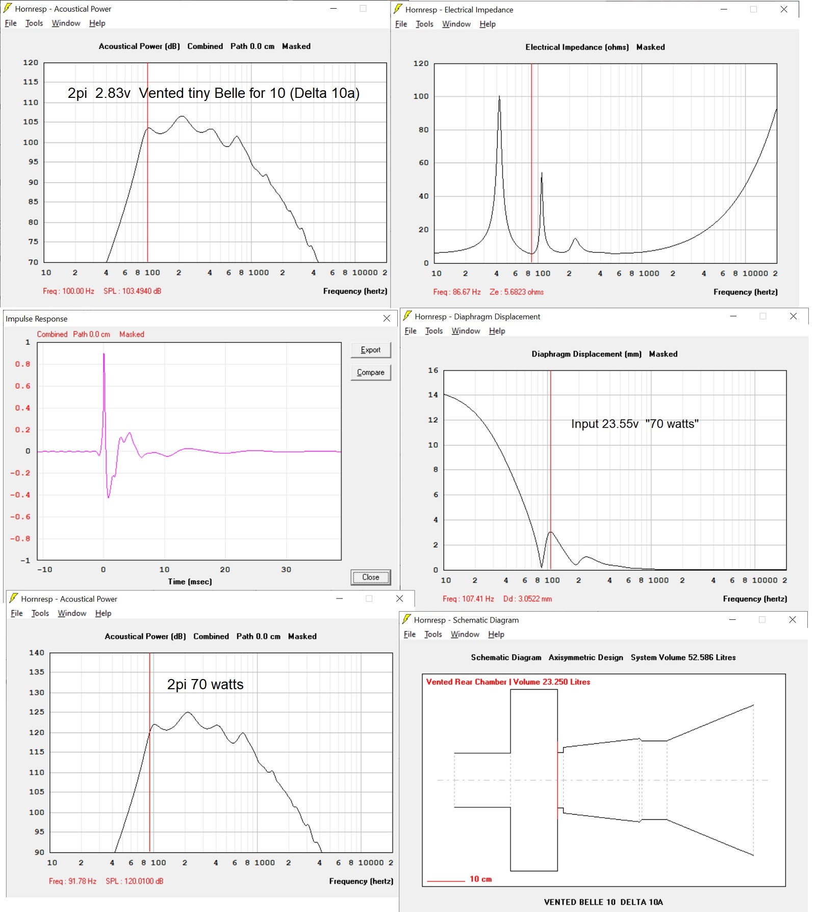

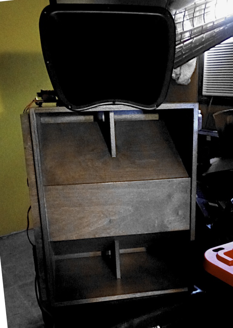

about the size of a Karlson Twelve with upper bulk limit at 25.25"x 18"x15" (could go taller aspect) and ideally pack a 12 inch driver. (Kappa 12A) A Klipsch Belle at 0.83X scale is close. and at 2/3 scale would be tiny and could be vented with a 10" driver.
I'd appreciate alternative horn - especially if you've got one drawn up
I know it would make noise as my 0.83 Belle (too pretty to drag outdoors and a bit heavy) sounds really good with 12pe32 and a 1.2" neo Beyma driver horn on top.

A problem with little W-bin is mounting the driver - back chamber gets really tight. IIRC, the Acoustic w-bin has a removable back chamber.

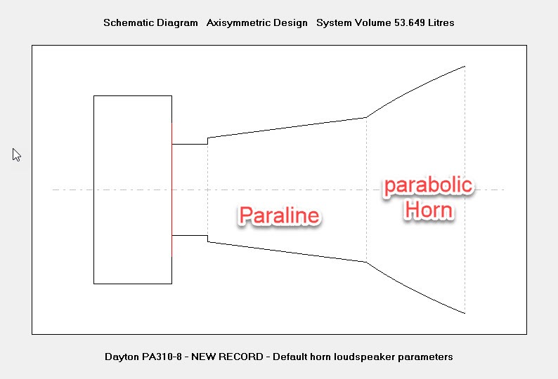

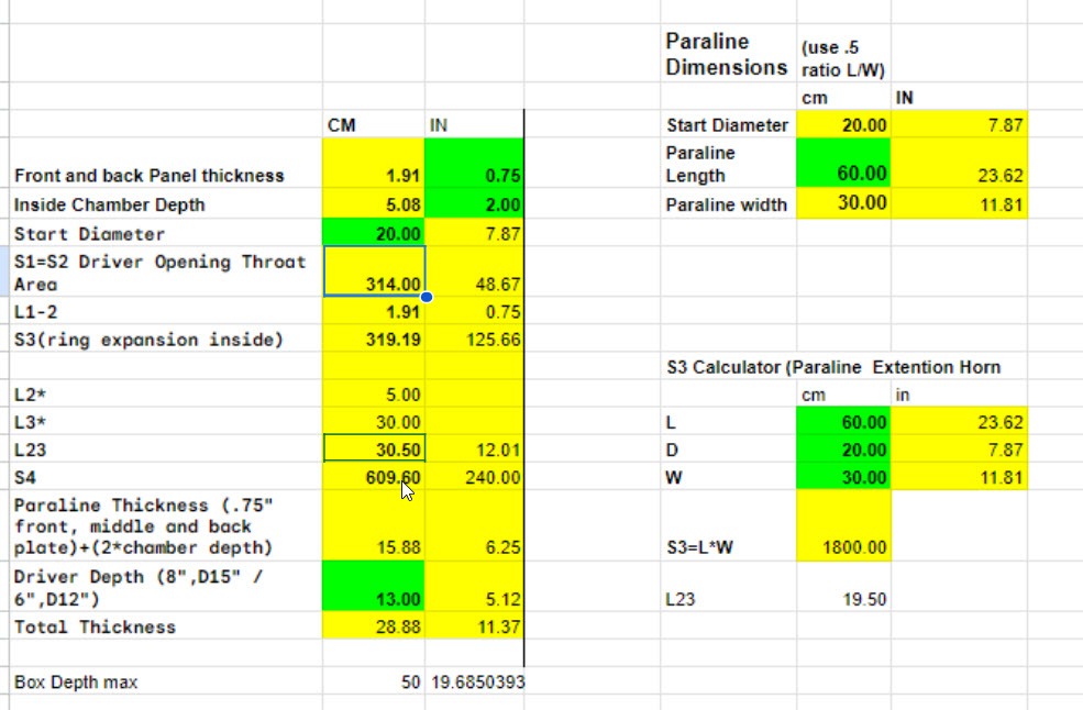

One design I have played around with is using a large version of the Danley paraline concept. Basically the exit line would be horizontal and with horn loading at exit, thus a big line areay source would be the result. I have an excel spreadsheet I used to calculated the equivalent horn the paraline lens would make. Have to look it up what results were.

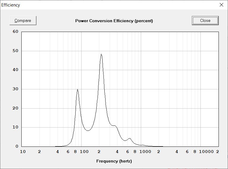

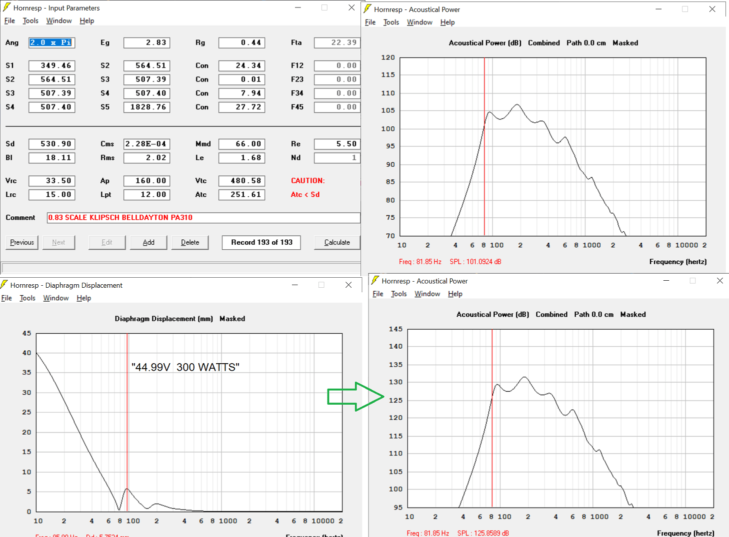

Here is something that I have been working on, Dayton PA310-8 coupled to a 24" tall x 12" wide paraline lens that has then coupled to a simple 24" tall x 12" wide parabolic horn wedge. The box works out to be about 24" tall x 13" wide x 19" deep. The response is peaky, but I would be using some DSP to flatten it out. The paraline lens and parabolic horn basically gives you a horn that is 20" long. I need about 100hz-400hz for my application since it would be using the Bill Fitzmaurice T24 Tuba.
I have considered venting. I guess I’ll look into it more as since I am crossing to a sub, I was concerned of the port phase and sub interaction, but maybe I could just crossover before the port, so it’s really about unloading the driver.
One thing I was considering is taking your scaled belle and fitting the paraline waveguide into the Belle, therefore you have a line source coming out the back into the w-chamber. It will Ada few inches in depth, but far less than a straight conical expansion. I’ll see about modeling that.

@dr suad -might you draw a rough concptual sktch of how the paraline fits into the scheme ?

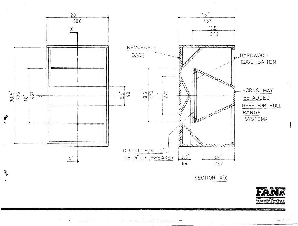

Hi Nigel - I'd love to have that Fane horn - too large to ship money-wise - I've pretty much lst all strength in both arms - frozen shoulders awful tendon (?) pain up and down both arm,s from shoulders to wrists -bet it would be lots of fun for bass guitar.
