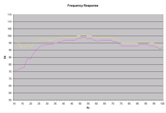

Here is a sonosub I just built with a single Avalanche 18. 700 liters, 6'9" tall, 28" diameter tube, tuned to 14.75hz, with 600 available watts.
http://web.ics.purdue.edu/~scallas
I tested FR with the sub at least 8 feet away from the nearest wall with the meter 3 feet away from the driver - tested in 1hz increments at close to 95db is attached. Incorrect meter correction values account for the slight dip in the low end. Pink is raw, yellow is corrected.
Judging by this FR, WinISD and Unibox predictions are most likely correct. This means that with room gain, I can do over 120db flat down to 15hz, and get over 105db at 10hz. I have everything ready to go for the second one, but will probably wait for a house to assemble it.
You will never use 130db at 10hz because no material has a hot enough signal that low without driving your speakers at a similar level. So unless you listen at about 120db reference level, in which case you're deaf, you'll never get to use it. But I can understand and sympathize with your desire to go low and loud. No need to spend massive amounts of money or use tons of power. If you have a router, two of these and a capable amp will cost you $1300. I paid a little extra to get the MDF cnc routed.

BTW, nice work Steve, that's a good way to have huge internal volume and keep the size reasonable. Your frequency response is quite flat, nice work again!
http://www.diyaudio.com/forums/showthread.php?s=&threadid=63509
Thanks, the Avalanche 18 can do some amazing things with the right enclosure. Aside from maybe a horn design, I doubt if any other single driver sub can match this in terms of spl and low frequency extension for anywhere near the cost. Once I assemble the second one, my bass capability will have no limits - assuming I don't watch movies at 120db like Audiophilenoob 🙂

95Honda said:Throw the Winisd predictions out for these kind of SPLs in a room....
I think along your lines of bass levels and I'll tell you what I've come up with so far. I wanted something that was really flat and played low also.
I used a pair of the original Tumults and put them in 7ft3 boxes and tuned them at about 16Hz. Each one has a dedicated 2500wrms power amplifier, with thier own 30amp circuits. My room is around 15' x 12' with an 8' ceiling. At 20 Hz I could reach about 125db (on a Termlab) at my listening position with the amplifiers driven all the way into full clipping. At 20hz around 123db. At 16 Hz around 120db.
Let me tell you, it is pretty loud.
I am also looking into 4 18s soon as the Tumults no longer have enough output for me. I think it would be the way to go...
I never liked IB even in these situations, I've tried it, I don't like it.
Sealed is out of the question...
T-Lines get really long.....
LT? You gotta remeber the levels you want, only do the LT if you want to waste a bunch of money and power....
XXX? add some weight to it or tear out one of the spiders..... I have used them, they are beasts. Also, at 10Hz, your just more or less a big air-pump, pump the air, make bass.....
Go big, go ported, go with tons of power, tune low, use as many woofers as you can afford and don't look back....
thanks for the advice... the termlab is a far stiffer mic than WinISD would predict 😉
you must have some serious bass in there
