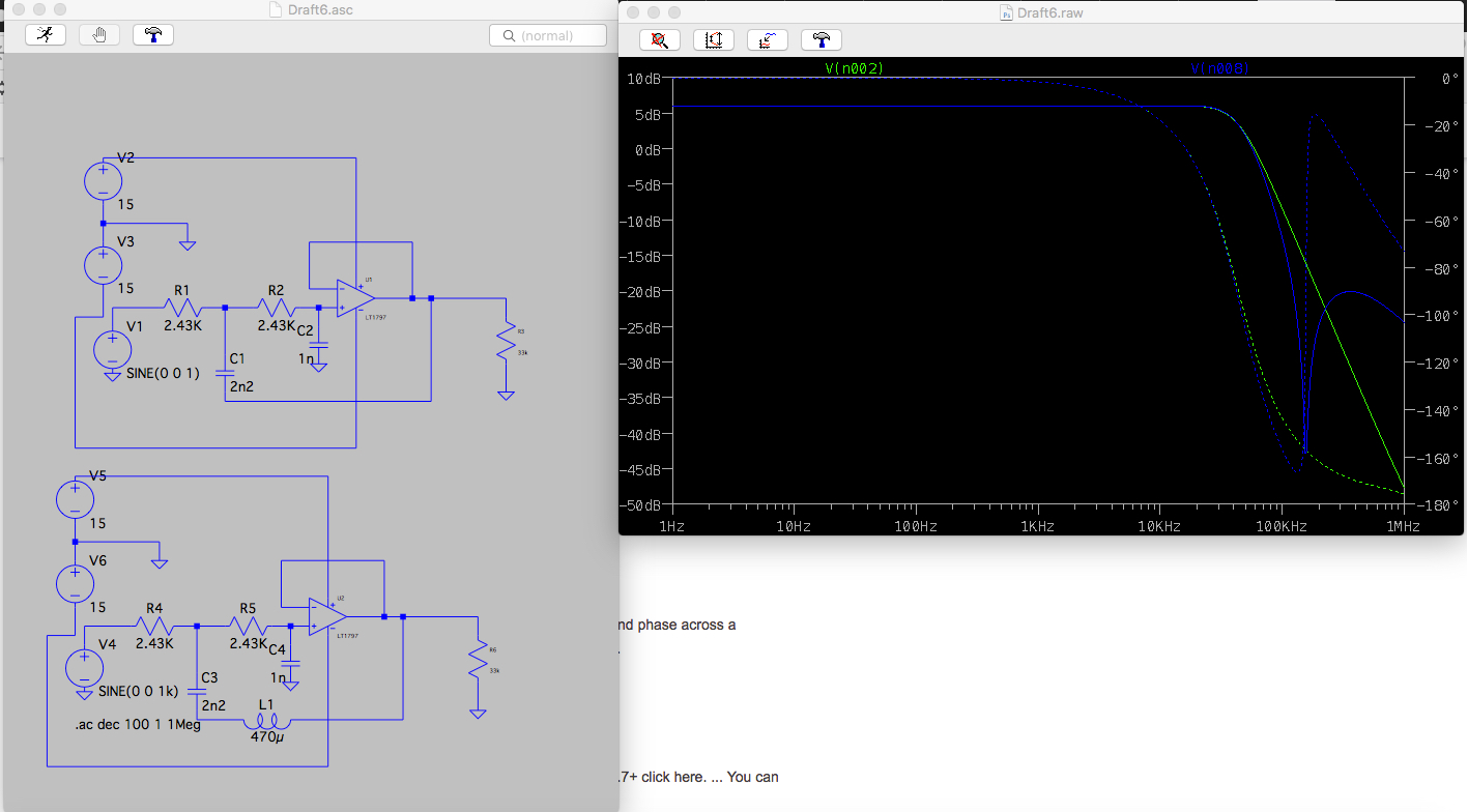

For thouse of you that are interested the bode pots are attached. Green is without the inductor.

Is the zero at 176.4 kHz?For thouse of you that are interested the bode pots are attached. Green is without the inductor.
