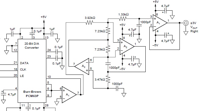

Hi, please don't mind I attached my question here also.
I have little electronic background.
The image below is the reference output stage in PCM63 datasheet.
I would like to replace the non-inverting input I/V op amp to an inverting input I/V op amp (ADA4627).
I know inside PCM63, between pin 9 and pin 10, there is an internal 1.5K Ohm I/V feedback resistor.
I would like to ask, if I use inverting input I/V op amp...
a) Can I still use this internal 1.5K Ohm I/V feedback resistor?
b) Should I ignore pin 9 and pin 10 entirely and use an external, different value I/V feedback resistor? What value?
c) Should I add an parallel feedback capacitor? What value?
Thanks. 🙂

You can use or ignore the internal feedback resistor and its pins. The diagram is wrong in that the +/- pins on the input I/V are switched, hence it is an inverting stage. Page 8 of the PCM63 data sheet shows the correct connection using an OPA2604. This is also a JFET input opamp like yours, that on page 11 Figure 5 of its data sheet shows a connection as an I/V converter with a feedback capacitor.
From my previous post #25 it explains that a feedback capacitor ought to be considered to prevent input current overload. In the case of a JFET device like the ADA4627 the input voltage rises to limit the DAC output current if the load resistance presented to the DAC is too high (FET input). Values around 1nF are normal values that just happen to provide a filtering function as well.

Thanks Hierfi. You have cleared up a lot of my doubts.🙂
