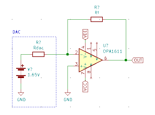

I'm currently in the process of choosing opamps to try in our I/V circuit for an ES9038Q2M in mono mode. My gut tells me that for most of the opamps that are on my list, noise will be of no concern, but let's see if I got my numbers right.
For the following calculations please see attached schematic.
So the noise contribution of the circuit shown are as follows:
- input voltage noise from the opamp
- input current noise from the opamp
- resistor noise
Regarding input voltage and current noise I assume that the noise gain of the I/V converter is 1 - ist that correct? otherwise my calculations will fall apart before they even began...
So let's add things up in an example - I'll use the OPA1611 as it's widely used for that purpose. Let's assume an I/V resistor of 500 ohms and the DAC has an output impedance of 774 ohms

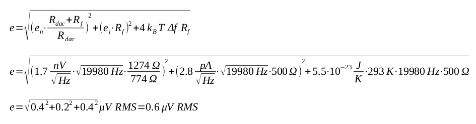

current noise:
The datasheet shows a input current noise density of 2.8pA/sqrt(Hz). That corresponds to 396pA RMS noise current in the range of 20Hz-20kHz. As far as I can see Rdac and Rf are parallel in this case (299ohms) and this will yield a RMS noise voltage of 0.12uV
voltage noise:
Voltage noise densitiy is given as 1.7nV/sqrt(Hz) which calculates to a RMS noise voltage of 0.24uV in the range of 20Hz to 20kHz
resistor noise:
According to Sengpiel's noise calculator a 500 ohms resistor has a RMS noise voltage of 0.4uV in the ususal audio frequency range
Adding these up (taking the square root of the sum of the squared components) gives me 0.48uV RMS noise contributed by the opamp and the resistor, resulting in a 138.4dB SNR for a 4V RMS reference level.
I'd be very thankful if somebody would take the time look over my calculations as I have no formal education in this field and every bit of wisdom used was extracted from the internets 🙂
IF all that is correct I deem the noise contribution of a modern opamp to be almost neglible compared to resistor noise and most likely noise from the DAC itself.

> assume that the noise gain of the I/V converter is 1 -.... assume an I/V resistor of 500 ohms and the DAC has an output impedance of 774 ohms....
It seems to me the noise voltage gain is 1274/774 or 1.6. Which is not an "arrgh!" difference, but worth noting. (See if anybody agrees with me.)
Thanks PRR! I concur, putting 1mV at either of the opamps inputs it must output 1.6mV to null that again due to the restitute divider formed by Rdac and Rf. So noise gain is 1.6.

If you want to refer everything to the output to compare it to a known output signal, then:
Op-amp voltage noise gets multiplied by Rf/Rdac + 1, like PRR wrote.
Op-amp current noise gets multiplied by Rf (or -Rf, depending on your sign convention, but that doesn't matter in this case). When you draw a little current source between the op-amp inputs, you see it just gets injected into the input of the current to voltage converter circuit, which has a gain -Rf.
Feedback resistor noise ends up 1:1 on the output. Draw a noise voltage source in series with the resistor and you'll see why.

One more question before I'll post a corrected version of my example calculation:
If the current noise is modeled as a current source between the opamp's input and we assume the noninverting opamp is held at a constant voltage by a low output impedance voltage source, then I see two paths for the current to flow: 1) through Rf and 2) also through Rdac. If so, the current would be split and only a part of it would flow through Rdac. Is this assumption wrong?
Yes. None of it flows through Rdac, because the op-amp input behaves as a virtual ground. That is, the feedback loop adjusts the output such that the input voltage remains constant, which results in none of the op-amp's input noise current flowing through Rdac and everything through Rf.

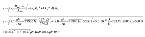

So, I hope I have this correct now:
attachment.php
As I need two I/V opamps for the positive and negative output of the DAC that will double the noise power which amounts to 0.85uV RMS.
Compared to a signal level of 4V RMS thats a SNR of 133.5dB.
A very amazing number I might add. Big thanks to all the silicon developers out there for providing such marvels of technology to us!

Because I just referred to this thread, one more note: The final SNR number was flawed because a 500 Ohms resistor together with the ES9038Q2M will only give you about 1.37V RMS. Thus the SNR of the I/V is down by 9.3dB resulting in 124.2dB
Hope I don't have an error in the calculation:
Iopp = 0.906 * 3.3V / 774Ohms = 3.86mA (per pos/neg DAC output pin)
Vopp = 3.86mA * 500Ohms = 1.93V (per pos/neg DAC output pin)
Vorms = 1.93V / 1.41 = 1.37V (between both outputs of the two I/V opamps)
