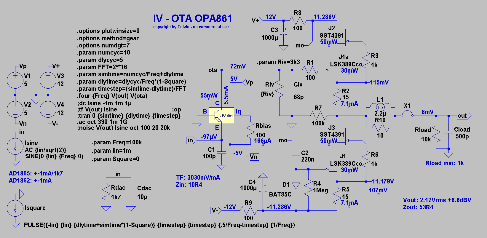

Regarding the attached I-V Converter schematic.
- C1 slightly limits the DAC´s current ´slewrate´ - optional
- Riv converts the DAC-signal current into a Voltage after: IxRiv
- Civ limits the bandwidth and provides for a clean pulse wo. overshoot (C min:68pF). I typically design Civ such that it sets the bandwidth limit to between 100-200kHz. For example: 3k3 and 270p ==> 188kHz
- Rbias is chosen 100R here, giving a bias of ~5.5mA (around 6.2mA after DS).
That should guarantee that the OPA861´s internal current mirrors run on more than 1mA idle current ... hence no paralleling of OPAs required.
In case of a too high output offset either the buffer may be trimmed or a dedicated output coupling cap may be used.

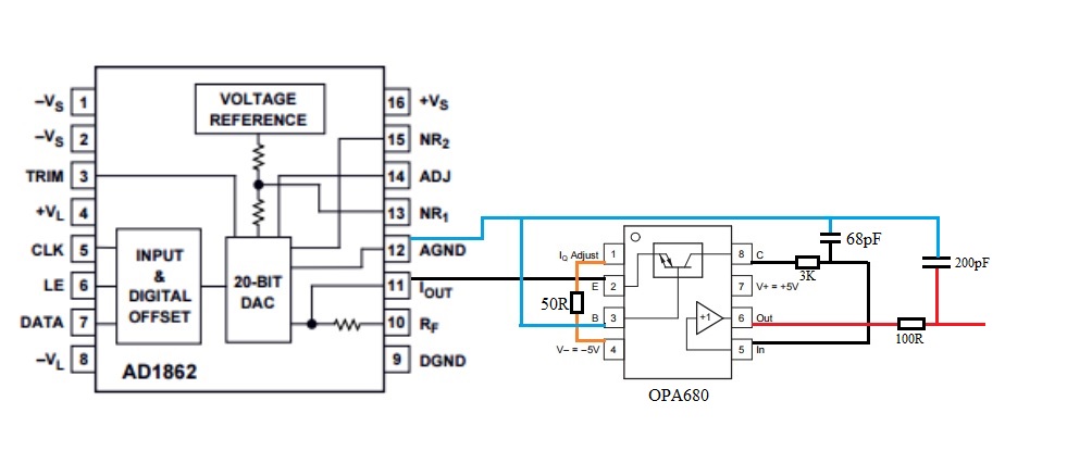

In case I'll use an OPA860 with it's buffer will the attached (very basic) circuit work?
no, the 3k should go from C to gnd .... parallel to the 68pF (see Riv||Civ in my schematic two posts earlier)
C also connects to the In-pin of the buffer.
Increase the 68pF to 270-330pF to reduce the bandwidth to practical values.
You may also reduce the 100R to 47R, though it doesn't make much dfference as long as the attached load is greater than a few kOhms.
Omit with the 200pF.
And don't forget to properly decouple the plus and minus supply pins with caps .
jauu
Calvin

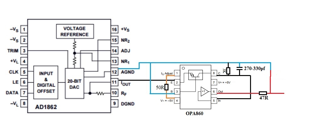

Dear Calvin, I know it's an old thread, unfortunately I didn't have the chance to try your suggestion yet.
What output voltage should I expect to get in the output of the OPA860 using the attached scheme?
it will be 0V, as the output of the buffer stage is shorted to agnd 😉
If You cut the red/blue link behind the 47R the output voltage will be the AD's output current times 3000, a small output offset voltage not accounted for.
IIrc the AD puts out up to +-1mA, which then gives +-3000mV peak-peak, or ~2.1Vrms (rem: depending on the load impedance the buffer output sees. The DS specs a factor of 0.98 for a load of 500R)
The 50R Iq-setting resistor I'd choose either 47R (same as the output resistor, for lower different parts number count) or 250r as TI suggests in the datasheet and which is sufficiently high for +-1mA current swing to keep the internal stages biased in class A.
It reduces the overall Iq ... not by much.... but anyway it reduces heat power losses a bit.
jauu
Calvin

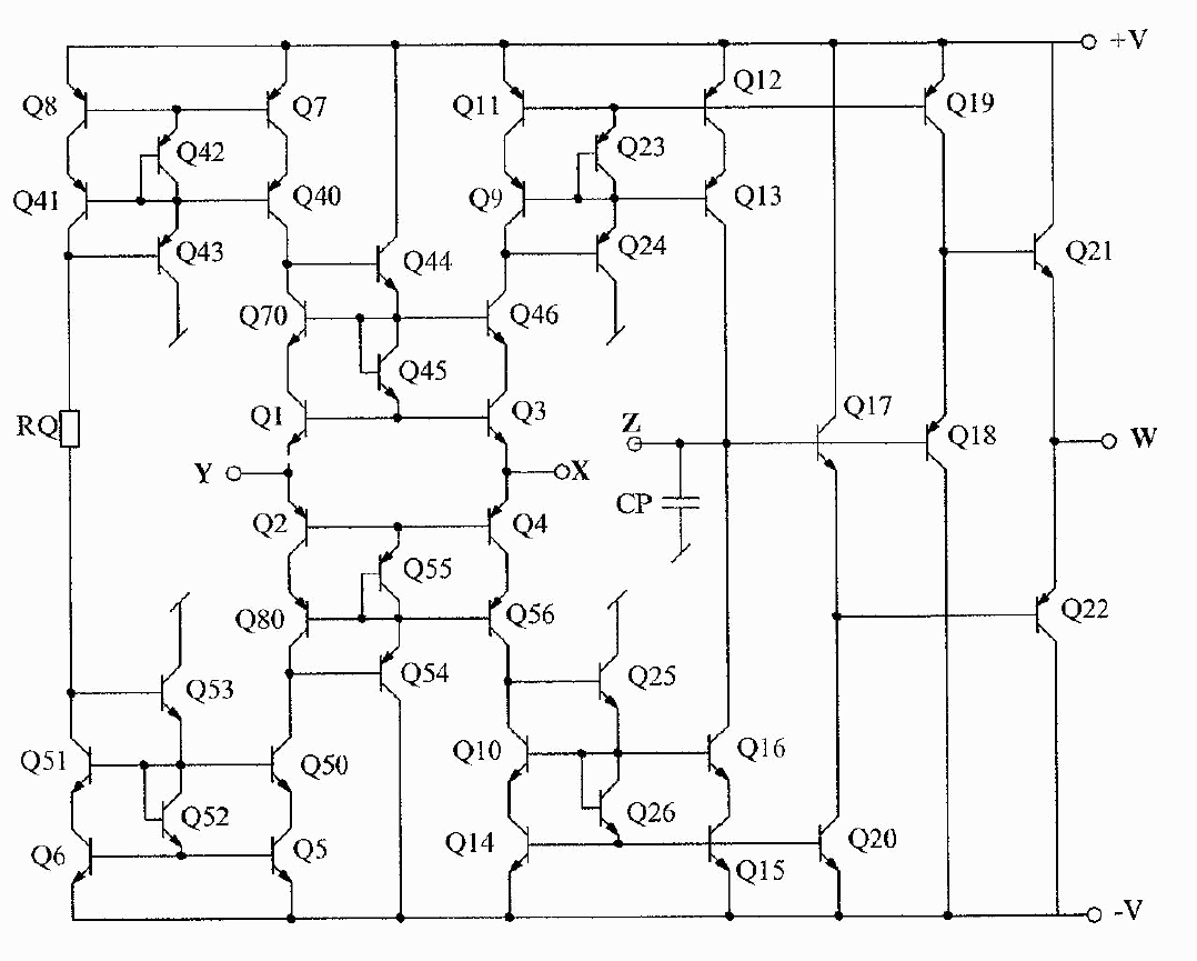

Now, if one looks at the schematic of the almost identical AD844 (attachment) we see that the Buffer consists of Q17 to Q20 and that there are four ´legs´ between which Iq divides.
For the AD844 the leg Q6-RQ-Q8 is biased at 150µA (fixed value, Rq= internal resistor).
And we can safely assume that the legs Q5-Q7, Q14-Q11 and Q15-Q12 run on the same Bias current value.
Those are the legs hat also carry/convey the DAC signal current.
Their Bias current must be greater than the peak signal current (>1mA in case of a AD1862 DAC).
